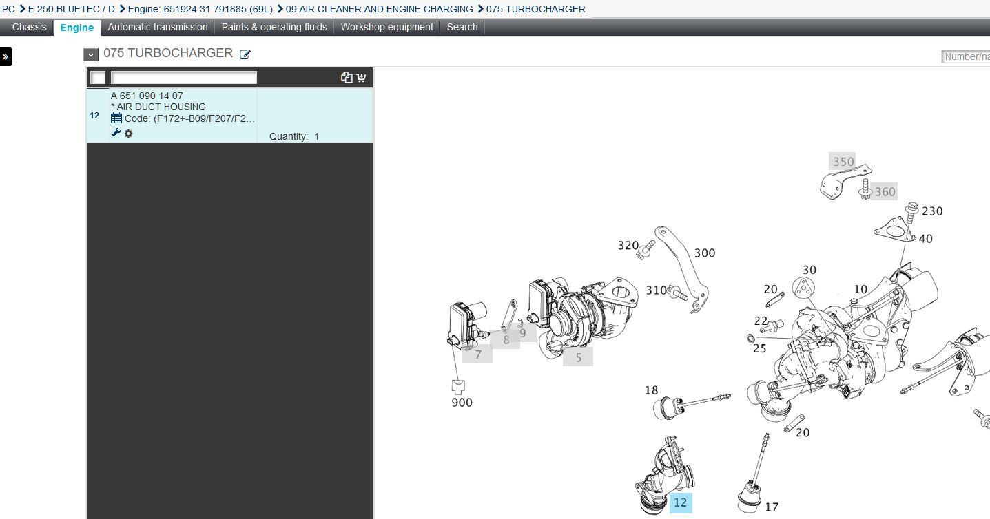

Some things to consider: Rattling noises from the front of the engine on the left, in the area of the turbocharger after cold start could be caused by vibration of aluminum bypass valve inside air duct housing, replace housing currently fitted with plastic valve (part # 6510901407 has not changed) and/or chain tensioner seal could negatively influence the pre-tensioning force this might lead to loosening of the tensioner, worst case oil leakage present.

I have the same rattle for a 10-15 sec after a cold start then it goes away. It comes from the front left area where turbochargers and all the related plumbing reside. The timing chain rattle has been ruled out.
Here are a few videos that show where the bypass valve is located and a possible fix. Not a fan of a teflon ring as it will eventually disintegrate but to each its own. New air duct housing with a bypass valve is anywhere from $400-800 depending on a dealership markup that day lol

See attached bulletin.

It's a pity that so late, the sound is the pressure valve at the turbine, I've had it for 2 years, you don't have to worry. You can do it and 100,000 miles, the only problem is the annoying sound.
