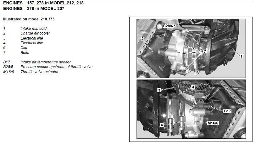

Having trouble location the MAP sensor on a 2013 e550 4 matic sedan, m278 engine. Anyone know exactly where it might be?

I'm having trouble finding it as well, I found images of the location for a M157 but nothing for the m278
File Type: pdf
