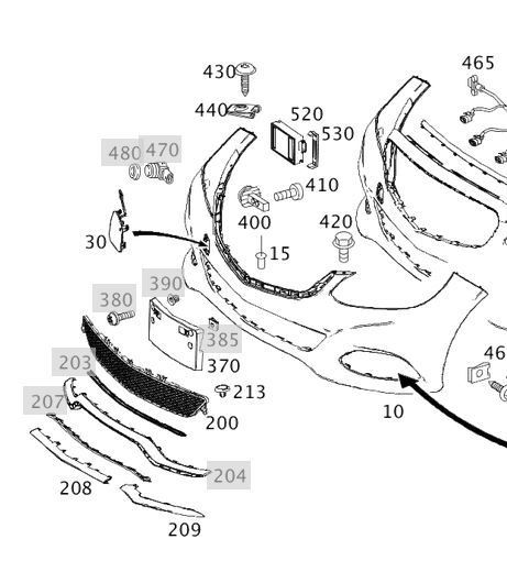

Lower chrome trim for AMG styling is split into three sections (208 & 209 in diagram) each section is removed by using wedge to manipulate bumper to release trim clips (as shown in post 3 above). If this diagram does not resemble your bumper post VIN.

The diagram looks perfect. #209 is correct. However I can't find a way to access that piece. Would I need to remove the bumper cover? Looking at it from below doesn't seem to help. I do appreciate the diagram.

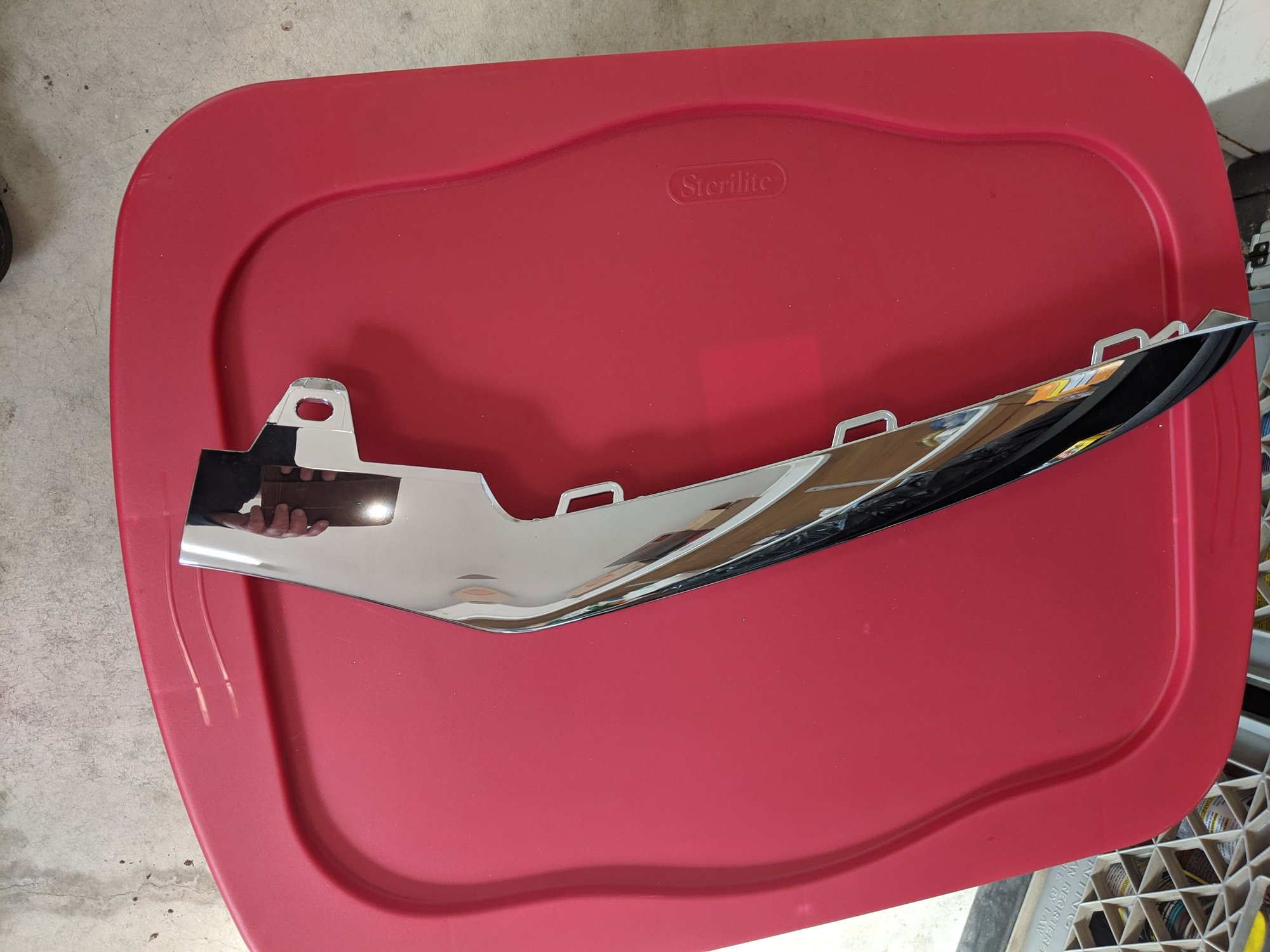

I once parked over a high parking block/brick. When I reversed out of the parking stall, by bumper caught the parking block/brick. I heard a lot sound coming from the front end, I thought I ripped my bumper off the front end. Anyway, I got out and discovered the chrome part #209 popped off and flew 3 feet away. Upon close inspection, nothing was broken off and it I discovered that the chrome part was only held in place by the tabs. It does slide into the middle section chrome, maybe an inch or so, before you can pop it back into the tabs. To remove, you manipulate the tabs to release/pop off the “eyes” of the chrome piece and you slide it away from the center piece.

Thanks all. I will get under and see if I release those tabs. I final got a picture to show what I have hopefully this the correct part.
