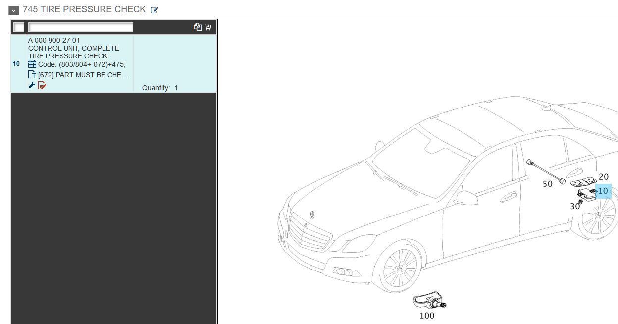

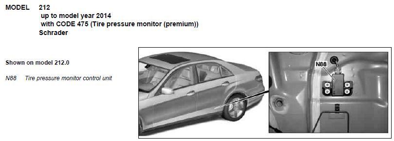

I was driving down the road a few days ago and all of a sudden my tire light started to flash and my dash read the tire pressure monitor inoperative. Now every time I turn the car on it says the same thing. I tried pulling the fuse and I still get the same message. I had my tire sensors checked and they are all sending a signal so its down to the tire pressure monitor control unit. I found a post that said that The tire pressure monitor control unit is located on the underfloor above the rear axle but I have spent hours tearing the rear end of the car apart and I can not find the unit. Does anyone know where it is and how I can get to it to replace it.

Revisit underneath above the rear left axle.

thank you for the advice, I got back under the car and finally found the part.
