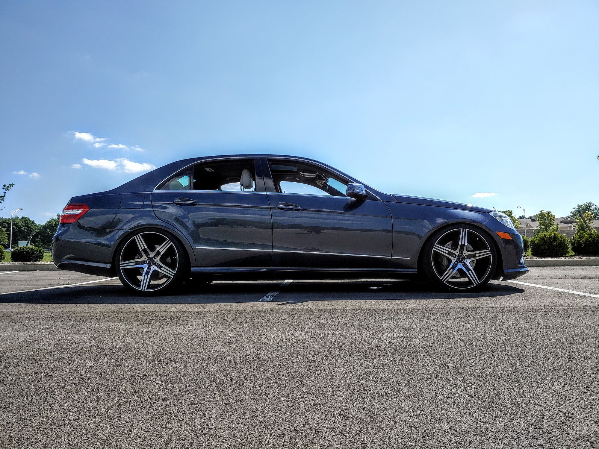

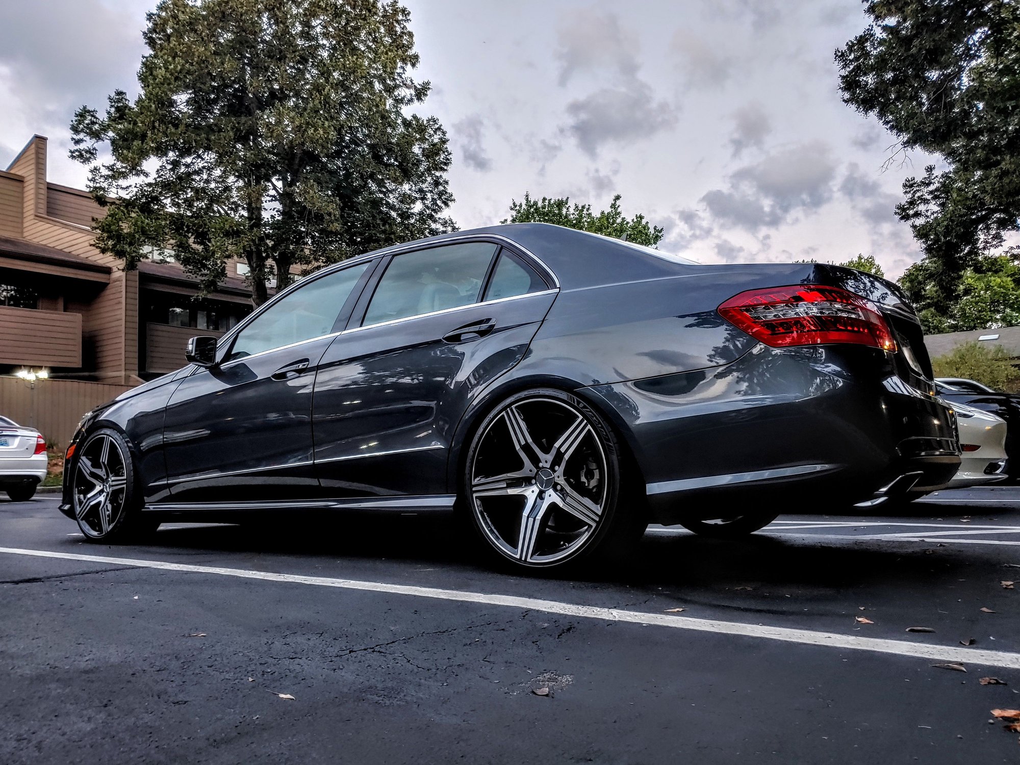

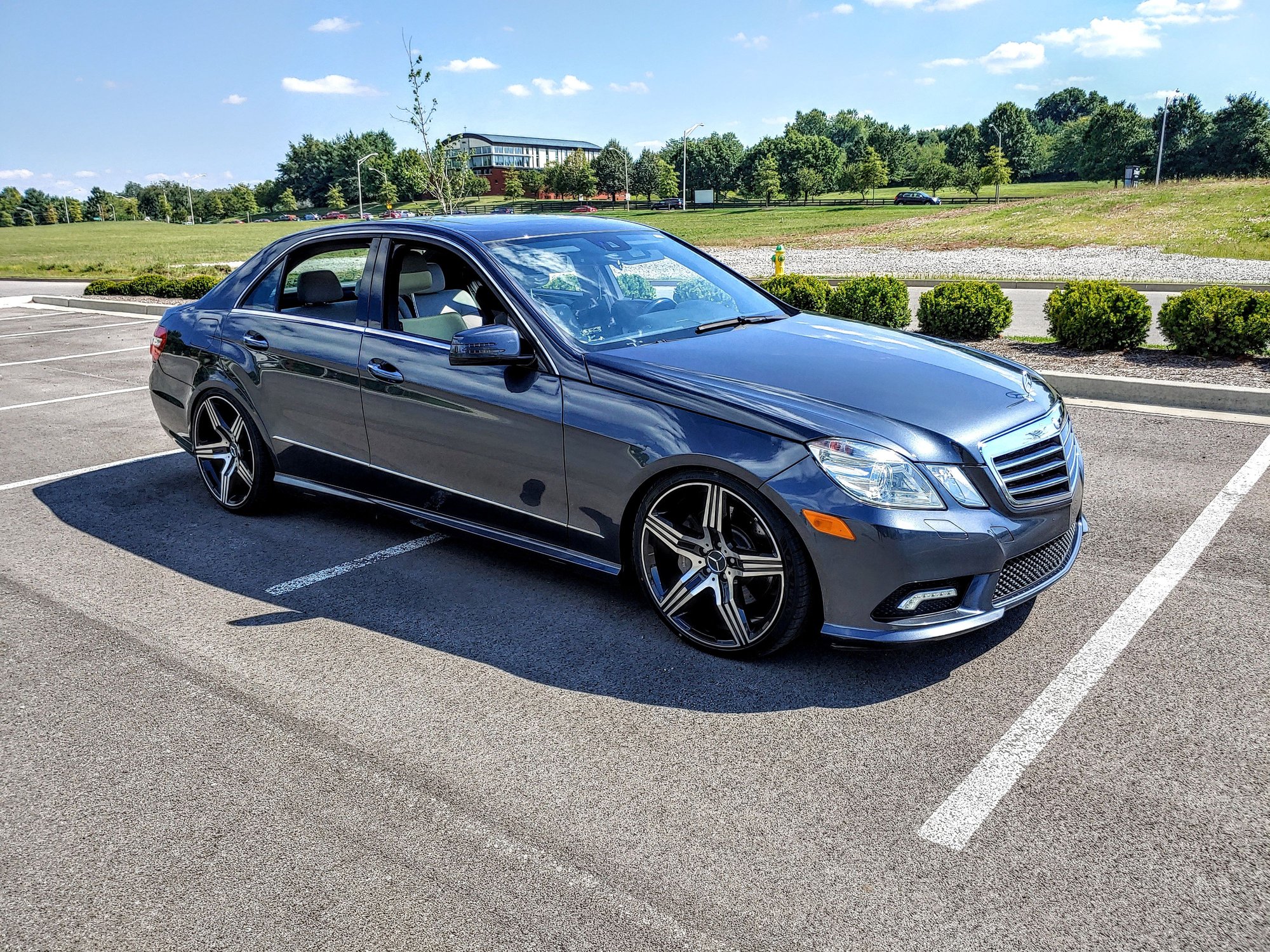

This new to me e550 got some new dubs
20x8.5s 35mm 235-35
20x9.5s 38mm 275-30
Used adj links on the ride height sensors
Even with them tucked on the lowest setting there is no rubbing at all, didn't even roll the fenders. Speedo reads 2mph slow
Pretty happy how it turned out. Been a nice daily driver so far
