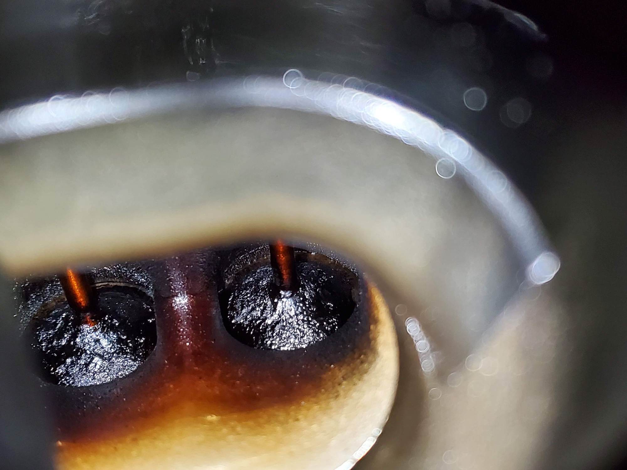

Originally Posted by LILBENZ230
Mercedes has managed carbon buildup really well with their DI engines, I would not concern myself with that.
Yea ok...here are the pics from 65k mile 2014 benz. No build up...lolol M272s have been around forever. What's the issue with them? The oldest 276 is what 7 years old at most? That's like brand new engine.

Old Aug 26, 2020 | 06:37 PM
  #40
cetialpha5's Avatar
Joined: Feb 2014
Posts: 6,189
Likes: 1,548
From: MA
2008 E350 4Matic, 2011 E350 4matic
Are you serious, there were lots of problems with the M272 when they first came out. Like the balance shaft. I think by 2010, most of the issues have been sorted out, things like sensors, oil cooler, centrifuge etc. But the main problem it still has is the intake manifold. That can be a 2k job at the dealer, but it's about $650 for the intake manifold plus labor to replace it. That probably happens in the 80k-140k range.
And 272 production numbers are small? 272 has been in all the same cars since mid 2000s to early 2010s, almost 10 year run. M276 has has much shorter run since switching to turbos in 2017.
You missed the point entirely. The M276's large production numbers did not somehow mean the M272 production was small. The M272 was a fine engine, but it had its own issues and at this point is old news. Hell, at this point we're basically at the sunset of the M276.
The valves you posted don't look great, no. But if the M276 were going to have widespread carbon related issues, 7 years is plenty of time for them to have surfaced. Our old N54-equipped BMW was experiencing the issue in the 40-50k mile range. That's not too say there won't be an isolated issue here or there, but it is not common. That was my point - at the number of M276s out there, if carbon was a crippling issue the way it was in BMW and Audi, it would be on every sub-forum on MBWorld.
I've owned both 272 and 276, and actually neither one ever caused me any issue whatsoever. That said, the M276 is the superior engine. At least equal, if not better, probable reliability while also having better drivability with more power and better fuel economy. Win/win.
