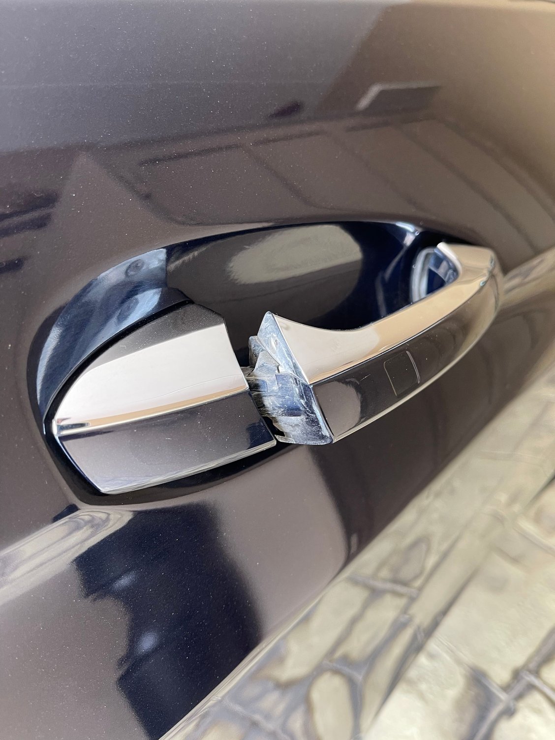

Anyways I have noticed that when I open the rear right door the handle doesn’t pop back in (pics attached), like it’s stuck or something. The door doesn’t close when the handle is popped out, and I have to manually push the handle back in. Anybody faced a similar issue? Or might know a fix that doesn’t include a trip to the dealer?

Does the door latch (closed) fully?

Get a can of silicone spray with a long attachment tube and spray inside all around the mechanism. That should free it up. If it broke, I don’t think it’s as difficult to replace as you may think.

CLA video, and 211 doc same process for 212.

Well I don't know your location, which makes it harder, but, here in the rust belt after driving in the salt for a few days between washes, my current and older Benz's did this on occasion, follow KEY08's advice, Lubricate, always works for me.

^yep. I forgot to add that this has also happened to me and lubricating it fixed the issue. The video is excellent if a repair is needed.

It doesnt when the handle is stuck, only latches when I push back the handle.
