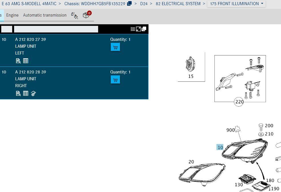

I have a 2015 e63s wagon. It's a Canadian car. My headlights fogged up and many of the functionality is not working after being in the snow. High beams blinkers etc. I noticed cracks at the bottom of the headlight that I must have missed before. I need to replace both full units. Looking to replace them but can't find any.
The part of the headlight says "Hella 906 33 03KZ and 34" on the other side.
Anyone know what part number I should be searching for? Here is my vin so you can see what options I have - WDDHH7GB5FB135229
I see full dynamic MB light with part number 212 820 27 39 but not sure why that's different part number than the ones on my car.
Any guidance would be great.

212-820-27-39 - This is the correct part number for the left headlamp
212-820-28-39 - This is the part number for the right headlamp
These are not made by Mercedes. They are produced by Hella, the OE supplier.
Be aware these also have control modules and if those got wet you may need to replace them as well which is additional. Also, they will require coding to the car they will not just plug/play.

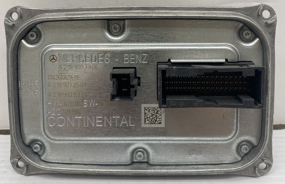

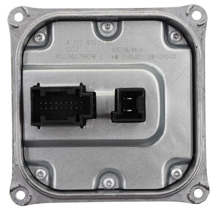

Do you know of a way of testing the control module and/or the headlamp assembly to know which is the problem? I get 5 errors on my dashboard when I start the car that say headlight blinkers etc not functioning
Also is there a part number for the control module? Is the ballast the same as the control module?

As suggested shop 2128202739 & 2128202839 eBay lists cost effective new HELLA equivalent & OEM used. There are two modules: voltage converter left & right current part # 2228700789 or 222870078980; light range adjuster 2189007306 or 218900730680 check for corrosion @ connections. Feeling ambitious, open modules to check inside.
