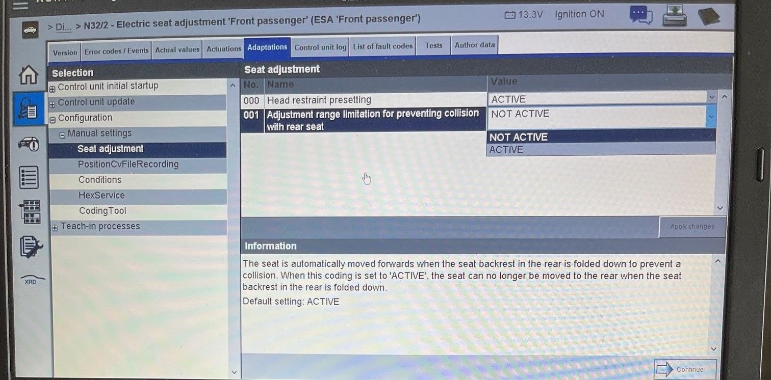

2011 E350 4M wagon, here's the Xentry screenshot to disable passenger range limit. Navigate: Electric seat adjustment 'Front passenger' (ESA 'Front passenger') > Adaptations > Configuration > Manual Settings > Seat Adjustment
For those interested the head restraint presetting, is the function which automatically sets the headrest height (presets) depending on fore/aft position of the seat. I find it annoying when vacuuming and detailing the car. With the seat raised up, moving the seat fore and aft will cause the headrest to hit the headliner. So I have to continually hold down the headrest button as well.
To Navigate to driver's side: Electric seat adjustment 'Driver' (ESA 'Driver') > Adaptations > Configuration > Manual Settings > Seat Adjustment

The dealer solved the issue. My invoice says they:
"Hooked up battery charger and SDS and went into the ESA 'front passenger' - electric seat adjustment 'front passenger' (N32/2) - adaptations - configuration - manual settings - seat adjustment and changed the coding to 'not active' to allow adjustment of the front seat while rear seat is folded down."
At first, they said they would charge me one hour of time to do this, but when I argued that I was having other scans and a navigation update done at the same time, they included it in the labor for those things.
The front seat works independently and rationally now, escaped from another example of MB over-engineering.

Below a screenshot from my xentry of the 2010 E550 that I have.
When I got the car it was a CPO and I asked the dealer to change this as it made impossible to sit on the front passenger seat when the back seat was folded and they did it. They also did the same for my 2011 E350 that I first had.
Very simple change in the settings that the dealers should do for everybody complaining about it.
Interestingly, there is no setting like this for the driver's seat while the collision risk with the folded rear seat is exactly the same as with the passenger seat. Guess they figured the whole folding rear seat option becomes useless if the driver cannot drive the car with the rear seat folded. At this point I must say someone at Mercedes is just an idiot thinking the way he/she did it.
Both front eats move forward when the seatbacks are released, and it should be enough to trust the driver and the passenger not to move front seats back too far with rear seats folded. This is how it is for the driver's seat from the factory so why not the same way for the passenger seat? Total lunacy!
I don't know how the Launch scanner you have shows the control pages but below is what xentry has.
