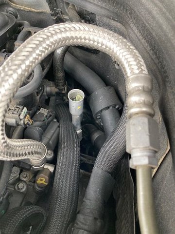

Can someone please tell me what this is?
2013 E350 Sedan. What is this tube? I can clearly see that whatever is it’s broken.

your oil dipstick tube.
That would be your engine oil dipstick.
Looks like the plastic top broke off.
You'll want to order a new one,.. then use needle-nose pliers to try to get what's left of it out.

might have a shopvac fired up right next to it as you fish it out incase there's plastic bits in there, yo uwant to suck them up rather than half them fall into your oil panl

i'd use a drill bit and EZ out to (carefully!) Ease the remaining plastic out. Hopefully there's still a dipstick attached.

It probably broke last time oil was changed. The mechanic broke it either pulling it out or pushing it back in.
I broke mine on my 2013 S550 a couple months ago when checking oil while filling up. Mine broke half way down the stem so I was able to easily pull it out with needle-nose pliers but the OP’s top broke right down to the O-ring seal. Half of the seal is visible in the picture.
I would use a very fine hook tool to pull it up from under the half-moon plastic that is left of it.

PLastic gets hard and brittle from the heat cycles.

Well, I can tell you that when mine broke I did not bend or twist it in any abnormal manner. It broke when I pushed it in and it is difficult to do without any side force at all but it broke with very small amount of force. I do believe the plastic gets brittle over time especially under hood in climate with close to 100 degrees daily in summer time.

The metal part reaches almost in the bottom of the pan so even if it broke below seal it would not drop very deep in the tube.
Now, I’m talking about the S550 dip stick. That has an eye on the top like my E550 has. Pictures in earlier posts show a different design.

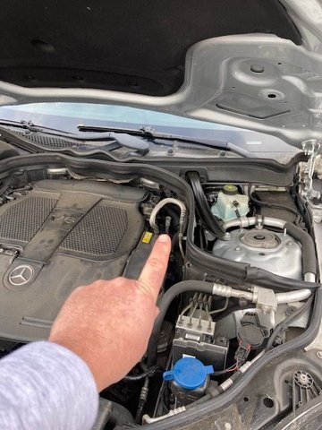

Both our '11 E350 4M and E550 4M have the above green "button" head dipstick... on older models the red "eye" dipstick was common:
This is the design I have. In my S it is blue though.
It broke right where that small hole in the plastic is. That is how far the steel “cable” runs to so it will not break below that point.
