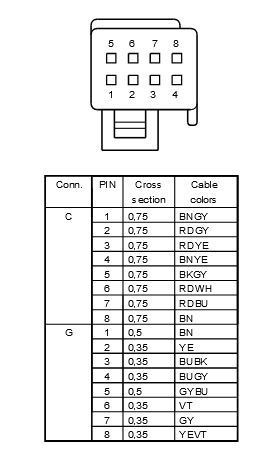

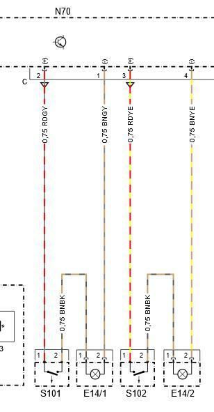

Check if switch 2 is turned off. Possible but doubt both switches/lamps failed at the same time. Visor lamps (e14/1 & 2) originate from overhead control panel (n70) check pins (2,1,3,4) @ connector C. If all looks fine OCP may have internal malfunction.
