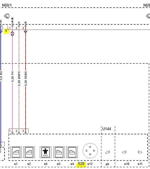

Below probably is very similar, C class

You can try pulling f2 (30A) @ front SAM (engine compartment) to attempt door CU reset. If you need to inspect wiring:
