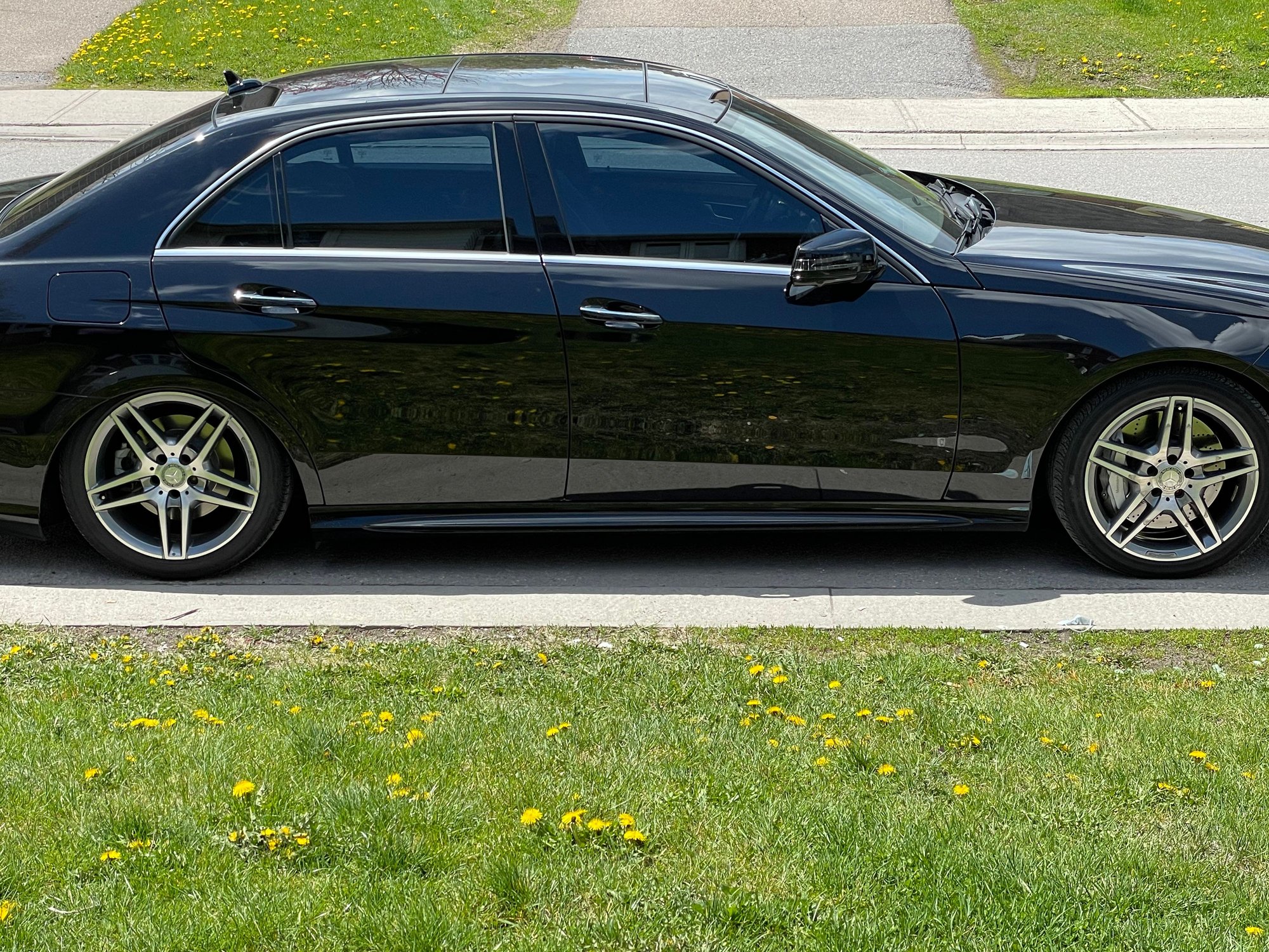

Before you get all riled up... the invoice with the parts breakdown only lists the compressor, valve body and some ancillary bits. First, the compressor is not shown in your photos, it's behind the black plastic cover next to the driver's side muffler (follow the larger diameter tube from the valve body). Second, that valve body might have been replaced. How much have you driven the car since the dealer worked on it?
As far as the shocks... in the notes it states removed and replaced. There's speculation around that, but its not fixing your issue. Anyway, doesn't really matter what they did or didn't... either they fix it or they don't. If you want to tackle this yourself... then proceed as advised.

It was Sunday couldn’t call but I filled up a survey yesterday that they sent me after my the visit(been lurking around here before getting the car so knew better than to leave a review on airmatic work right away); long story short I left 1/10 feedback, explained why and added a link to this thread.
No one called so around 1pm I call explain, transfer to manager on the spot who acknowledges that he saw the review and admit right away that it wasn’t changed something about it was never actually ordered/billed so I mention the fact that somebody highlighted it in green at this point he ask me what I want ...
Has me drop the car off right away and said he will make it right + shows me what was replaced to avoid misunderstandings.
While the car is in the air I am shown that the air compressor and filter was changed + valve body.
Then I can’t believe someone tried to tell me it is normal due to age to sit low, it’s not broken it’s aging! no sir you sold me a car with the most common issue can’t deny it as it was winter when I got it so probably low every day sitting at mb Benz . Thanks You guys prepared me for that meeting so I stood my ground.
To conclude I have the option to go Arnott or OEM springs I believe A-2790 and A-2791 are the arnott code for my car? More importantly they can’t give me warranty on that, they can only give me warranty on OEM.
Maybe this is the only scenario you would want to stick with OEM? Warranty is great with airmatic I believe; anyone shine in please.
Shocks will still be OEM. All at almost no cost. And they will look at a warranty at a “good deal” for even though I didn’t get one right away might be worth it apparently my roof is 8000$ if it breaks 🙈
Also I was surprised to hear that the system will still use the reservoir with Arnott in the rear! Are they correct? as I think someone mentioned not needing the reservoir with Arnotts. I want this done right the first time. Thanks
Also what else should I pay attention to NOW
This morning, barely went to zero C last night

Little confusing. Is the dealer doing this for no cost to you? If they are, why ponder which air springs to use?
Yeah I had to read it twice myself...
I was given they impression that Arnotts are better! Basically I should go OEM considering the warranty. Thanks
