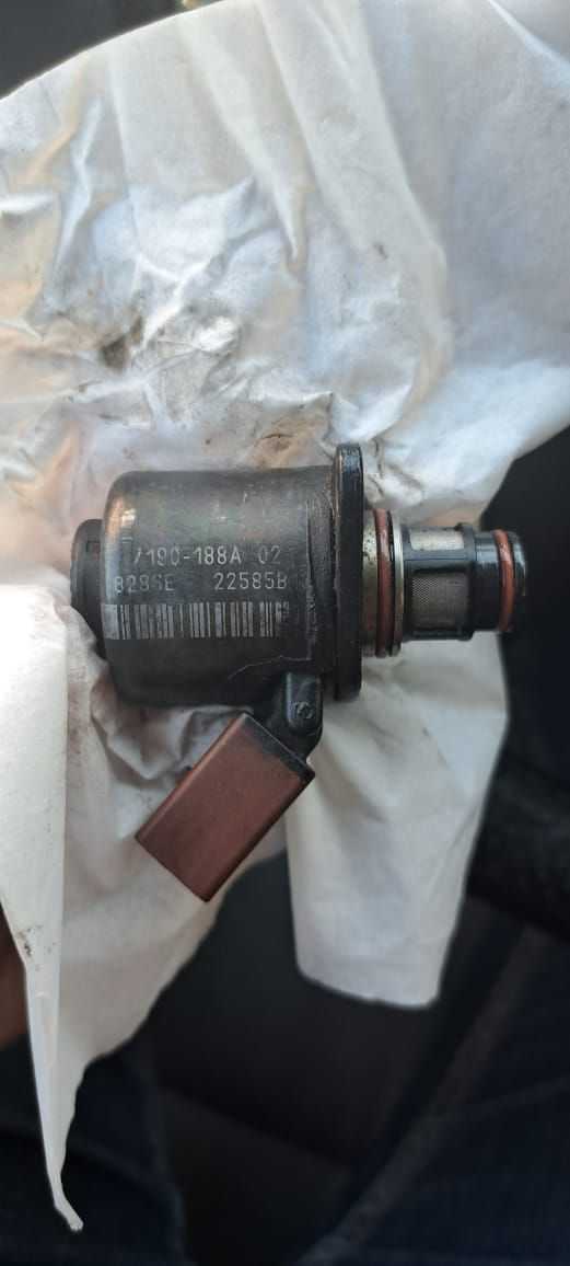

I encountered a similar issue and wanted to offer some advice without you having to spend unnecessarily. Consider checking the following:
1. Your fuel filter may need replacement.
2. Consider replacing the Z530A fuel control valve.
