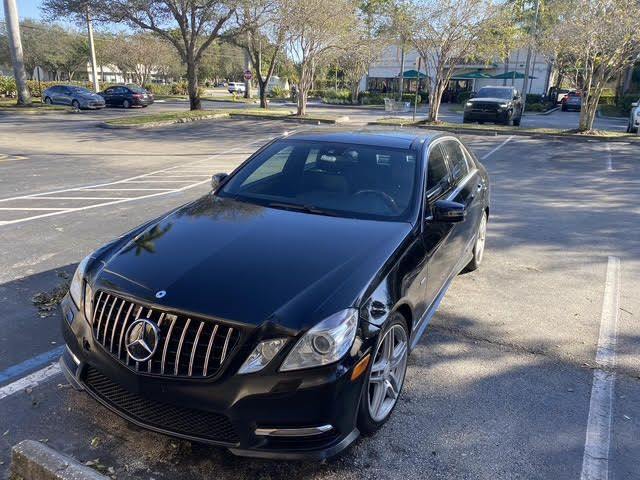

Old Mar 20, 2026 | 06:10 PM
  #40
celyl888's Avatar
Joined: Apr 2018
Posts: 33
From: NewEngland, SouthFlorida
E350,GLK350,Ducati
I purchased a clean 2012 E350 W212 sport base (no 4matic, no air suspension) with 215555 miles on her for $2650. Senior owner says he drove back and forth from Pennsylvania to Fort Lauderdale. Minor body stuff missing like headlamp washer covers, tow hook cover, broken tail light lens, plenty of stone chips. Clean interior, feeble attempt cover up stone chips, new serpentine belt, nice bottom seat covers. Says it well well maintained. They all say that. Anyhow, it has an intermittent coolant leak coming from hose, I purchased O-ring, updated grill, new tires, wheel, alignment, new taillight, had the spare refurbished.
I am a retired Florida snowbird, this car is parked in 2 car garage, only used for 5-6 months for shopping runs. Fingers crossed, hope it last a couple of years. Hmm should I start a new thread?
