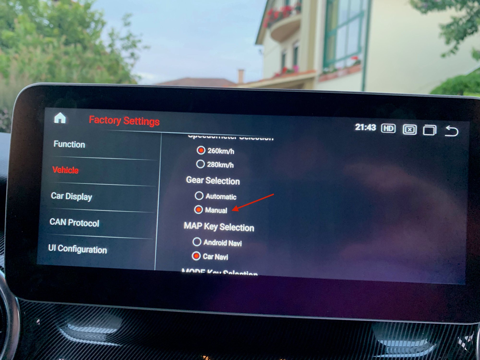

Hi,
I know that it is not logical, but if your car is automatic, in the factory settings you have to select manual transmission, if not, it does not work. At least that's what happened to me in my V-Class W447.
Antonio González
2016 MB V220 (W447)
Old Jul 31, 2021 | 06:45 PM
Andres28's Avatar
Joined: Aug 2012
Posts: 18
2010 MB E350
Thanks!!
