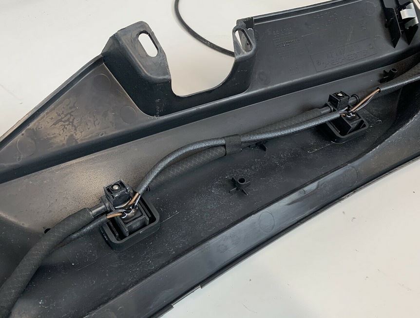

I'm pulling mine off to do another job soon, so I grabbed a new one to replace WIIT and before it becomes a problem. This is a part of the car I don't really want to have to "unfurl" more than once...
