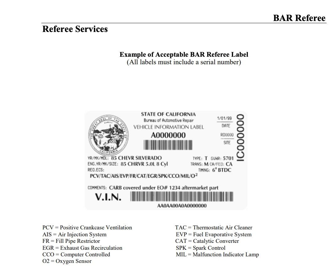

I see you are in California which complicated things. Two main hurdles to clear: A. make sure it is imported legally; and B. make sure it can pass California emission and inspection
First, if the car is already in the US, it probably means someone had already imported it legally. If the car is in Canada, you can forget it. You need a letter from MB Canada to say the car conforms to US FMVSS and they won't issue that letter unless you are the original owner.
Second, assuming the car is already in the US, it would still be wise to ask for verification that is has the US FMVSS conformation letter. Do not buy a Canadian car without getting a copy of that letter. It implies the car is not legally imported, even if it has a state issued title.
Third, ask for a photo of the emission sticker under the hood. It should look something like this:
Mercedes only sells 50 state legal cars in the US so any recent US spec Mercedes always has both US EPA and California emission (CARB) code. I don't know what the emission sticker looks like for Mercedes sold in Canada but if it doesn't have the California code, you can't register it in California without going to a emission referee and getting a BAR sticker.
California laws allowed original US spec non-CARB car to register after 7,500 miles - these cars just need to meet EPA emission. Very few of these cars exist now days because almost all car companies now sell CARB cars in all 50 states because majority of the new cars are now sold in State that follows CARB emission rather than EPA emission. A Canadian Mercedes is not an original US spec car even if it conforms to US FMVSS. So it is treated a gray-market import. Under CARB rules, imported cars will need to meet CARB emission (not just US EPA emission) so if you do not have CA emission on the sticker, you have to go thru the referee process to get what is called a BAR sticker. They look like this:
Getting a BAR sticker can be a time consuming and expensive process. It involves visual inspection to make sure all OEM emission equipment is still attached.
Read more about it here: https://www.bar.ca.gov/pdf/Smog_Chec...ence_Guide.pdf
And here: https://www.dmv.ca.gov/portal/vehicl...orted-vehicle/
If the car has FMVSS conformation letter from MB Canada, and CARB emission on the emission sticker, you are probably going to be fine. If it is mission either or both, it is not worth your time or trouble. Just move on to the next car.
