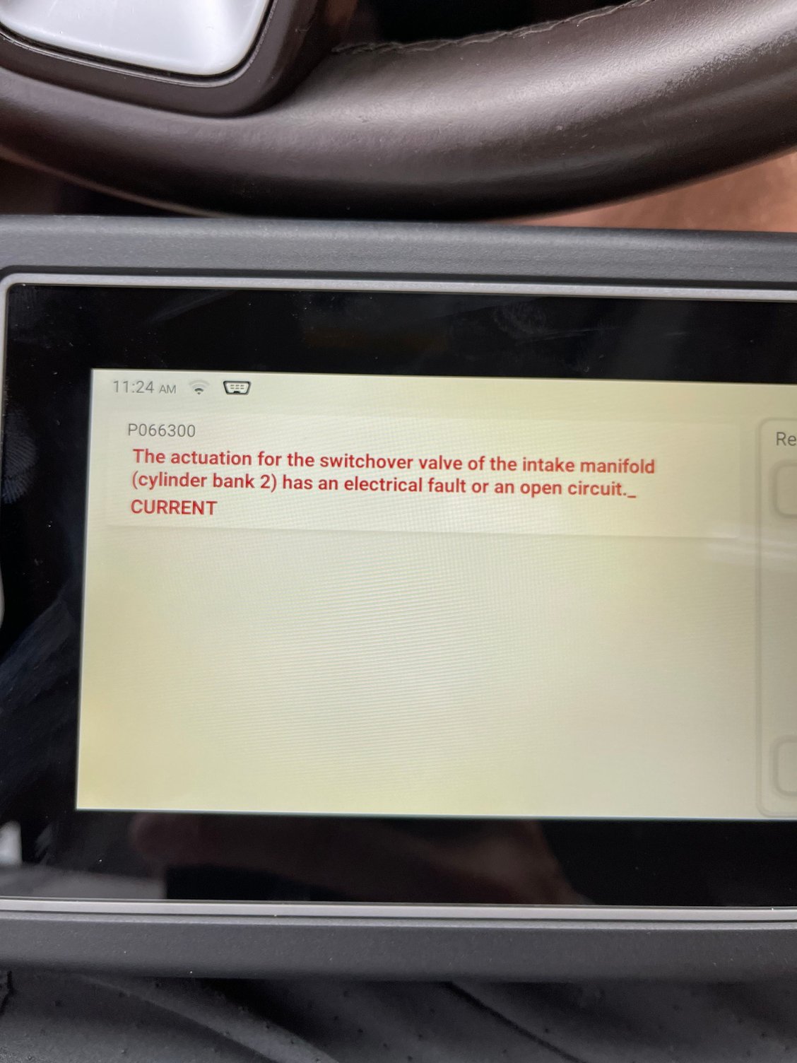

Hey guys,
I decided to run a health report on the E class today just out of curiosity, andone of the codes that popped up is this “electrical fault or open circuit” for the switchover valve actuation. Does anyone know what this could be or have any experience with this code?
I do not have any lights on the dash, and the car seems to be running normal. I do want to try to figure this one out though. Any help would be appreciated, thanks!

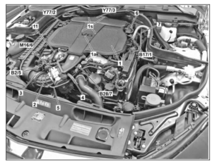

One of the two at the bottom (left and right of red arrow):
Old Sep 7, 2021 | 04:16 PM
bmwpowere36m3's Avatar
Joined: Jun 2020
Posts: 1,363
Likes: 1,012
'11 E350, '11 E550, '98 M3, '95 E320
On second look, you have a 2014... so totally different engine, I apologize. What your looking for is, Y77/2 or Y77/3.
Attached Thumbnails Switchover valve?-screen-shot-2021-09-07-4.14.31-pm.png   Switchover valve?-screen-shot-2021-09-07-4.15.39-pm.png

Did you solve this issue? I have exactly the same problem on my 2014 E350. Runs fine and no check engine light. Is it a leave well enough alone situation?
