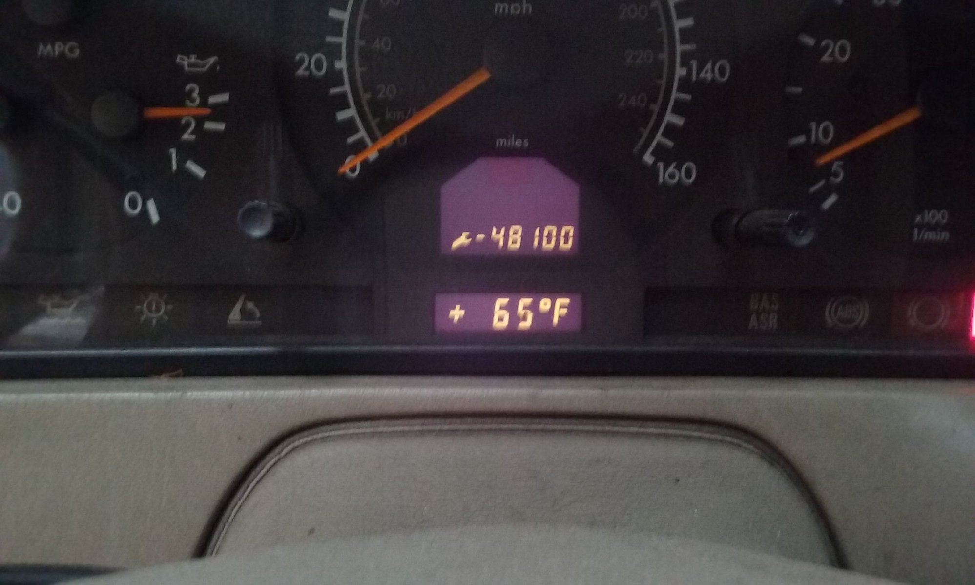

This is 1998 SL500 when I bought it.
It was serviced, but young owner did not know how to reset it and did not learn how to use scanners.
When transmission went into limp, I bought car for peanuts, when the repair took $10 pilot bushing and some ATF.
