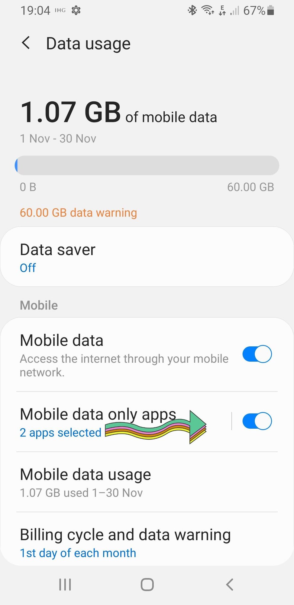

I've had one of these for a while but always have trouble with maps , waze or Google being off line and not being able to get the Amazon music to work unless I start it before getting in the car .
It always shows as wi-fi connected but with no Internet.
I have just found that if I turn on a setting on my phone to always use phone data when connected to WiFi it works . See picture .
Is this normal or is it just that my phone is a bit old ? Samsung S9
I appreciate any information.
