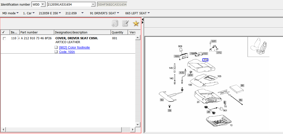

Front Seat Cushion Part Numbers
Does any one know that if the front seat cushion cover parts are the same for both left and right side? Researching, I found that the correct part number to be 212-910-73-46-8P26 but not sure if it applicable to both front seat cover. Mine is Almond Beige (8P26) and both of them are ripping @60k miles on 2012 E350. VIN is WDDHF5KB2CA531654

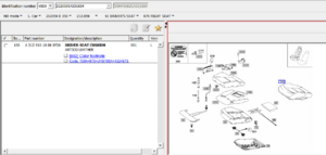

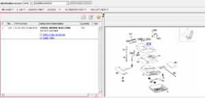

Here you go:
Unfortunately, I believe the passenger side is sold as a unit (frame, cushion, heat element, weight sensing and cover). Whereas the driver's you can get just the cover. I can't recall, but vaguely remember that this applies to both MB-Tex and leather fitted cars...
