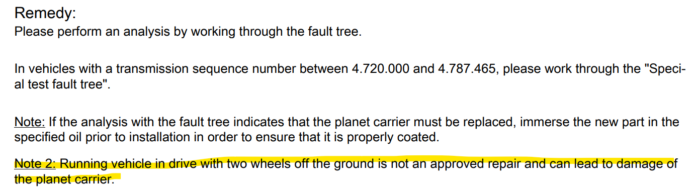

Originally Posted by trshot
Problem solved thanks to this forum! The car is smooth as silk again.
I see this method listed a lot, but the service bulletin literally states do not do this...
https://www.tsbsearch.com/Mercedes-B...28-00-P-051499
