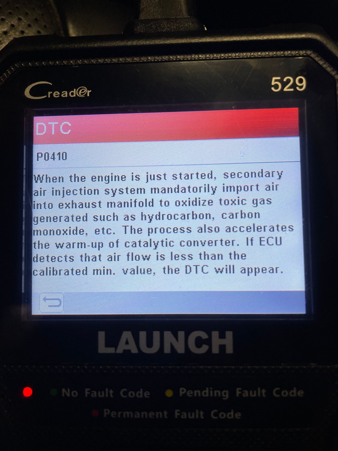

"Code P0410 is the result of the Engine Control Module (ECM) indicating a malfunctioning Secondary Air Injection System. This happens when the O2 sensor does not accurately detect the changes in the O2 level of the exhaust while the air injection system is functioning."
I brought the car to the dealer and they told me to replace my air pump and coolant pump to fix the problem. I replaced both with OEM but the engine light still appears to show up with the same code.

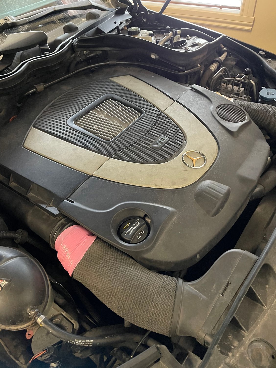

There is tape on my two air tubes right now which cracked so im awaiting the tubes to come in from mercedes.
