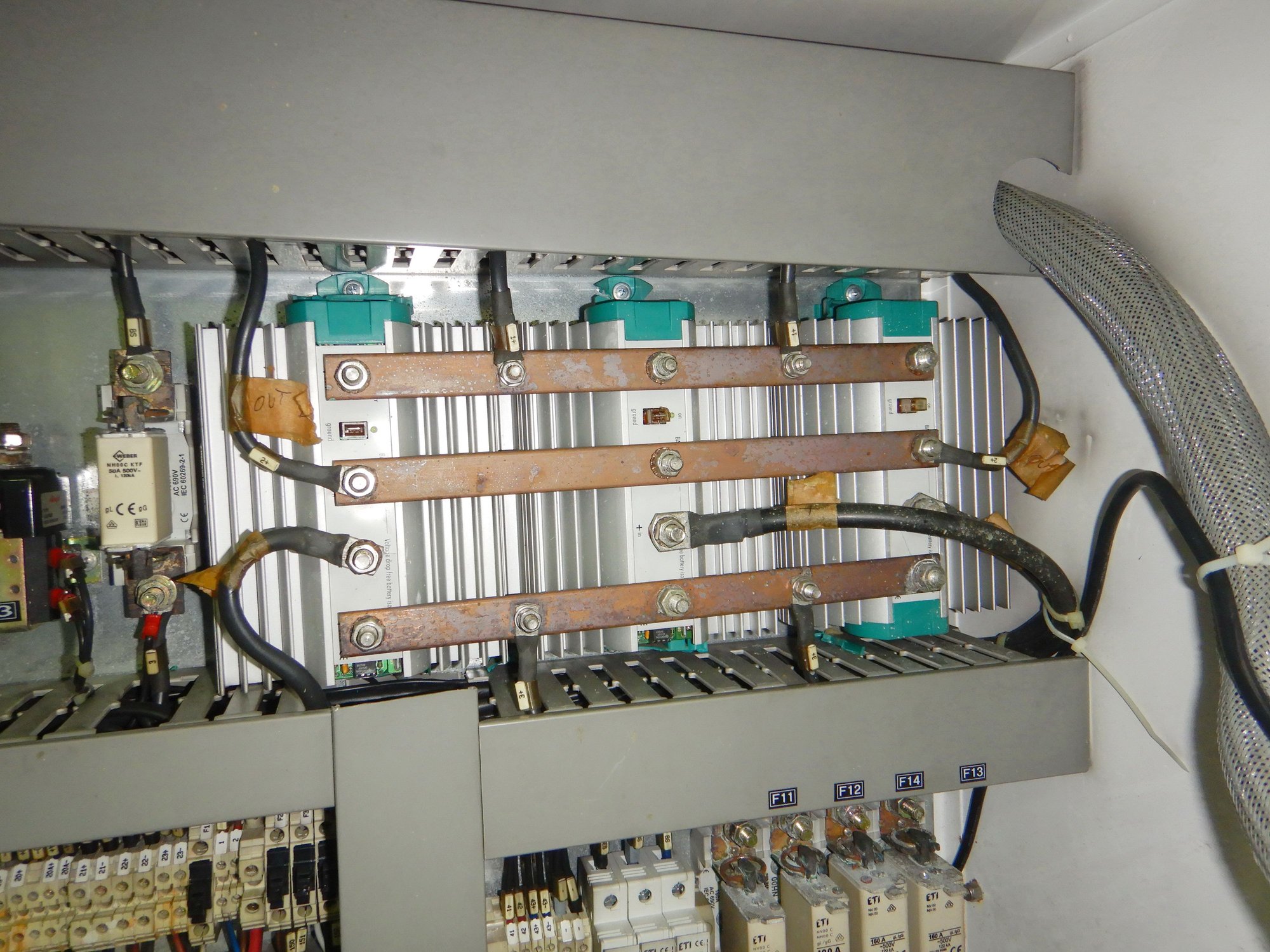

There is another funny one, a 112 footer Italian of a high level brand.
I was on board doing a simple visual check and also dove down to see the minor damaged propeller which hit a bamboo. So after the propeller dive, I went to the engine room to see its 24V DC system.
This yacht has lots of battery banks and is served by a 1-input 3-output electronic charge splitter for every charging source it has.
So there are 3 of this charge splitters, for 2 engine battery banks and 1 Electronic battery bank of the king kong MTU 4000 series engines.
2 alternator + 1 battery charger as charging sources. So each of these sources can charge all 3 banks while each banks are being isolated one from the other.
As-is 2nd Aug 2019. I told the co-owner who is a friend, I said the installation of the 3 charge splitters are not so correct.

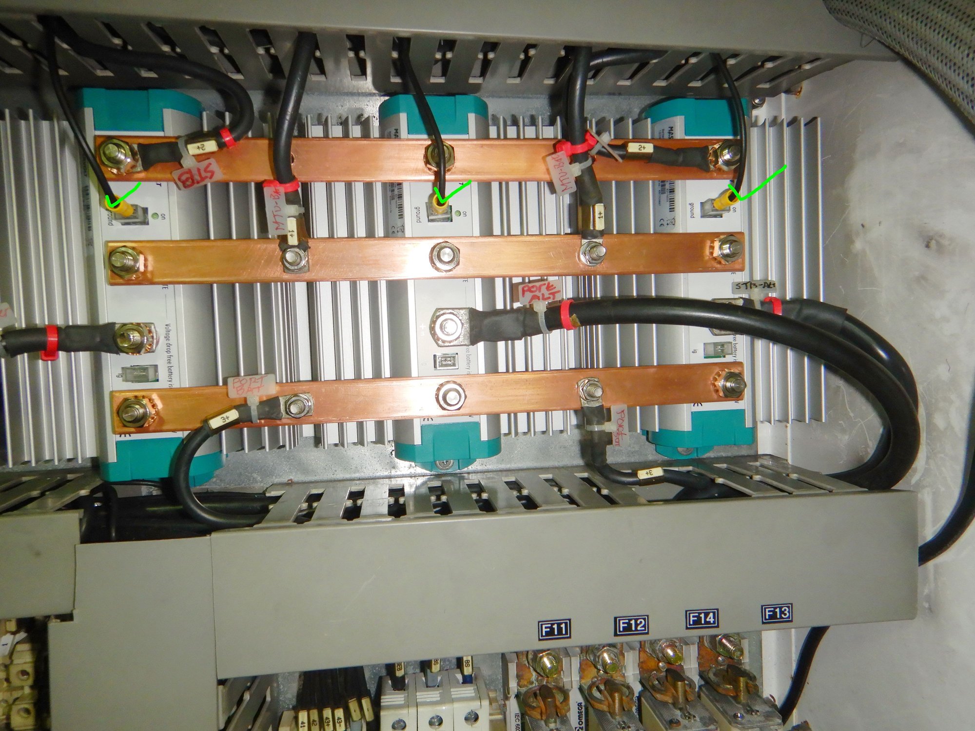

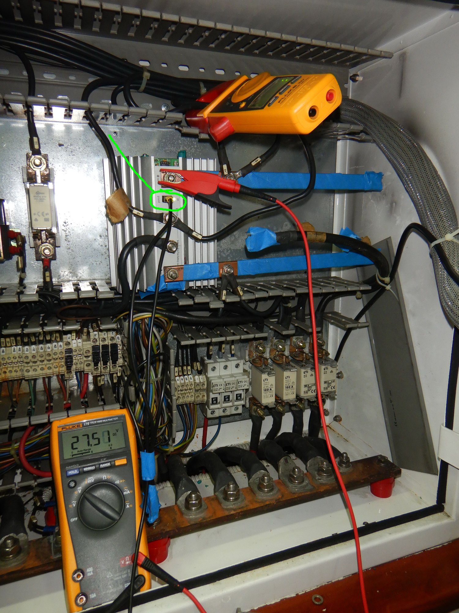

27th August 2019 , I came back to the yacht to prove that the charge splitter is not working as well as it should.
See below, I connected an operational ground on the surviving 1 last unit during the test to confirm each and every's unit state of health.
2 Issues found. 2 units are dead at 1 or 2 of its 3 channels. And all 3 units were missing the operational ground wire ... LOL. This is a 2006 yacht.

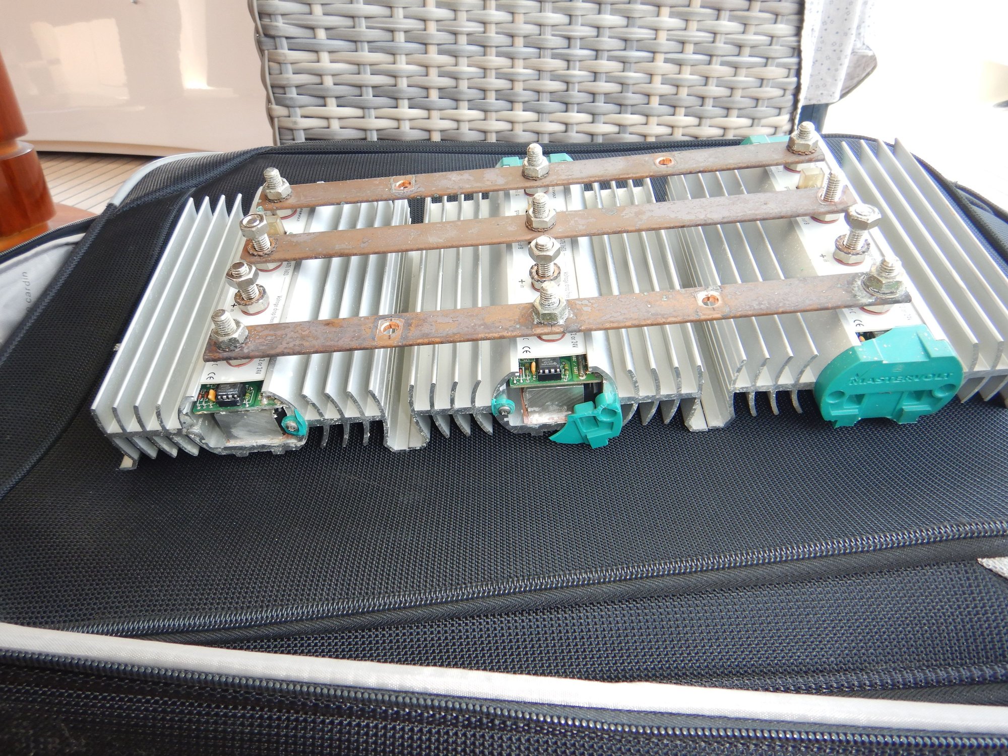

I know why this missing operational ground wire is happening. The older version of charge splitters are dumb ones, no electronics , only high power diodes.
I am sure the worker in the ship builder are long time staff ( many are ) and quite old ( many are ) and they never assumed the newer charge splitters are electronic based one and only like 0.1volt drop, if installed correctly.
See below : Old technology. Simple DIODE ONLY with ,commonly 0.6Volt. drop.
Newer ones need operational ground cable, some other brand may even need Ignition +12/24V command to work.
Special order these charge splitters from Singapore and I re-install them by 11th Oct 2019 and I cleaned the whole freaking electric panel. I labeled all wires too.
Bad luck has it that of the 3 new ones, 1 has a leaky diode on channel A (top side output)...damn !!! So 1 old one plus 2 new ones all installed. The most right side one is the leaky one.
Leak can cause other battery banks to be NOT isolated, so no go...remove it from service.
So 1 old one re-installed. Old one has cracked plastic ends, so I blue tape them to prevent debris from entering.
Well, these SMART charge splitters will work as dumb DIODE only when the electronics are not working. Voltage drop 0.6V there about.
If the electronics are okey and running, I measured a respectable 0.1V drop and that matters a great deal to the overall state of charge for the battery banks and longevity of use.

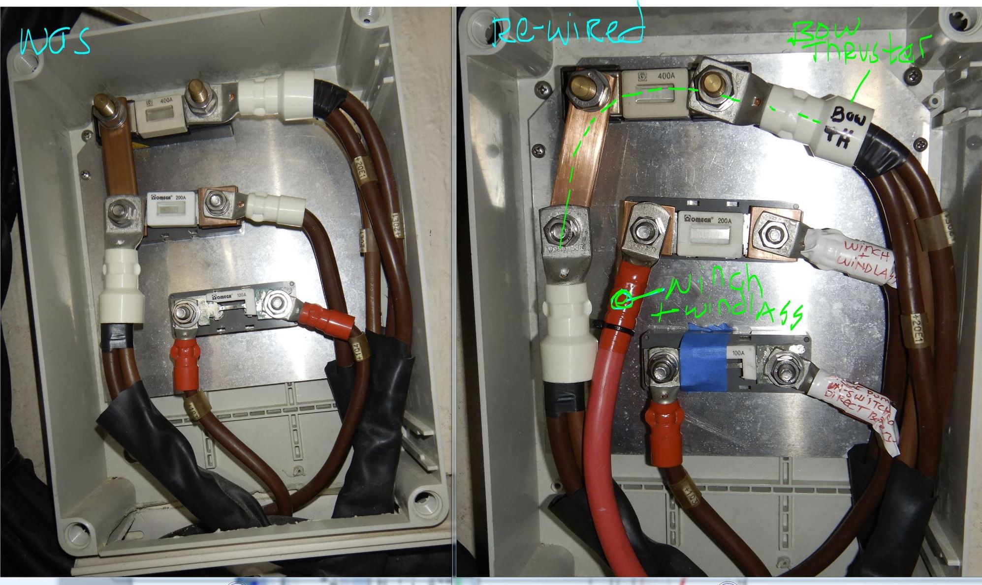

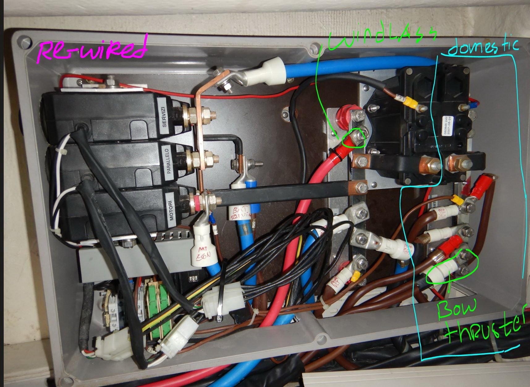

Another crazy *** Italian builder, famous one. 59 footer of year 2009.
A 10 kw electrical bow thruster wired from the Engine Start battery banks. This means all the MAN V8 900HP engine computers will get the bow thruster spike and noise.
I seen the electronic gear and throttle of yachts went banana from low voltage and hit another yacht as a result while manuvering in the marina, let alone low voltage and noise.
24V system. Inrush test and Running test of the Bow Thruster.
I re-wired the bow thruster to use the DOMESTIC battery bank. Not as easy as I thought it would be due to cable sizes and bus bar limited box size, but do able.
I can't re-wire the anchor WINDLASS to use DOMESTIC bank ( I would love too ) as the WINDLASS CONTROL Module at the Captain lower and upper helm is already using engine's ignition feed ( engine's Bat Bank ) and I don't want to tear apart
the side wall towards living room >>> kitchen >>> lower helm to get to those control wires.
