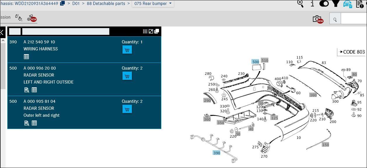

Since I bought it, my car's active blind spot assist system has been inoperative. Recently I decided to check it and try to fix it. It appeared that both radar units in the rear bumper are broken (from the driver's side it is absent at all, and the connector covered by plastic from water, from the passenger - unit is destroyed by water and dust), so I ordered two used units, they should be In a working condition according to the seller.

Check harness also, sensors 'may' need commissioning see attachment.

IIRC the sensors have to be the same version, and manufacturing date as the old ones to work plug and play (not guaranteed). Otherwise as Konigstiger said they need to be mated to the car.
