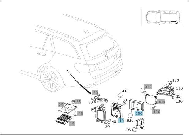

Got the dreaded "device unavailable" message on my Comand screen and the subsequent speaker volume loss. Prior to the message, I was having intermittent problems with the Sirius sat radio with it losing signal and requiring it shortly thereafter. I did some research and the two main culprits seem to be the Sirius satellite receiver and/or the amplifier. I need assistance in locating the Sirius sat. receiver in my vehicle and also where to purchase a reliable fiber optic loop to perform the testing. Some question are...If after performing the diagnostics and the satellite receiver or the amplifier are the problem will they need coding via Xentry or are they plug and play? Another question is if the satellite receiver is the culprit will I need to contact Sirius to reestablish satellite service because the radio id has changed or is that specific to the head unit. Thanks for the help.

May want to explore Telematics software before replacing any parts see attached bulletin. FYI amplifier & SDAR receiver located behind left cargo panel.
