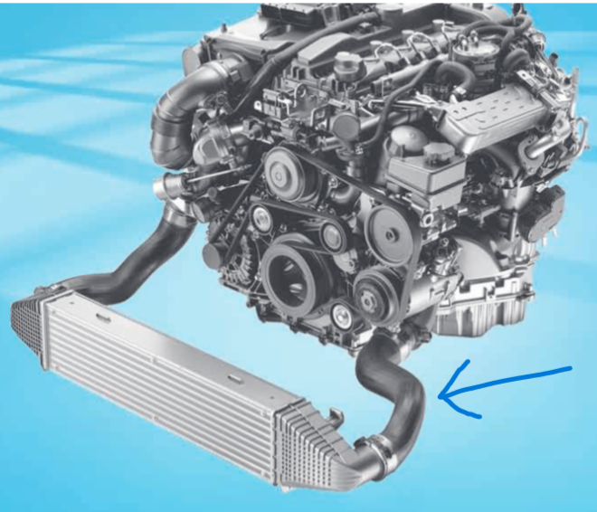

Hi, found out what my issue was with the whoosing sound and now i need to find a part number for the hose that has a hole in it.
my Vin is WDD2122032A809898 and the hose is the one that goes from the intercooler to the turbo " cold side" <<< i think thats what its called but here is a picture just in case i have the name wrong.
I think the part number may be EAN-5400608153057 but want to make sure as there is a big price difference between the 4 ive so far found lol

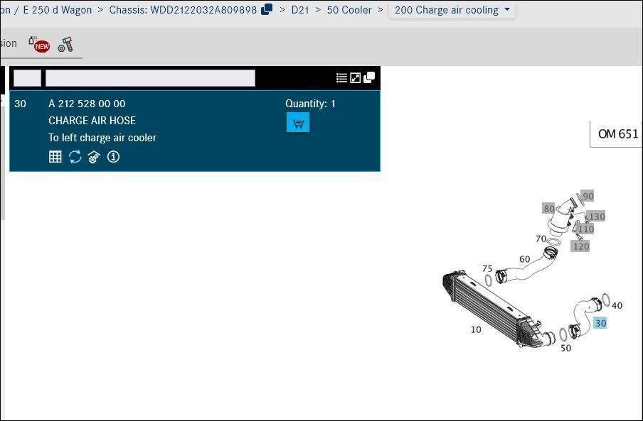

Current MB part # is 2125280000.

Old Sep 28, 2022 | 06:13 PM
Wolf Jones's Avatar
Joined: Mar 2021
Posts: 7
E250
That's perfect thank you.
I manged to get the pipe off hoping there was a part number on it but there wasn't :-( Found just a dribble of oil in there as well, ive hit google and it seems its not an issue as it was only a tiny amount both ends like 2ml Max.
