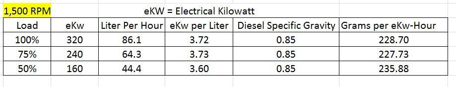

I give you an example where RPM stay the same always but load will change, a diesel generator.
Decent size 320Kw unit in USA will be 1,800 RPM to do 60 Hz, in a 50Hz country it will be 1,500 RPM.
Below is a 50Hz version, 320Kw unit, 1,500 RPM Caterpillar.
https://www.avesco-cat.com/fileadmin...pdf/DM2273.pdf
Go to page 4 of the PDF. I done the easy viewing table for it below.
Diesel generator below 40% load is poor for fuel economy on the diesel engine side and also the electrical alternator side. See above, 75% load as best economy.

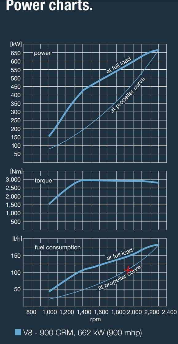

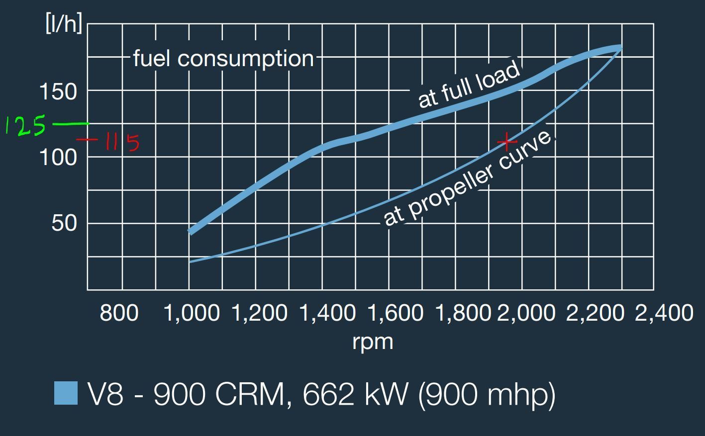

Here is a true logging of fuel burn on my last yacht delivery Singapore to Jakarta, Leg 1 of the trip.
She uses 2 of these 900HP MAN common rail. https://www.performancediesel.com/wp...cht/V8-900.pdf
By the time we reached destination of Leg 1 of approx 350 nautical* miles (* x1.15 to become statute miles ), she is lighter by approx 2,400 Kg from fuel burn and useage of fresh water.
There is a special condition call HULL SPEED which is a fuel killer for planing ( fast) yacht. Once a hull passed 1.0 hull speed, she burn fuel like crazy. No choice, hydrodynamic force at work.
For 15 meters yacht of 25 tons or so, able to do top speed of 30 knots is like a car able to do 125MPH speed class.
The liter per hour burn is accurate as per the MAN given propeller load curve, the 1,900RPM. Below graph is based on single engine, table above is based on twin engine.
So the summary is, depending on your engine design, where and how you use your engine LOAD ..... is most effecting the fuel economy.
