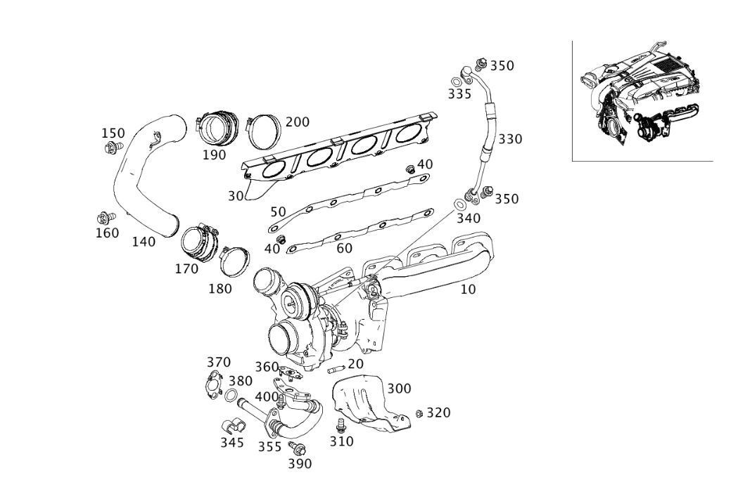

on the stock V8 exhaust, the exhaust headers on each side connect to a main exhaust line (650, 660 on the drawing below) which include the catalytic converter and post converter, and those two main lines connect to the mid and rear mufflers.
So I'm not sure what you mean by 'downpipe' ?

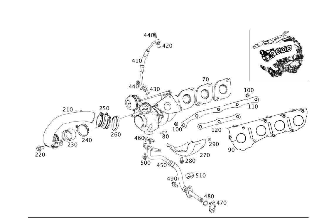

so the turbo side of things with an M278 looks like...

and to be clear, on those top two diagrams, pipe 150 and 210 are both air pipes. guessing the exhaust pipes, 650,660, with the cats attach directly to the turbo exhaust outputs.
