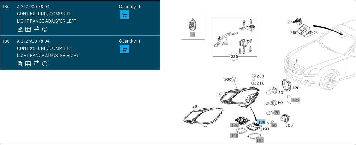

Old Jan 16, 2023 | 09:07 AM
konigstiger's Avatar
Posts: 15,901
Likes: 4,630
From: North Scottsdale, AZ
'71 Pinto
Search MB part # 2129007804 should also pull compatible aftermarket.
