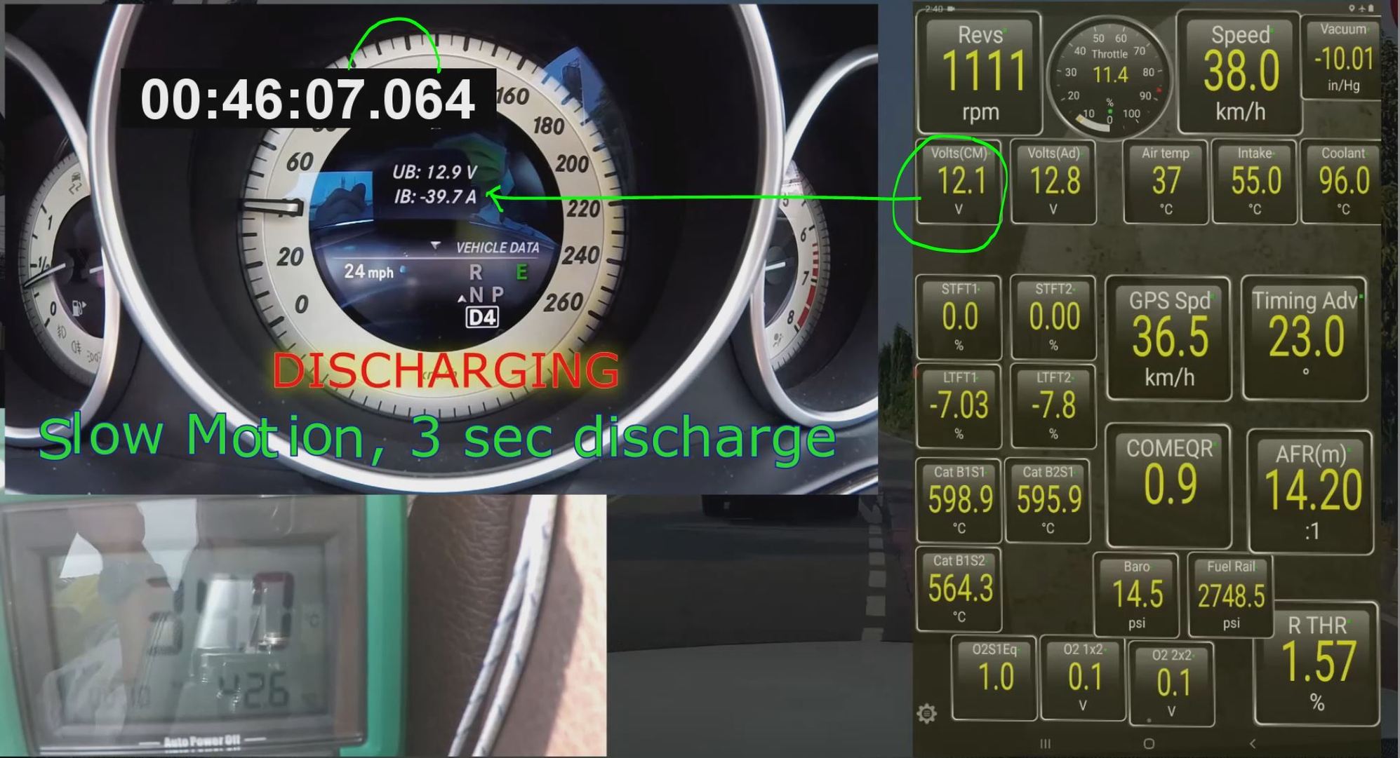

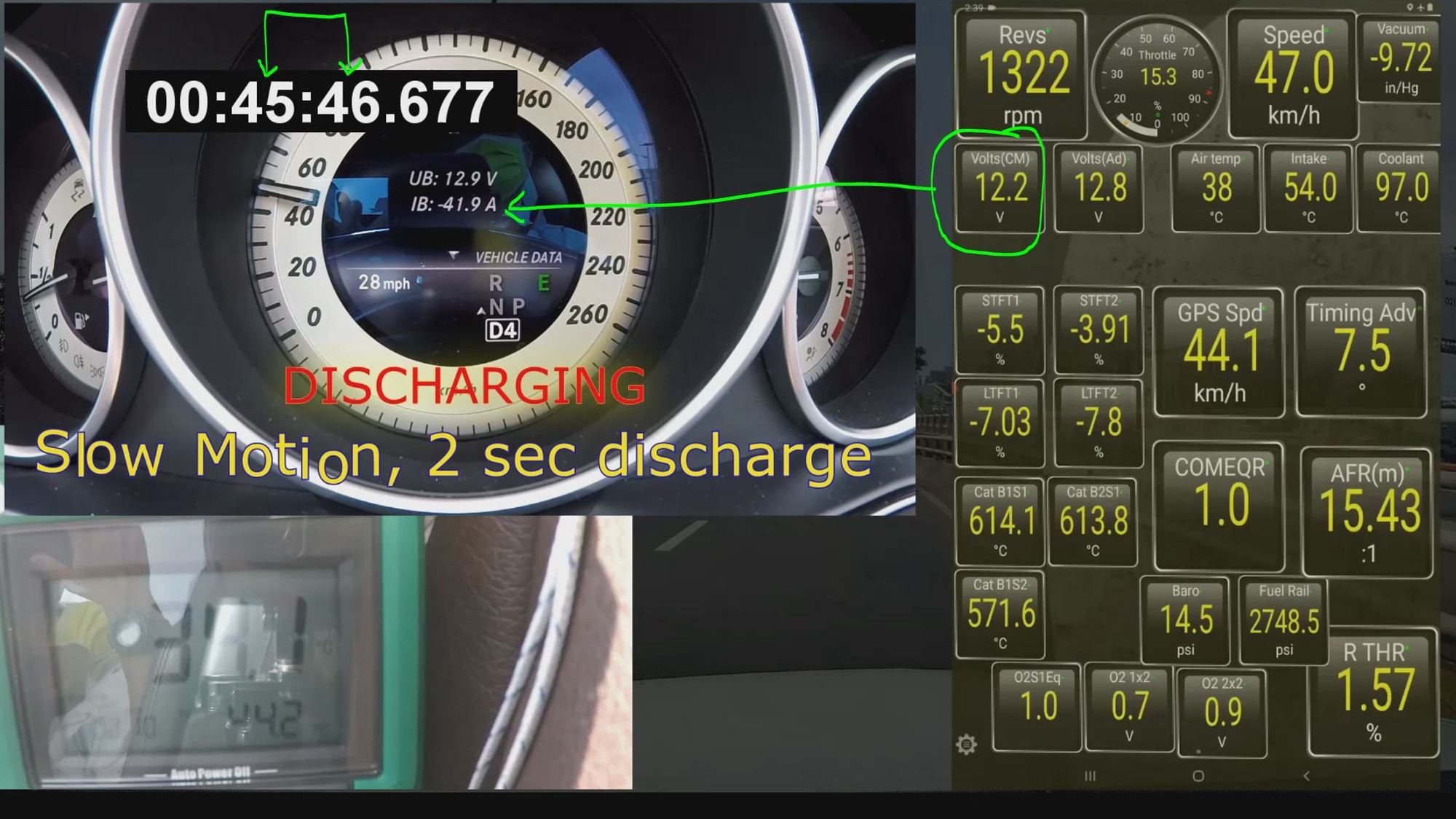

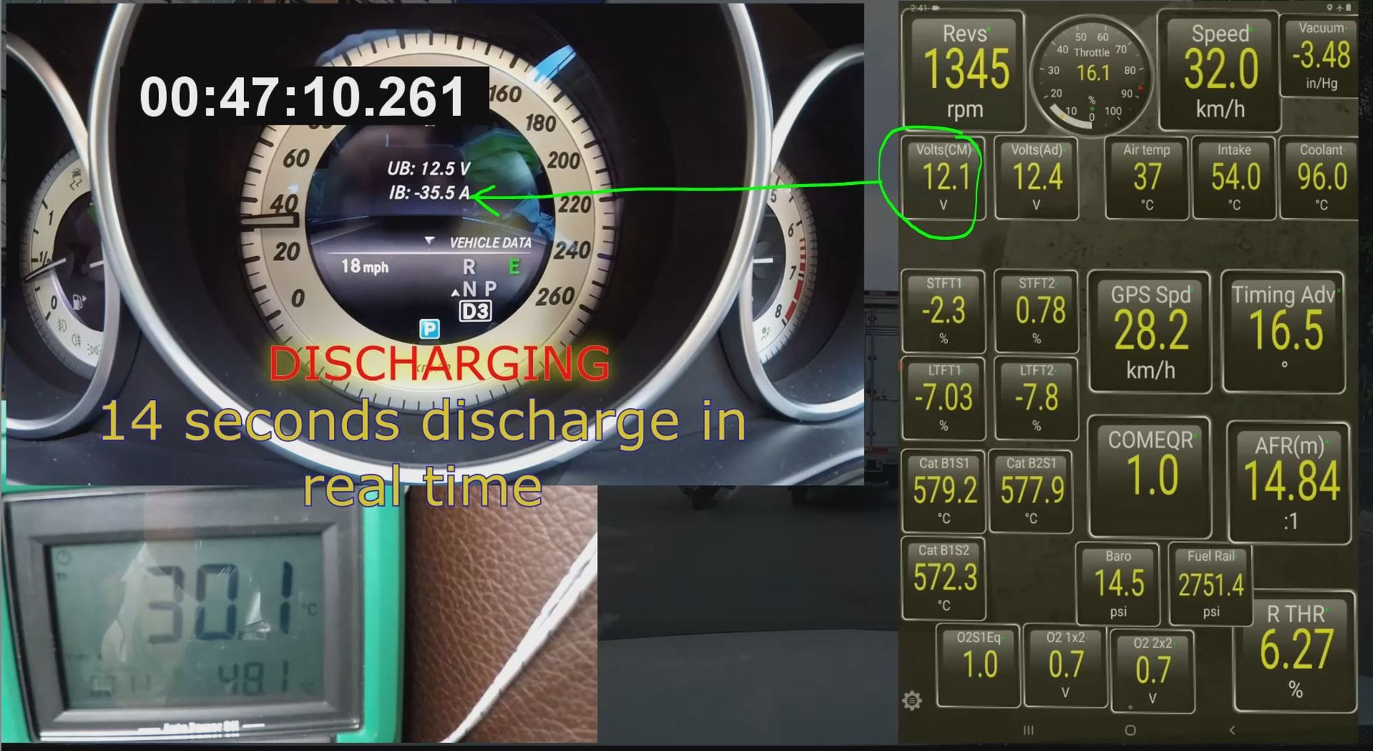

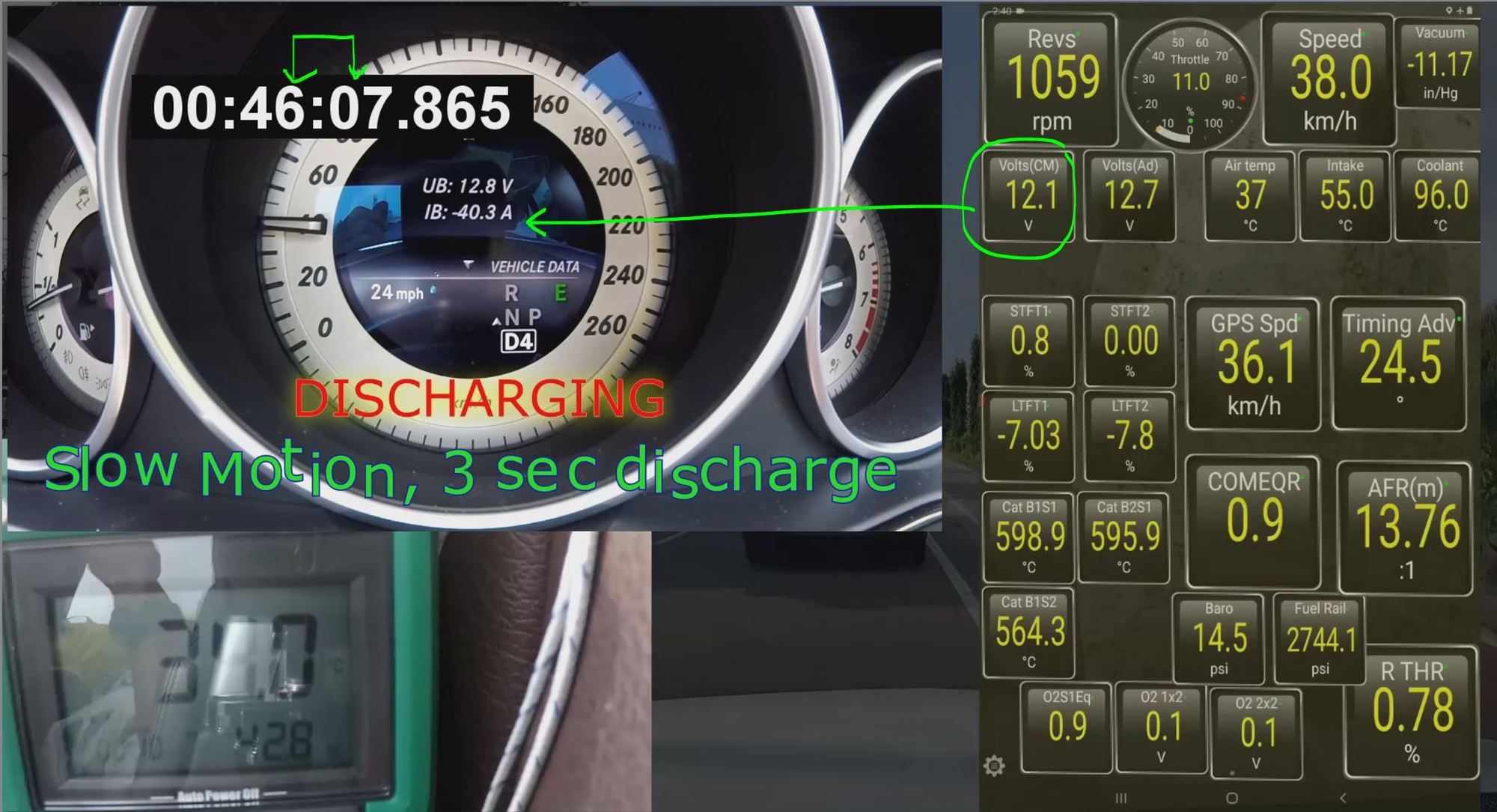

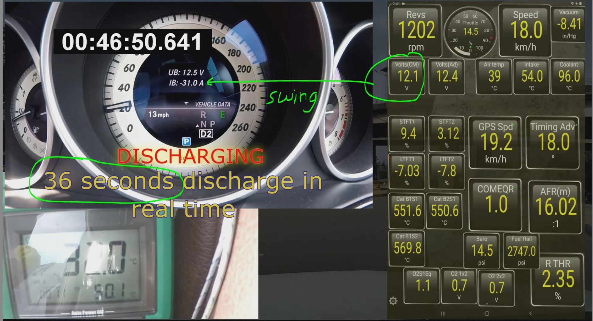

Your ECM manages the voltage and charging of the alternator via the LIN single wire data bus.
Yoyo voltage and poor charging is a built-in program by MB in the name of ECO where about 80% max charging is the target by the ECM for the car battery.
If you log your battery voltage, the one powering the OBD2 socket ( rear SAM supplied power ), there then you will be shocked to see how often the ECM allows the battery to be under 12.6V aka sucked down.
If your definition of AUX battery is the medium sized 12Ah start stop battery, that battery does not do anything when engine is running. The main battery is the one handling DC power needs when engine is running.
The AUX battery only powers certain electronics during temporary engine KILL of Start Stop .
Unplug your alternator LIN and you will get the best no nonsense charging.
You can also with a bit of modification, remove the 12Ah start stop AUX battery....but after you code the car to remove its Start Stop function first.
See my voltage and amperage reading at this WOT pull to 133 MPH / 215KM/H. This is alternator LIN disconnected and the beautiful built in voltage regulator does its GOOD work. No more dumb-azz ECM intervention.
.Beautiful 14.1V and 0.2 amps ( battery is already fully charged )..... you can't get smoother charging than that.
ECM charging management..... below : May 2021 archive
https://youtu.be/dB1um7cjQCI
