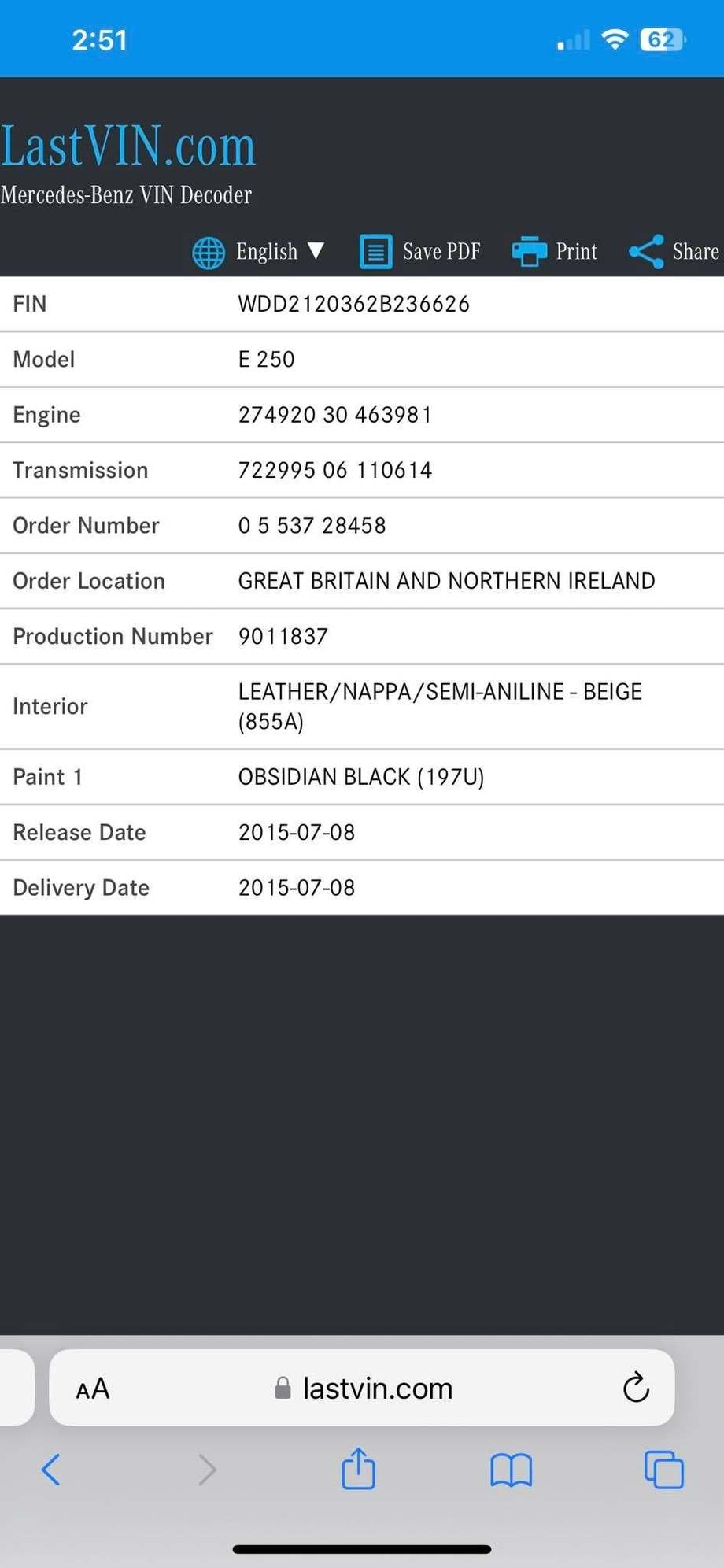

Hi guys,
I'm new to this group. I have a mercedes e250 2.0l (w212 036). I have to change my transmission oil and differential oil. But one thing I'm a bit confused about the transmission if the car is 7g or 7g tronic plus. Could anyone recommend me which transmission fluid to use for the car. ATF 134 FE or MB 236.15? Attached my vin number details
for reference. Thank you

AFAIK, later production (2015) 722.9's are all pretty much the same, you likely want MB Approved 236.15, https://operatingfluids.mercedes-ben...heet/236.15/en
