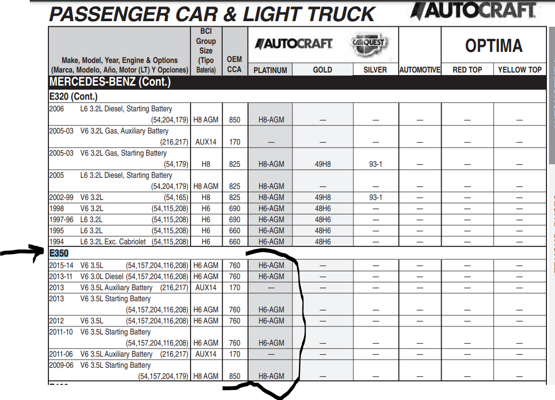

Hello,
MB dealer in Lebanon make an offer for MB OEM battery 15% discount with free replacement. The cost before offer was around 340$ include VAT and labor so with this offer it will be around 250$. My car was imported to Lebanon and its battery didn't replace yet. My battery is AUTOCRAFT Platinum H8-AGM 850CCA 95AH with label Made in Germany and the code is A9VTB,so manufacture date January 2019 and the service paper shows that it was installed in May 2020 in USA keep note that the car was stopped from 3 2022 to 10 2022 until arrived Lebanon. It is working fine and no issues. Do you suggest to replace the battery with OEM one using dealer offer or not, what you will do in my situation.
Looking forward for your comments.
Note: I have W220 car too and its battery was replaced from January 2020(100AH).

Batteries do not expire by date, so that should not be an issue.
Now the brand of the current battery. I understand Autocraft makes: platinum, gold, and silver. I assume it is a Platinum
Get someone to "load test" your battery to find out how much CCA is left from the specifications. That is also called the "health of the battery". If it is healthy, changing it would only be to have with the MB sticker on it (even though MB does not make batteries)

Battery testing can be tricky as you are measuring condition of chemistry by measuring voltage.
I do have load tester and Solar gizmo, who electronically estimates CA. Between the 2 I can tell general battery state.
Sometimes battery can hold the voltage, but will not have capacity. Sometimes it has slow discharge capacity, but will not have cranking amps.
Quick test is to display battery voltage on cluster (engine off) and then turn all the headlights and blower on. Big voltage drop indicate battery going down.
