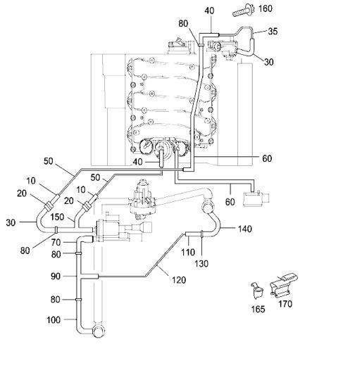

I would replace all the soft rubber vacuum lines on the intake while its out. They did cause me misfires in the past.

my guess is intake is leaking.
Either because improper install or something attached to it and internally connected to air flow is leaking.
R&R intake and check everything
OR check as much as you can before R&R intake.
Could also be wire or connector to injector or coil pack fault.
