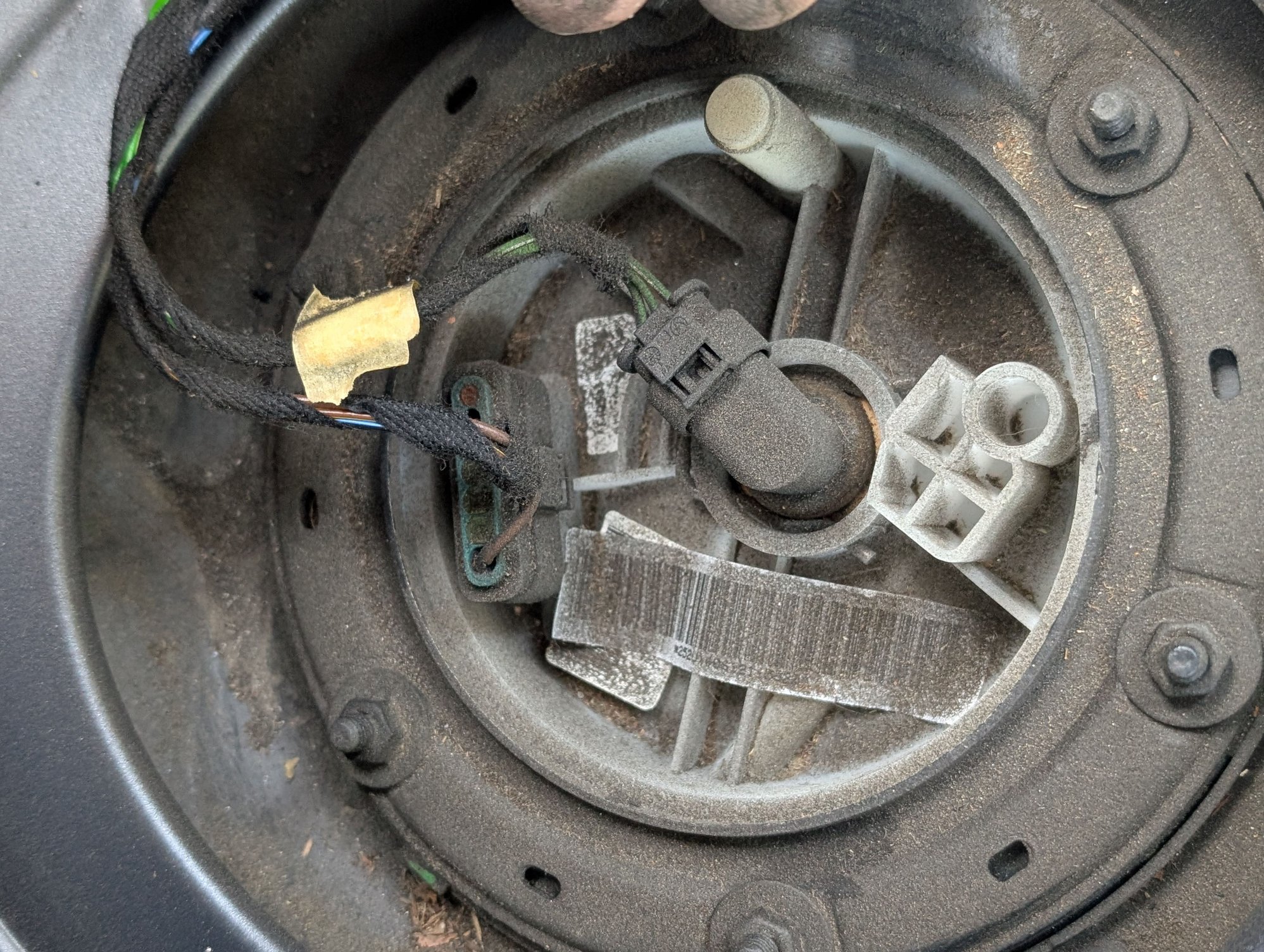

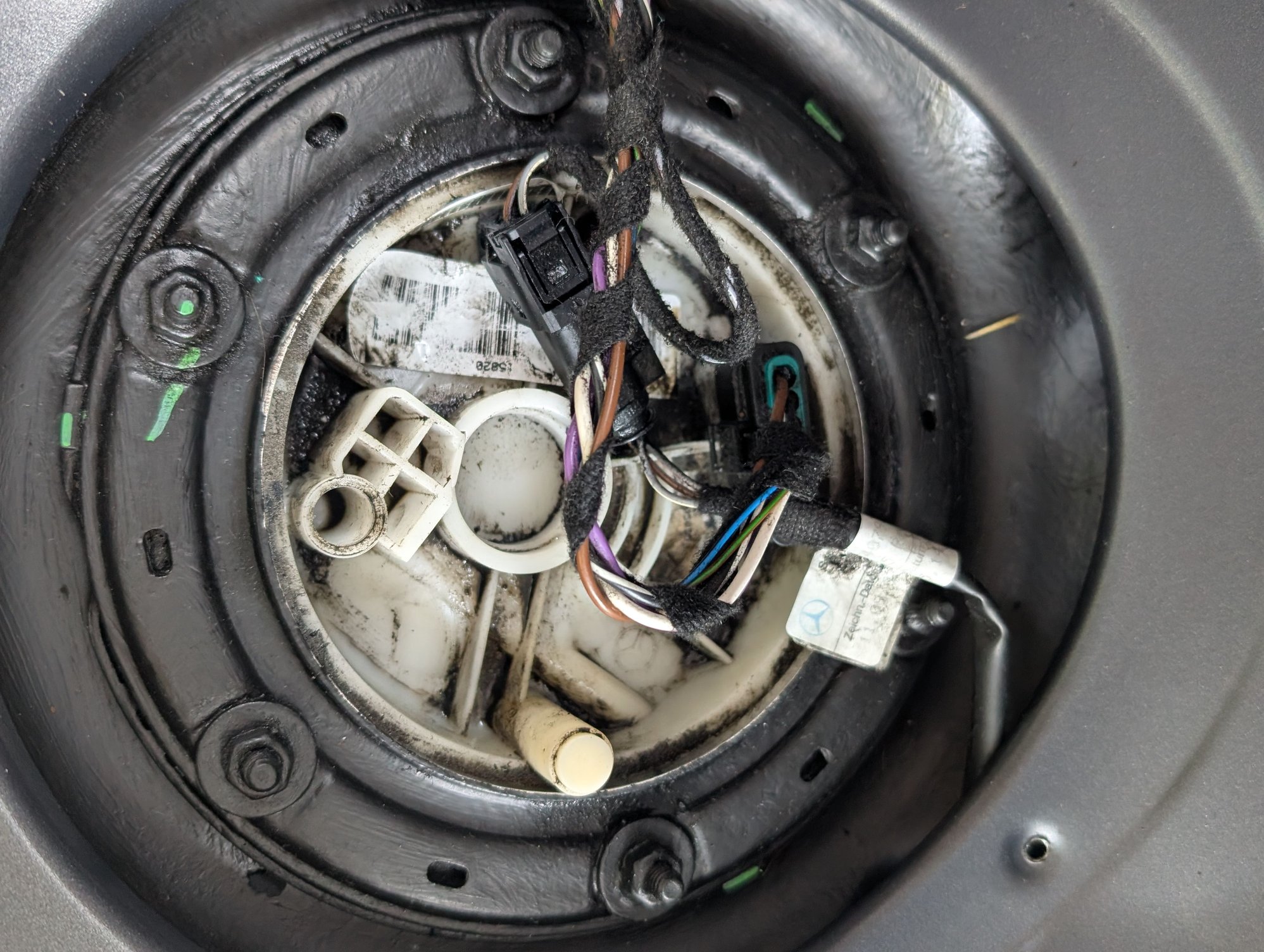

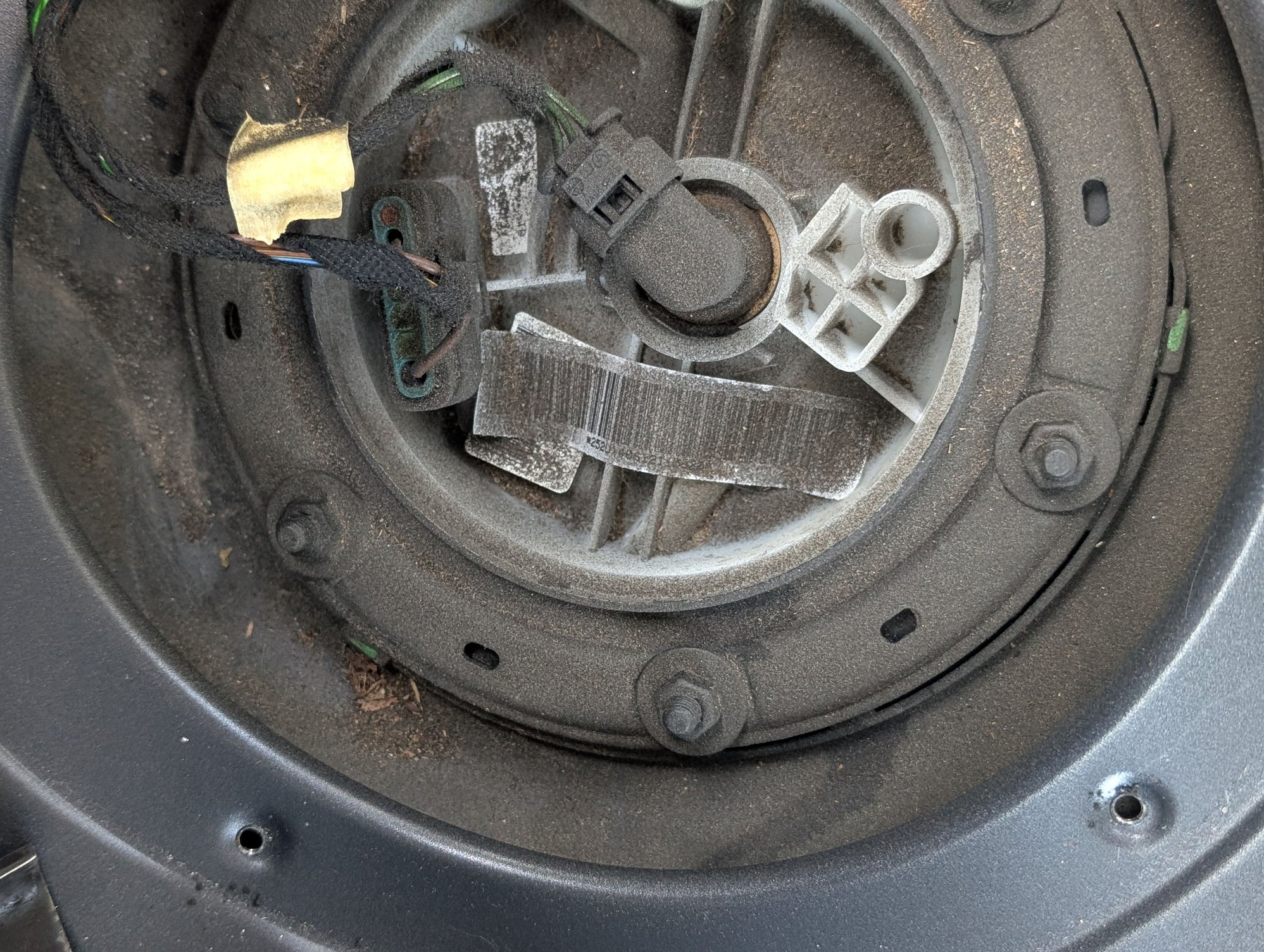

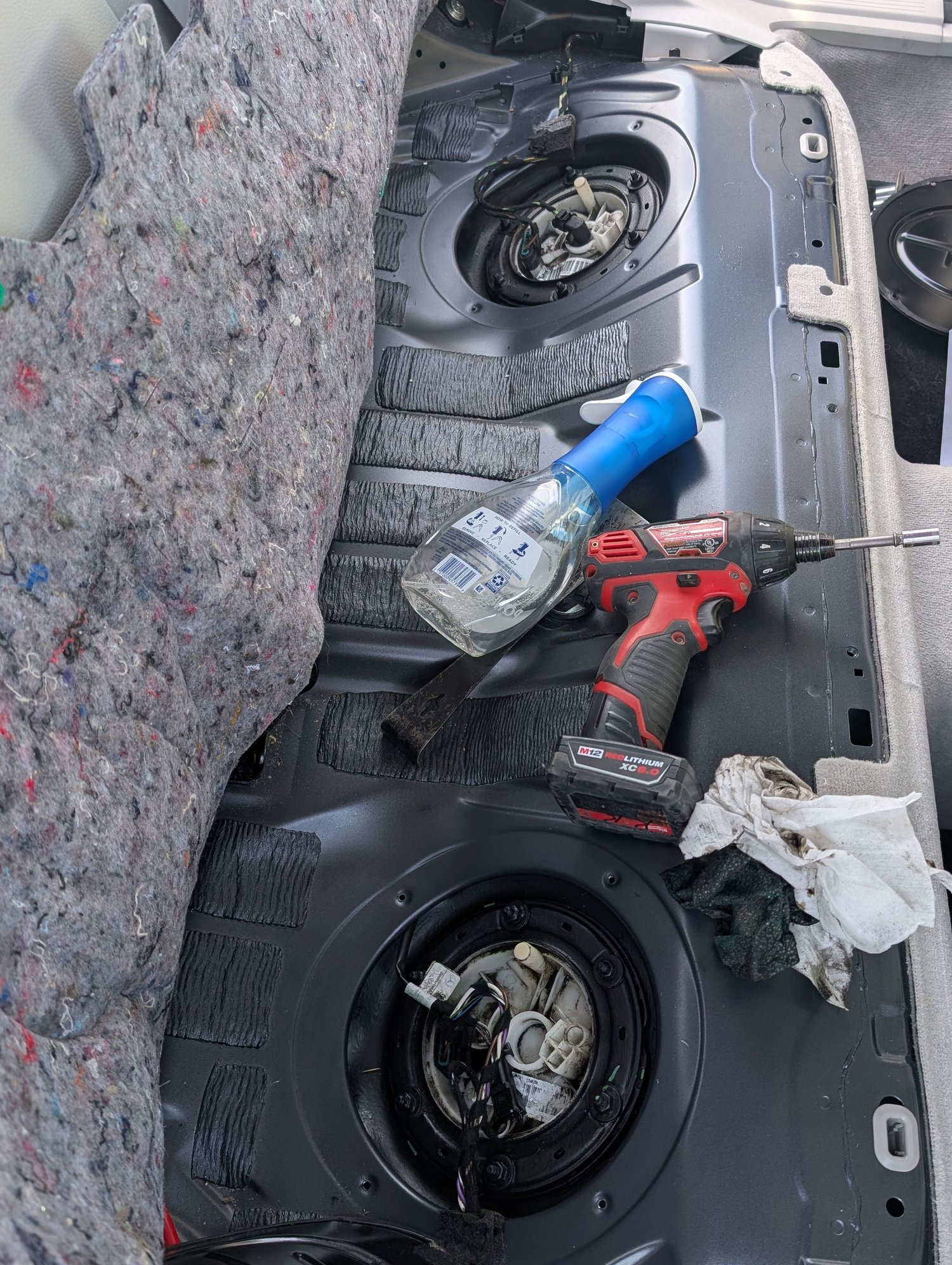

I removed the rear seat and began to smell fuel but only after removing the outer covers from drivers and passengers sides did the smell increase.
both sides has residue from a fuel leak leaving the surface filthy. but obviously not clean and dry as it should be.
I attempted to clean both sides just to see and changes moving forward, sort of a bench mark. plan is to visit the dealership after the internet research and start gathering factory OEM part# so I can make the decision if I want to do the work if the dealership declines to make the repairs under this factory recall, again as previously satiated the repairs are supposedly predicated on the build birth day of the car.
That all said, I had the same problem with my 2009 e350 sedan and after dropping it off at the dealer for them to look and decide what to do or how to handle this problem, It was all warranty recall repaired. No Charge.
