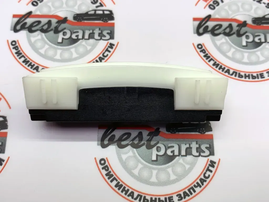

Item 120 or item 30, same parts.... stand alone
https://bestparts.kiev.ua/content/im...709260229.webp

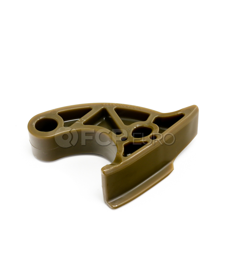

Item 70
https://www.fcpeuro.com/public/asset...v6.?1565729311
