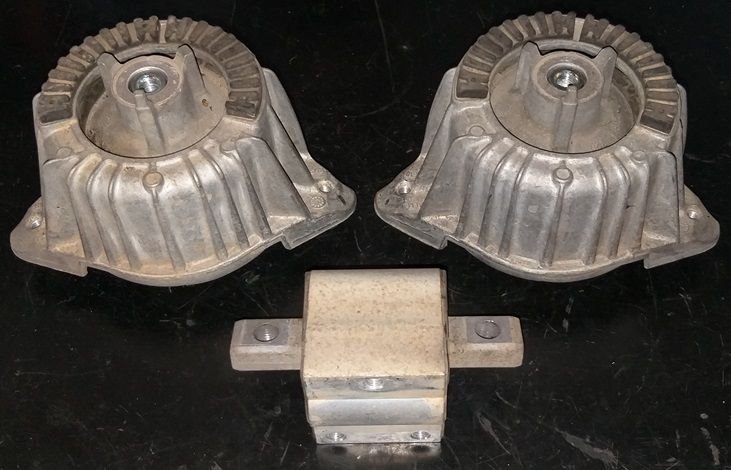

E Class W212 E250 M274 - rough idle
Rough idle, engine rattle, shudder when steering wheel is under load
Usually caused by the engine mounts, hydraulic type which have collapsed
While the car is on the hoist, swap out the transmission mount as well
Left and right engine mounts are the same, part number 2122407217
Transmission mount part number 2122400418
I have used aftermarket and they are probably all made in the same factory anyway
