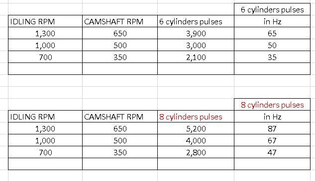

Now assuming you are accurate on the 60 to 80hz sound you are hearing, if we convert that to rotational speed, that is :
60hz x 60 seconds in 1 minute = 3,600 RPM
This is not idle speed but can be engine exhaust pulses.
I do not know what engine is yours because I do not see a W212 and its model year in your signature, but I assume it is a 6 or 8 cylinders.
Cold idle at 30C / 88F if M276.8 3.0 Turbo is 1,300 RPM and slowly brought down to eventually 650 RPM. I believe this strategy would be the same for most MB engines.
To my understanding this 60 - 80hz is there at cold start and gone when engine has warmed up...correct ?
At cold idle RPM and a 6 or 8 cylinders, there will be 6 or 8 exhaust pulses per 1/2 of engine CRANKSHAFT idling speed or we can call it CAMSHAFT idling speed.
4 stroke engine need 2 CRANKSHAFT revolution to fire all cylinders.

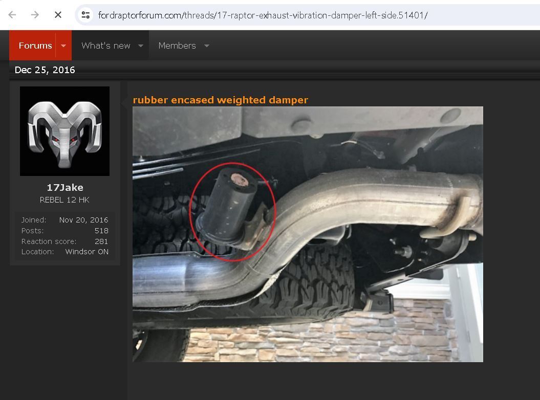

I believe what you are hearing has to do with exhaust system hangars 4 of them and the small vibration damper. Renew those 4 super cheap rubber exhaust hangars.
My M276.820 3.0T has one small vibration damper at the middle silencer , the one after the CAT.
Example from a Ford truck
