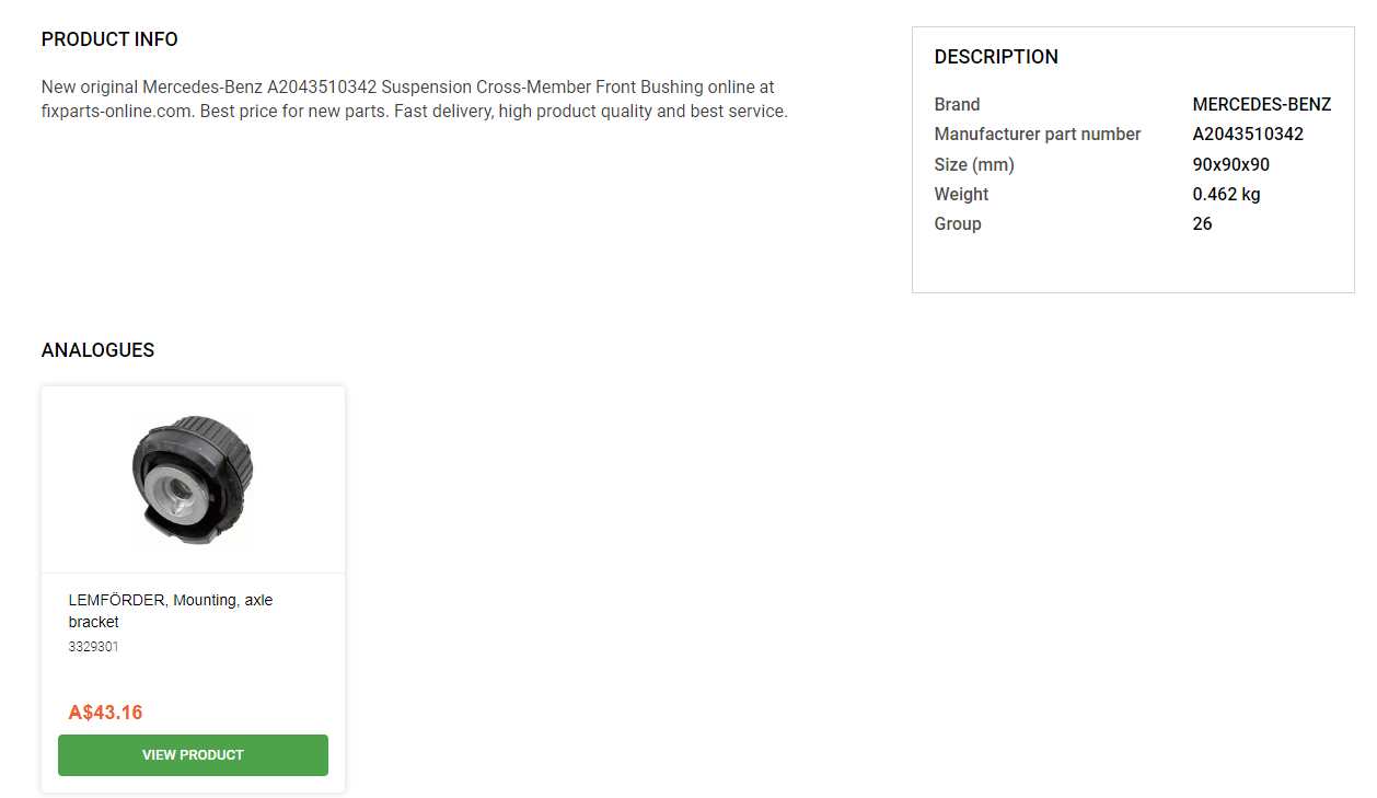

Rear axle subframe mounts A2043510342 and A2043500075
The front mounts, forward of the wheel arch are hydro mounts (one of which was leaking fluid on my car)
The rear mounts, are also hydro mounts
Hydro mounts are used on all four corners of the rear axle subframe

W212 E class rear axle subframe was modified for vehicles released after 1 June 2014
The front mounts are larger after that date
Will be the same part number as C Class W205
Mercedes Part Number is A2053510042 (part number 2 below)
