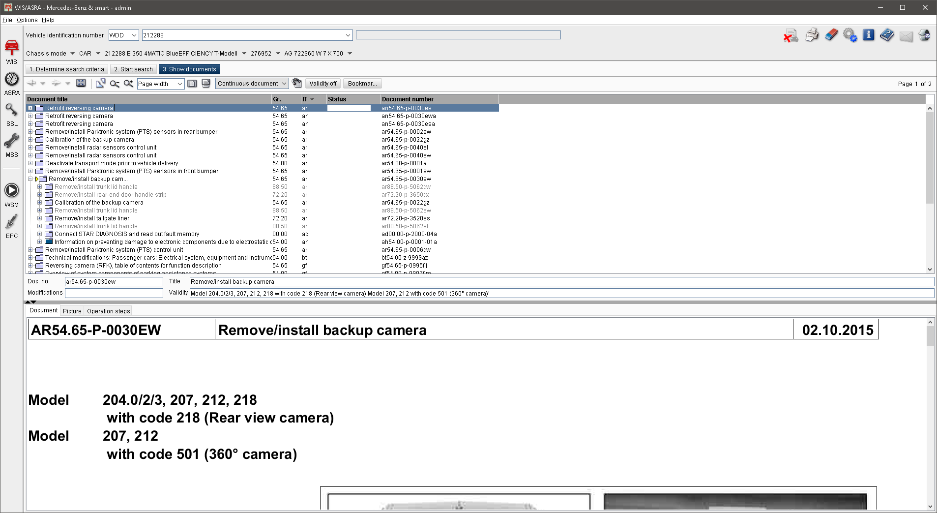

Here is a page from the WIS...
However, scrolling through some of the procedures shows that this is not a simple task and requires a lot of coding of other components, like the TCU, COMAND, and others, to make it work. Maybe it is something you can live without.
