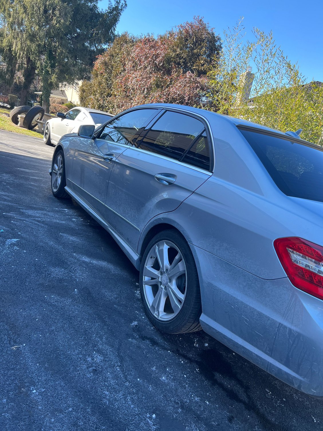

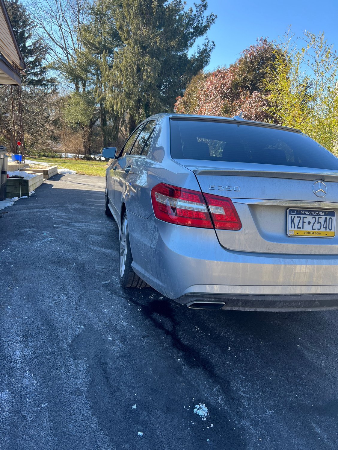

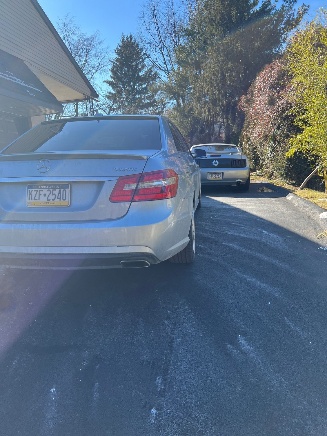

Im looking to widen the stance in the rear a bit, ive got the factory 18 inch wheels and sport coilovers. I would ideally like to put 285’s in the rear but dont know if they will rub. I was thinking a +40mm offset should be perfect but i need to do some more research. Any help is welcome!
(edit: sorry for the sh*tty pics, the forum decided not to take the quality along with the picture)

YOUR STOCK tires are 245/40R18 ? 285/45R18 will be almost 10% bigger in diameter, that is about 2.5" bigger in diameter (28.1" instead of 25.6"), also 1.5" wider. guaranteed those won't fit. also will make your speedo read like 10% higher, at 60 MPH, it will read 66

Or vice-versa Either way you'd need to roll the fenders quite a bit

and bigger/wider tires mess with the steering geometry, changes that big will probably either make it handle like a old truck (heavy steering to turn), or make it really squirrely when accelerating and/or braking.
