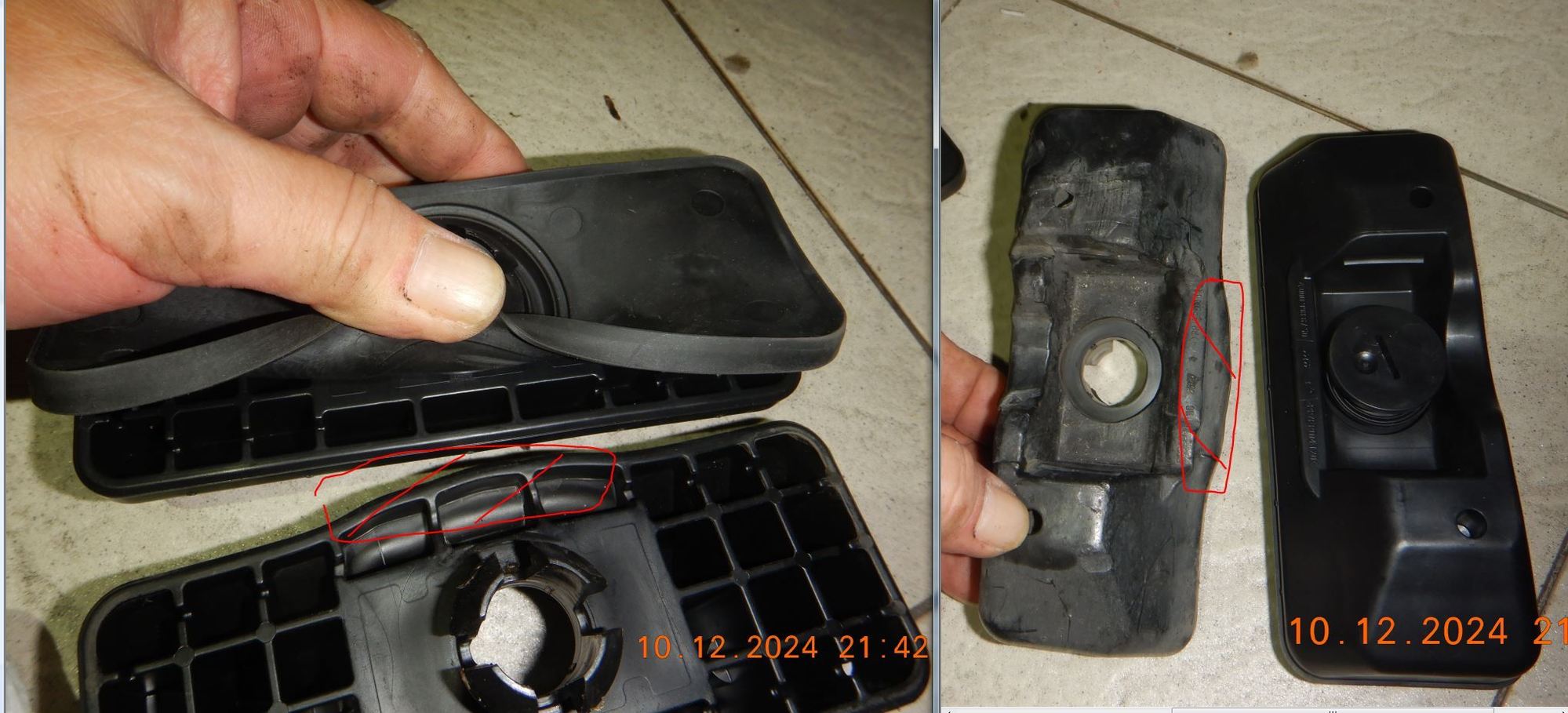

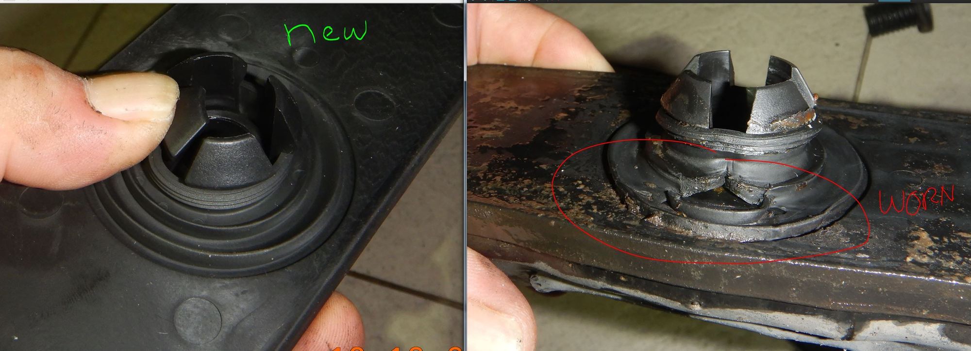

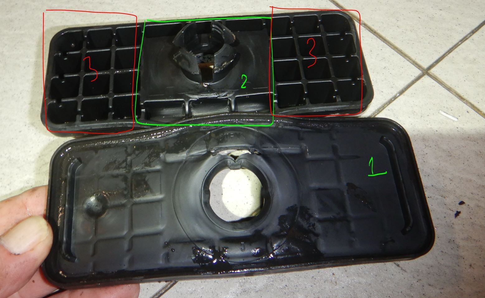

The construction:
01. Is the rubber/plastic seal to make sure water does not enter the locker/mounting hole at car body.

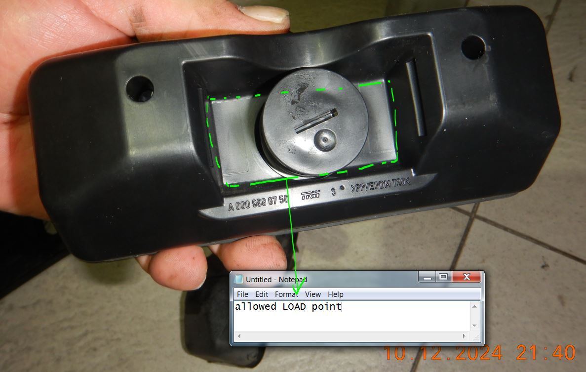

02. Full solid material. The true LOAD zone.
03. As seen, not solid material. To save weight. I would not want to load the car weight at #3.
The cavity at the car body holding the jack pad.
The damage profile when pressure/load is applied at the wrong location on the jack pad.
See the "expanded" body, squeezed at the wrong load point.
The correct and the safest LOAD point/zone in green rectangular.
WHAT IF scenario

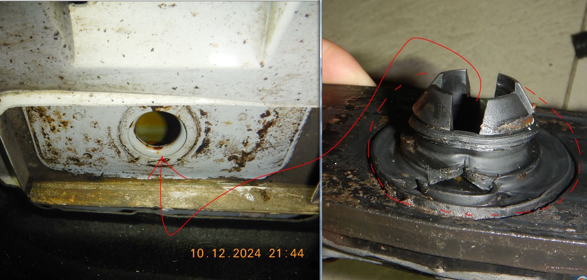

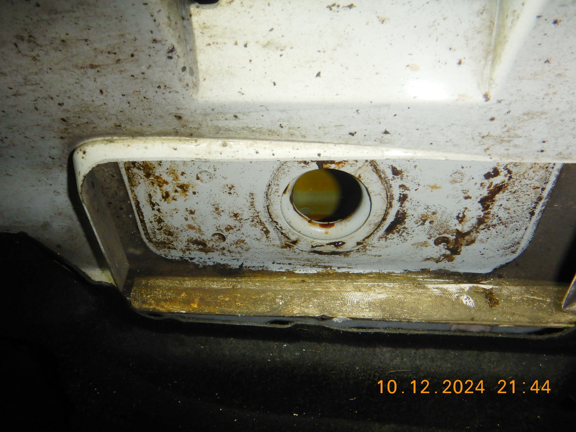

During rain and decent high speed, the FRONT jack pads would be experiencing water jet splash from the tires.
If country with winter salt, perhaps more worry for you guys.
It would be wise the jack pad sealing system is still good. Good thing the cavity at the car body has some sort of spray deflector.
The jack pad mounting location is part of the car chassis where water may linger and that is not good. The rear subframe died from corrosion.
The location of the front jack pad mounting holes are close to where the CAN BUS distribution bar is at Left and Right side of the car.
I wonder if a failed seal of the jack pad and hours of water jet spray from tires, can water actually enter the cabin a bit ?

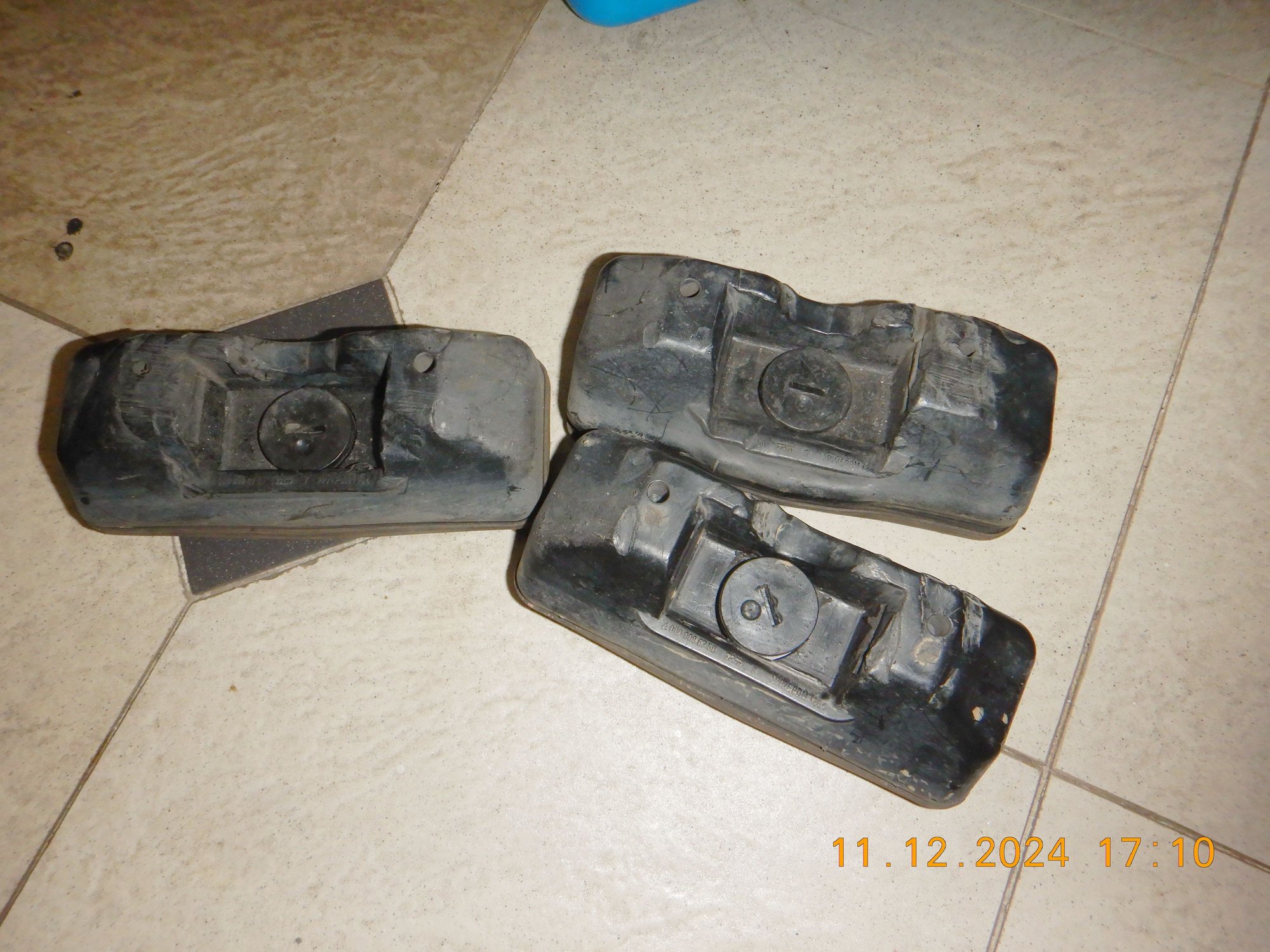

The retired trio.
Okey dokey, go and inspect your jack pads boys....
