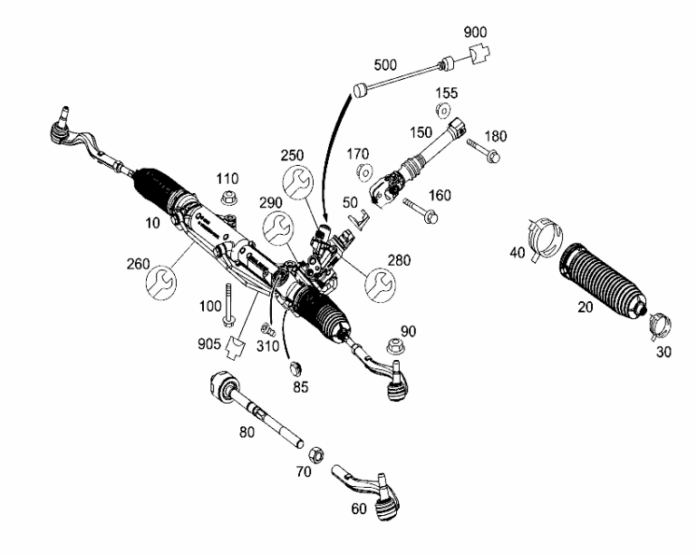

Here is a diagram of the steering components. You can see where there could be some binding if the parts are worn. Were the engine mounts replaced recently? When did this problem start?
My car had Electric Steering rack and the VIN is WDDHF5KB7EA983215
This sound start from 1 month ago, last thing I did to my car was replacing brake pads/rotor at MB dealer (OEM Parts) on 5 Nov 2024 and after that replace tires with new one (Yokohama ADVAN APEX V601) before Christmas. Last checkup(5 Nov 2024) by dealer(before the noise) mentioned that all Engine mounts and sway bar need to be replaced but I didn't do the maintenance yet.
