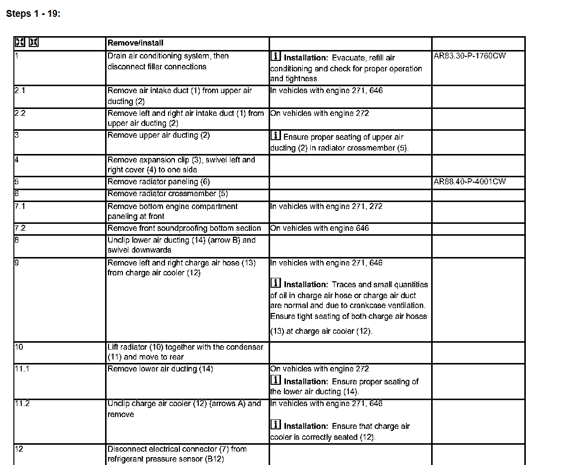

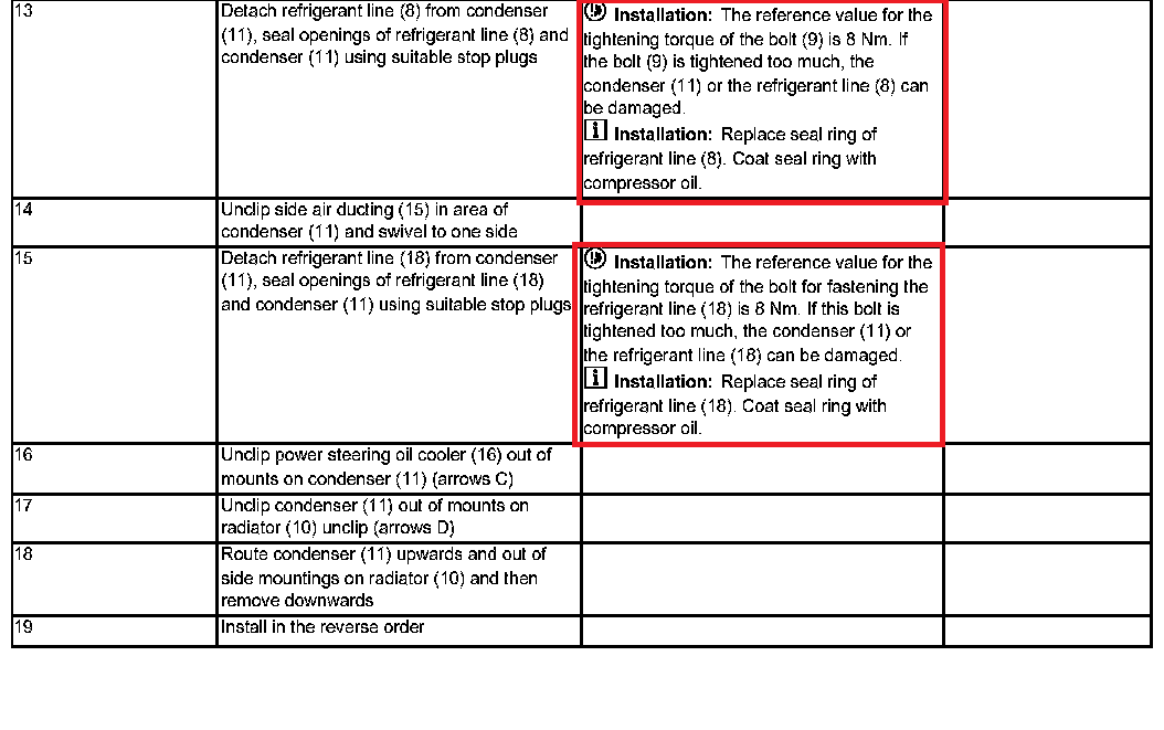

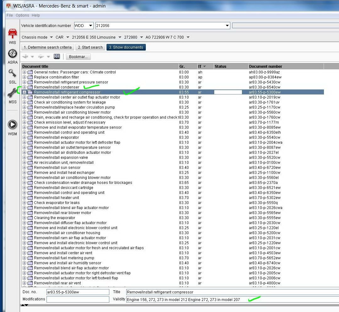

Dang, W212 with M272 engine has better WIS than those with M276, for HVAC.
M272 gets 2 documents M276 does not get.
Replace condenser and Replace compressor. No wonder I been trying to find these two info based on my E400 VIN and WIS does not show
I am attaching the 2 docs, in PDF.
M272
M276
