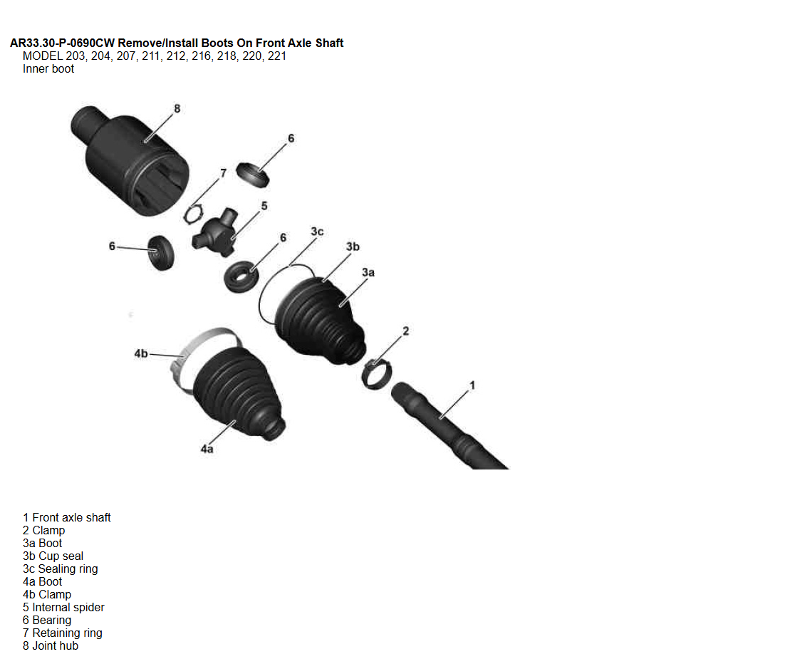

So youre saying part 8 in the diagram below is still stuck in the diff? I'm sure you have seen the manual that shows some type of puller tool used to remove it.
I have a leaky outer boot on my W204 on the right so I have been planning to replace it. So I havent done it yet.
with the rest of the axle removed can you fit a pair of large vise grips on going straight in, clamp them down then you have something to grab hold of and yank.
