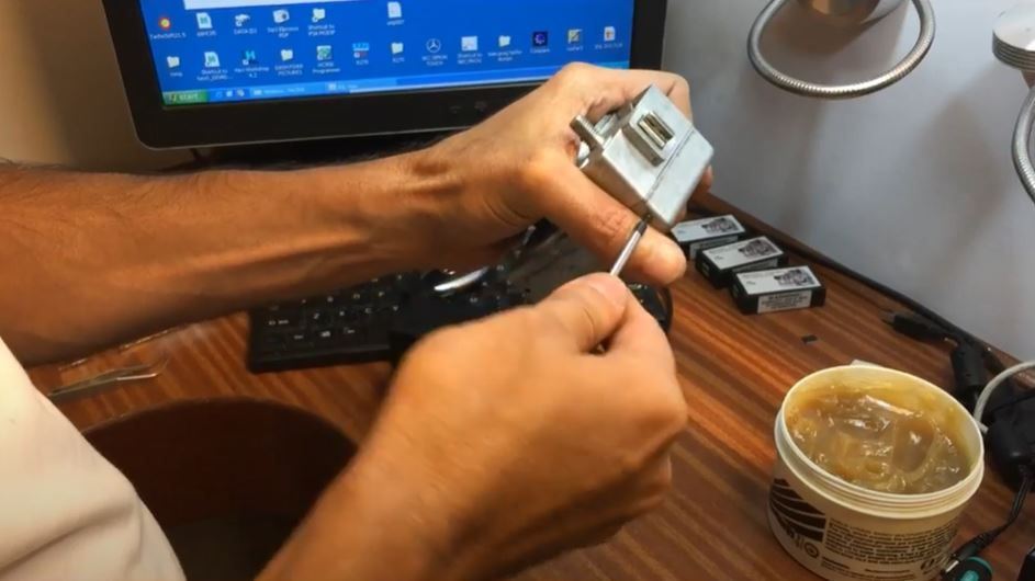

So, I watched a bunch of youtube video's about this ESL. Taking it out is some work, but not difficult. There's plenty of information to be found on taking out the steering wheel and the necessary interior trim. Also taking out the ESL is doable. But then came the hard part for me. Once you have the ESL out, there are 4 spring-pins in the side of the casing that need to be removed in order to open it.
Now, there are some video's in which people just tap in a 4-sided pick tool, or a number 5-6 torx key with some force, and they can turn the pins out. See picture below.
But I just could not get this to work. So I took a different route.

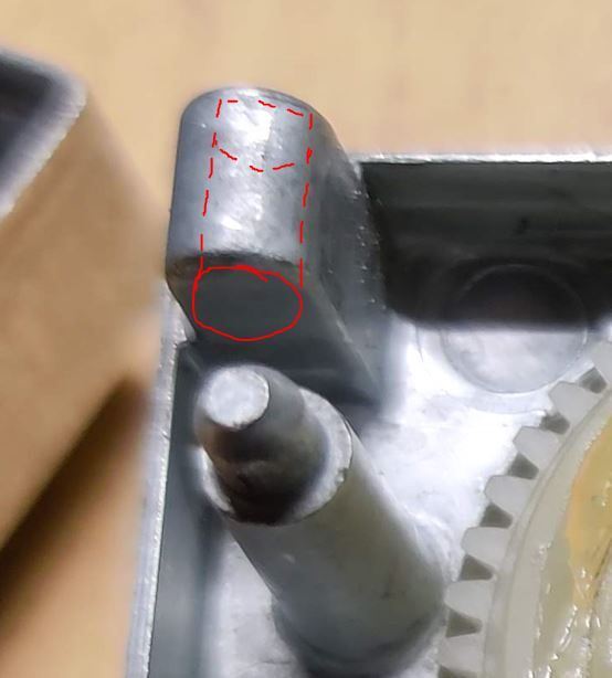

Then drill all the holes all the way through with the 3mm drill. Unfortunately no photo but here's the idea.
After drilling through all the holes I could get my thread tap in far enough. I tapped it to M4. When tapping to M4 you actually need to drill a 3,3mm hole but I only had a 3mm drill. So I had to tap the hole very gently. Aluminum is soft, be carefull!
The 4 holes in the cover of the also needed to be drilled larger to 4mm.
I cleaned everything with some brake cleaner and I regreased all the gears and stuff. Very important.
After cleaning and reassembly I could get my set screws in far enough. I used some loctite to secure them in place and now they look like this.
