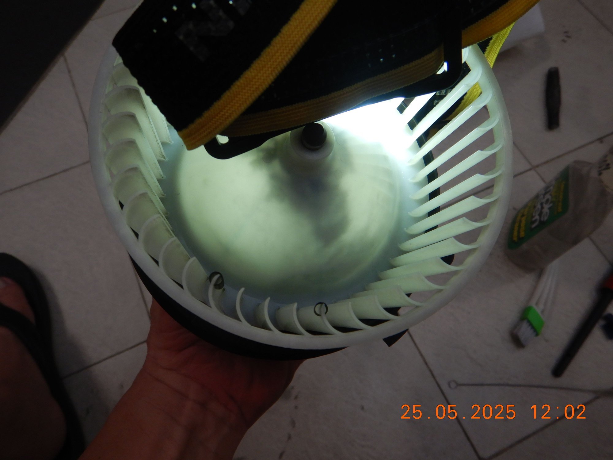

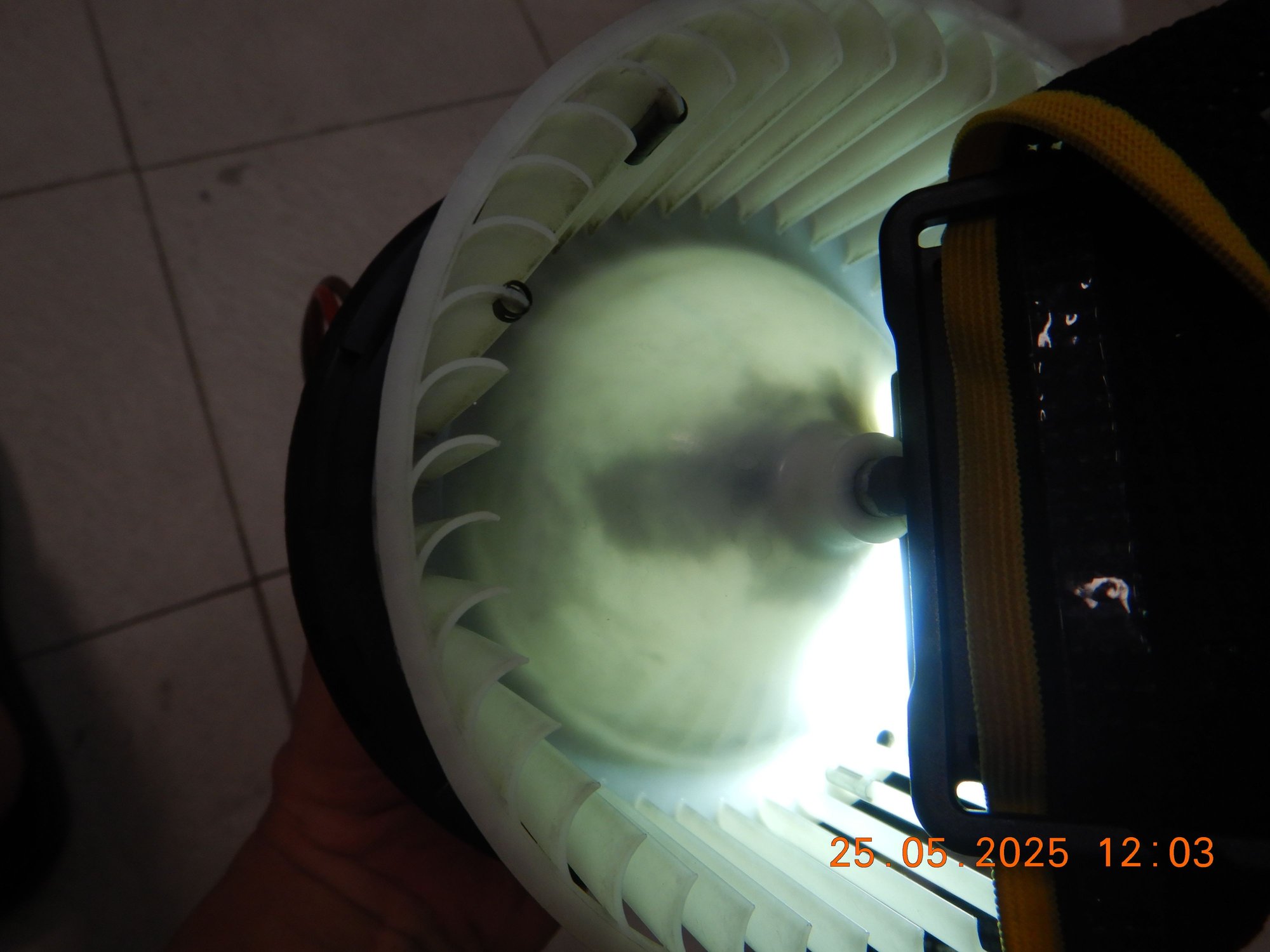

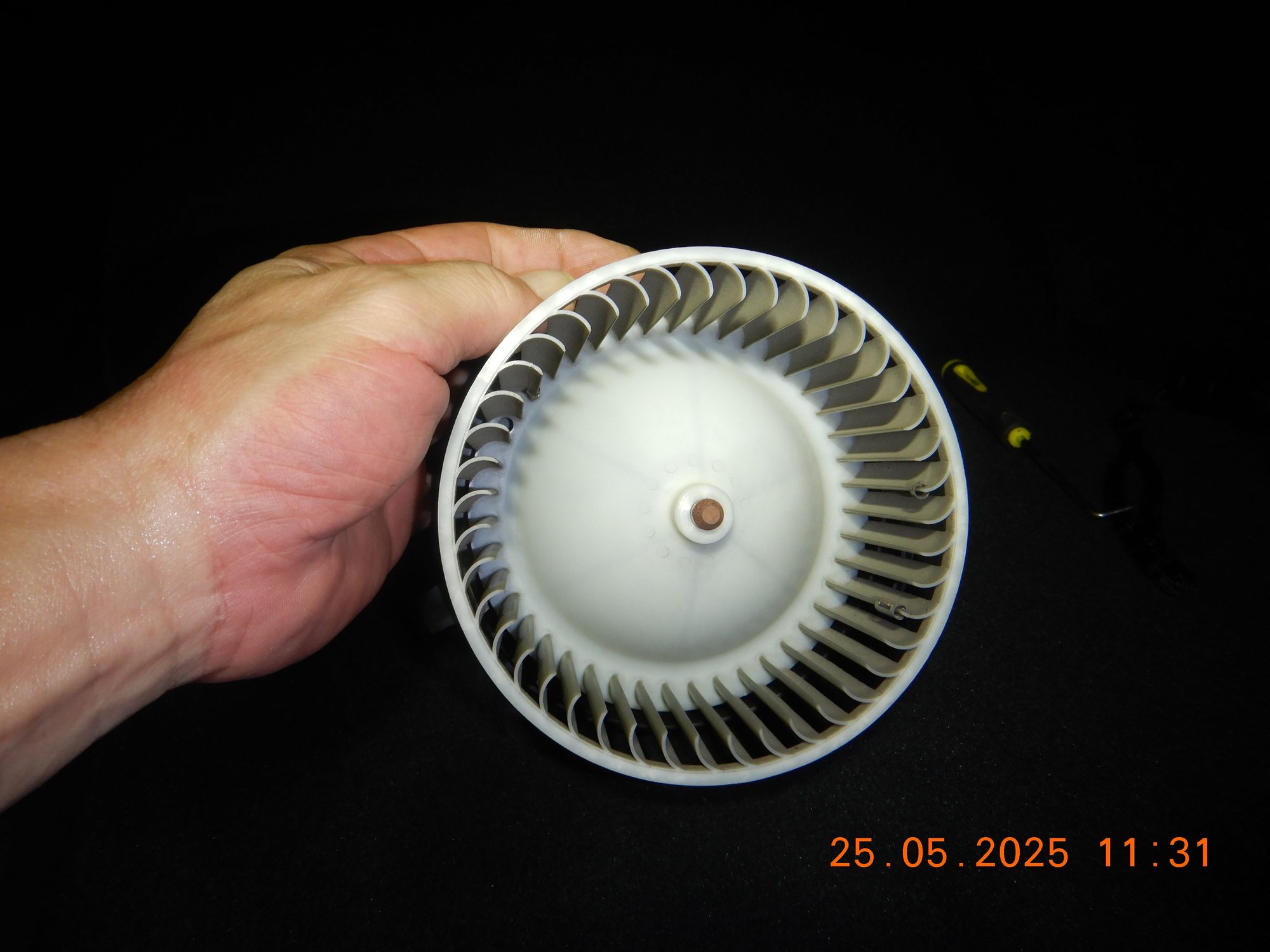

Minor dirt can cause minor wobbling........... 43,000KM car and long time ago I did simple cleaning. Today I did DEEP cleaning.
Imagine if more dirt....how much wobble and eventually motor goes bad.

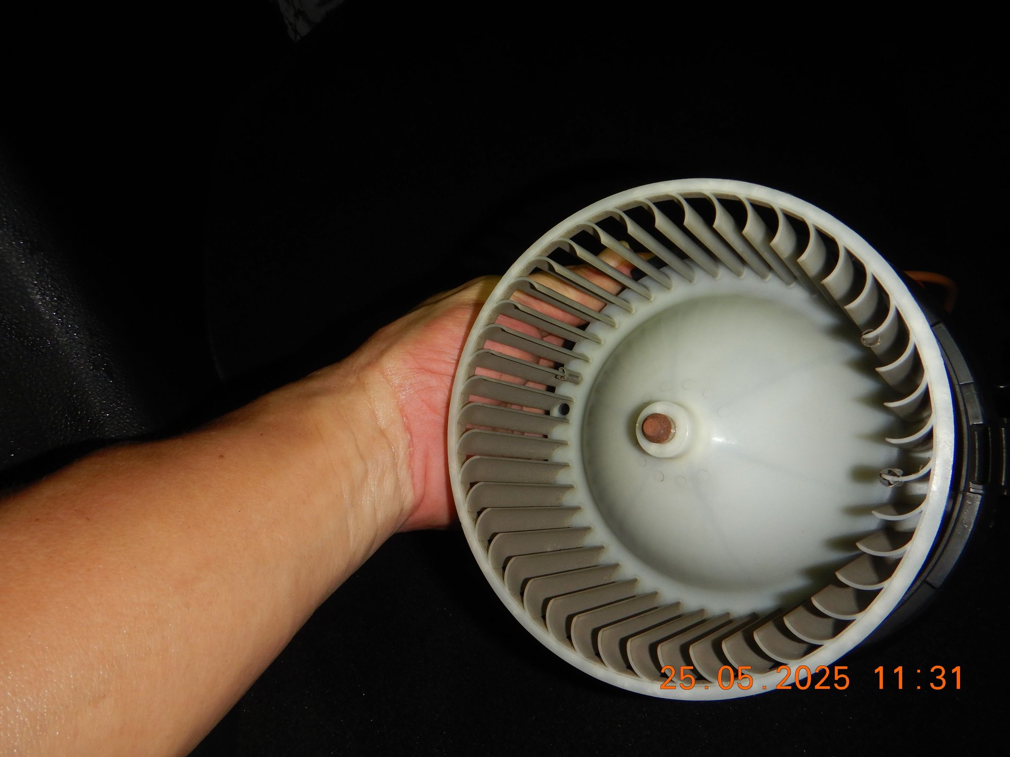

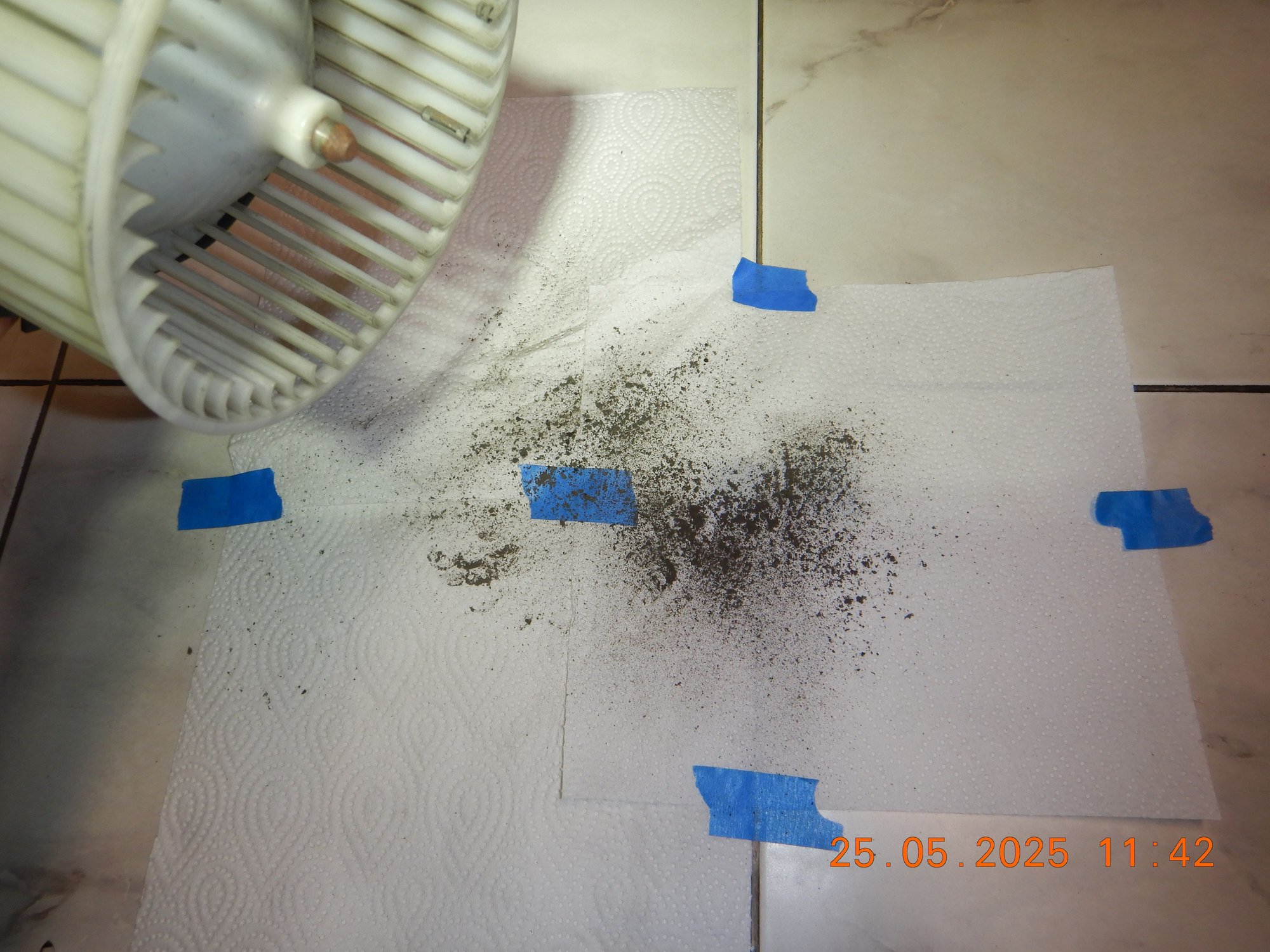

WAS
Notice mini weights attached, that is for balancing.

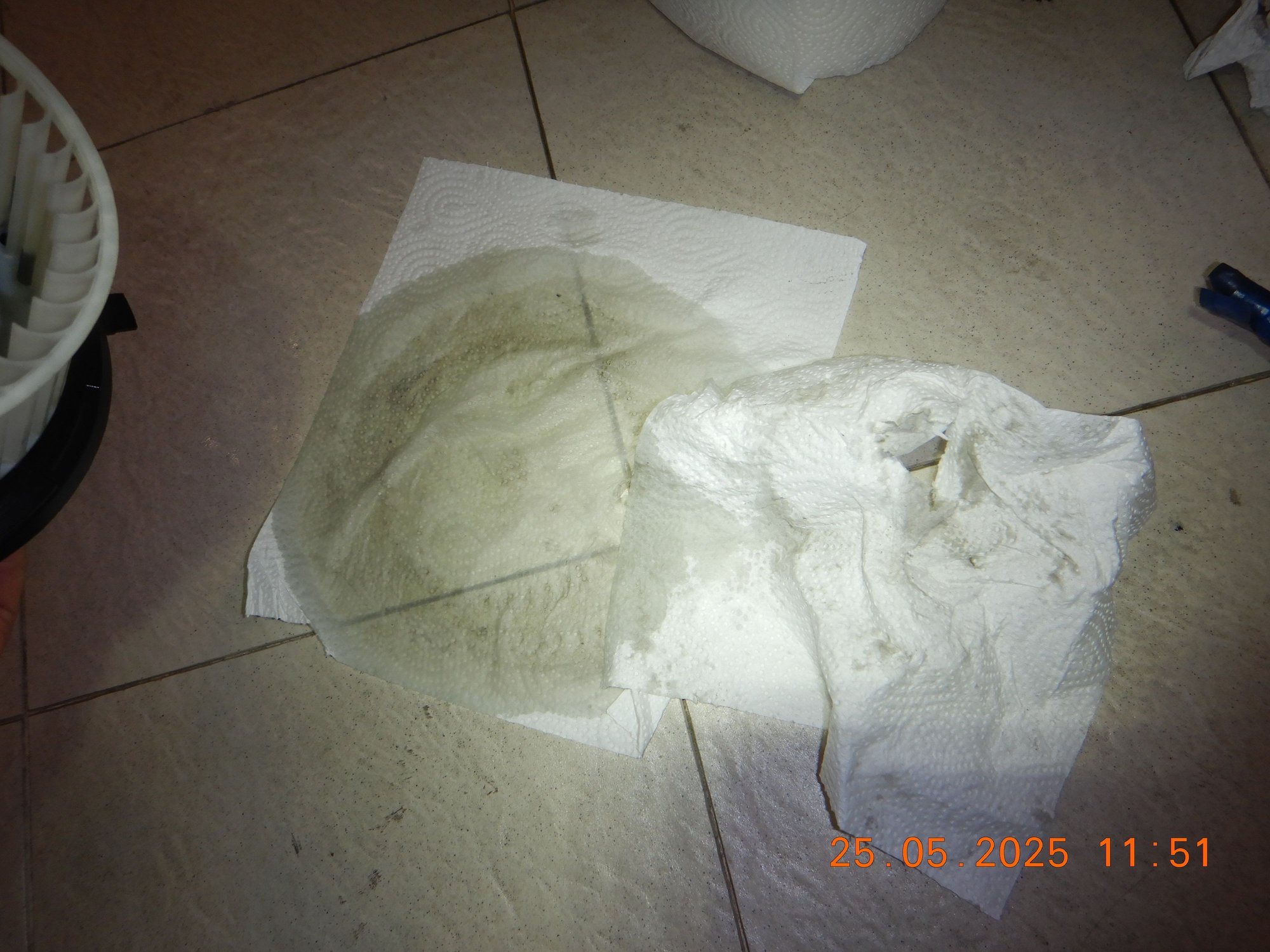

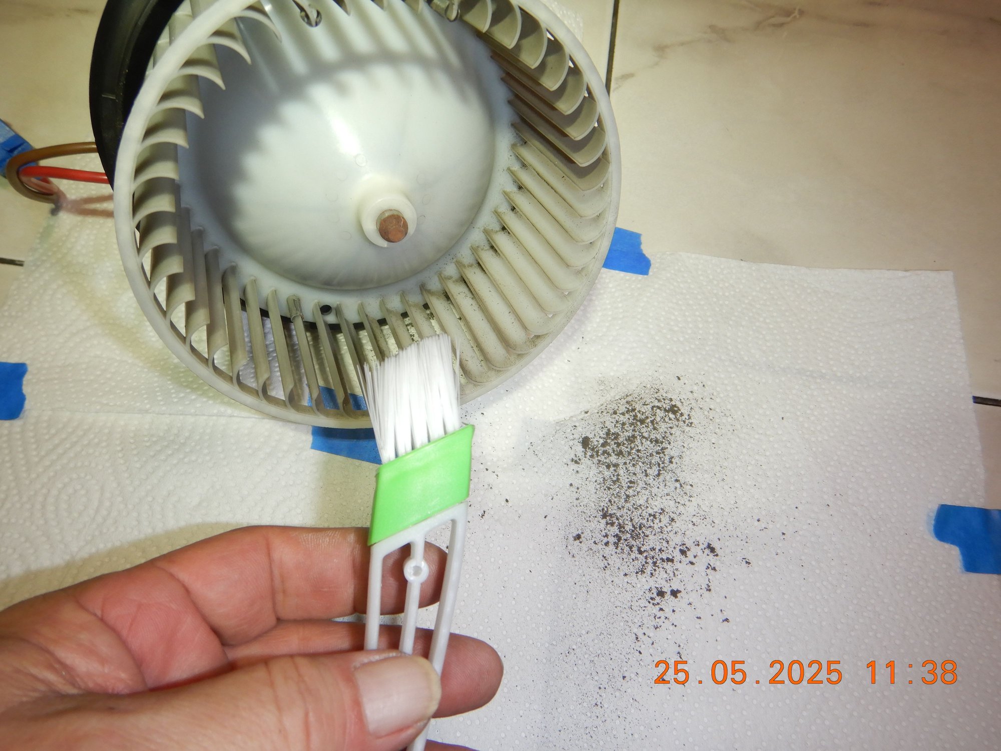

Elbow grease using brushes............ followed by :
99.9% IPA alcohol and then Simple Green and then Water

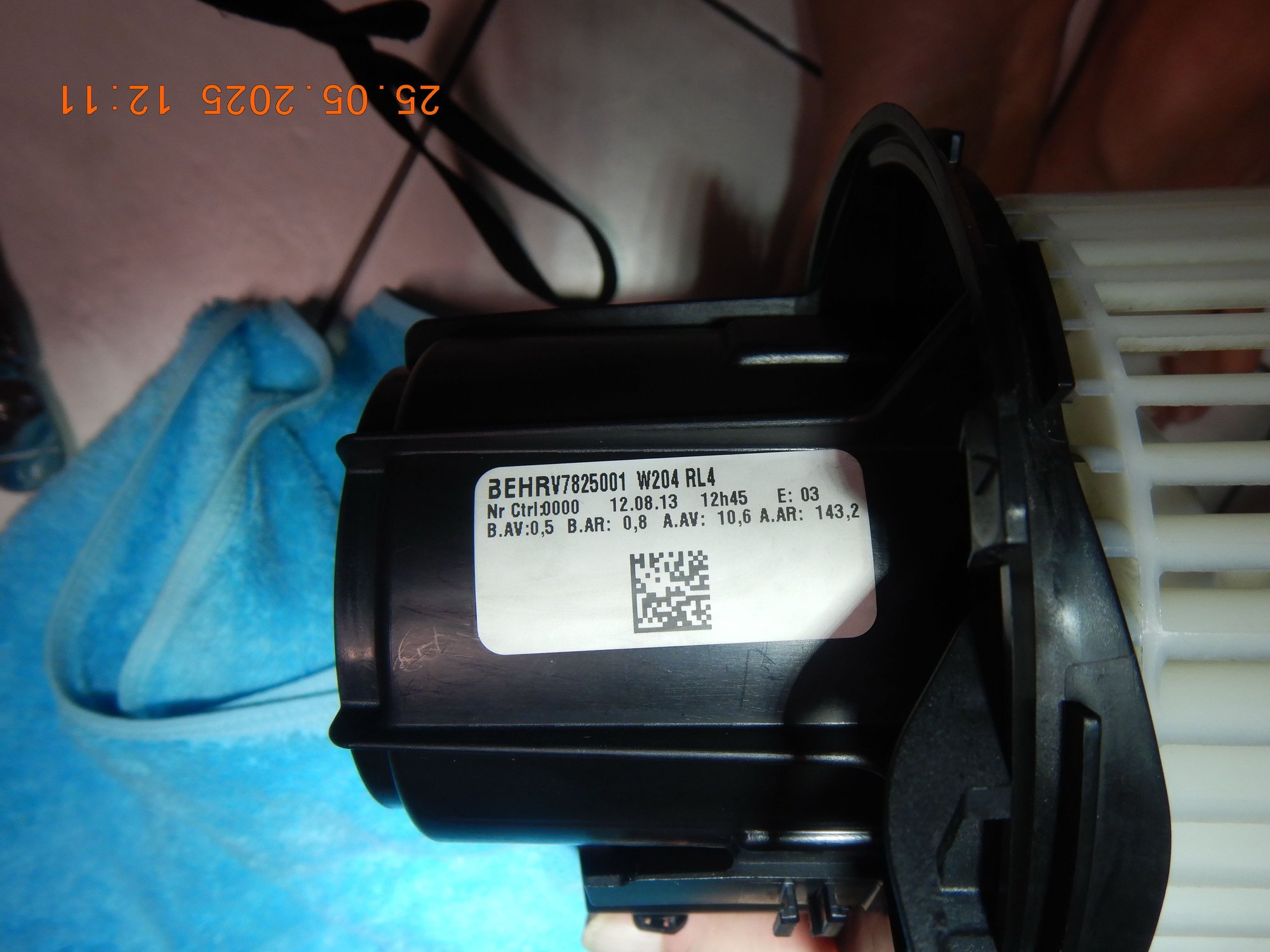

Two white rubbers are dampers.
Part number
Before and after
I wet wiped with 99.9% IPA alcohol all I can reach area of HVAC blower round hole, cabin filter internal and etc....

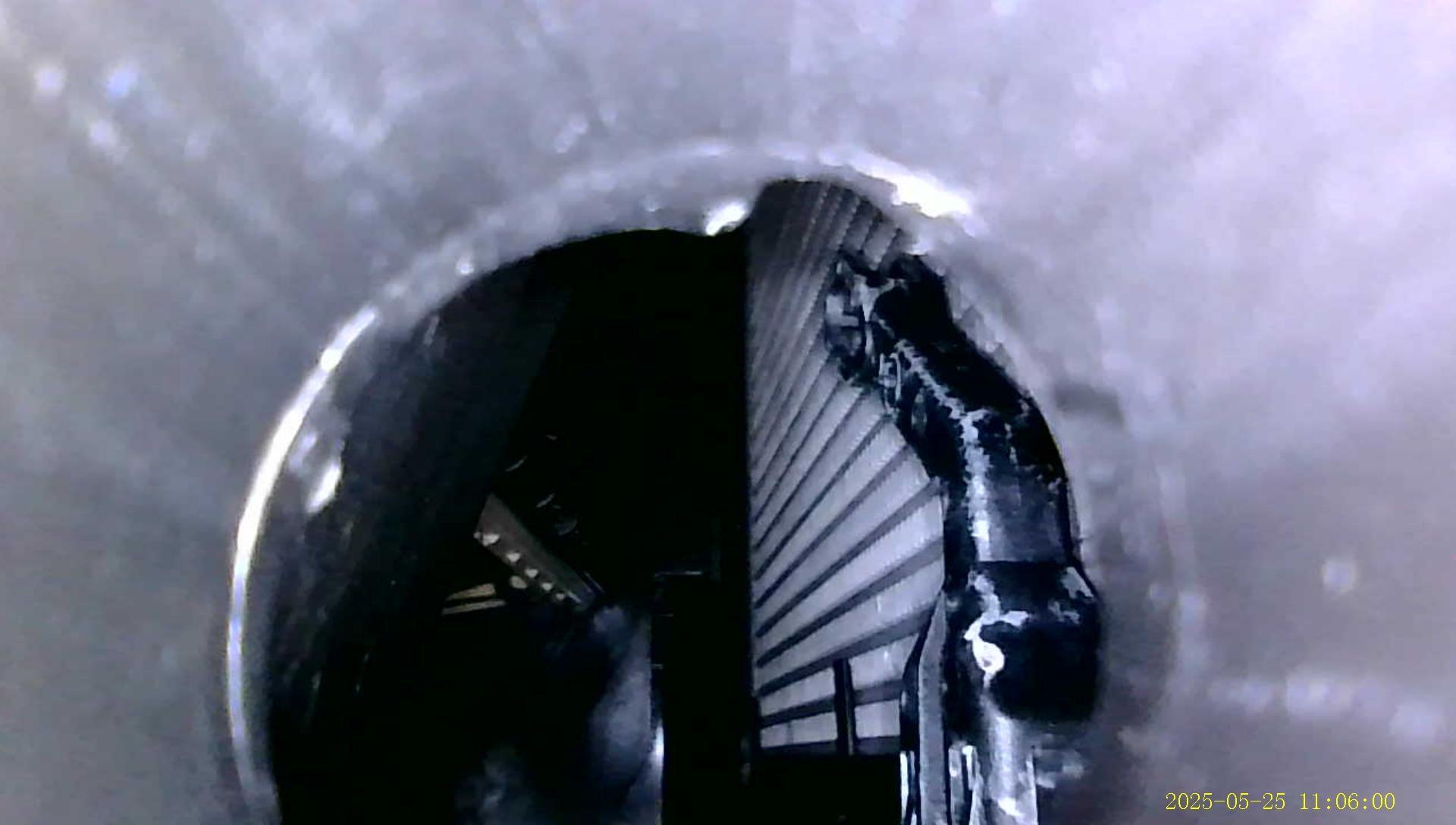

TESLONG BOROSCOPE, 360 degree spinning type. Twin camera.

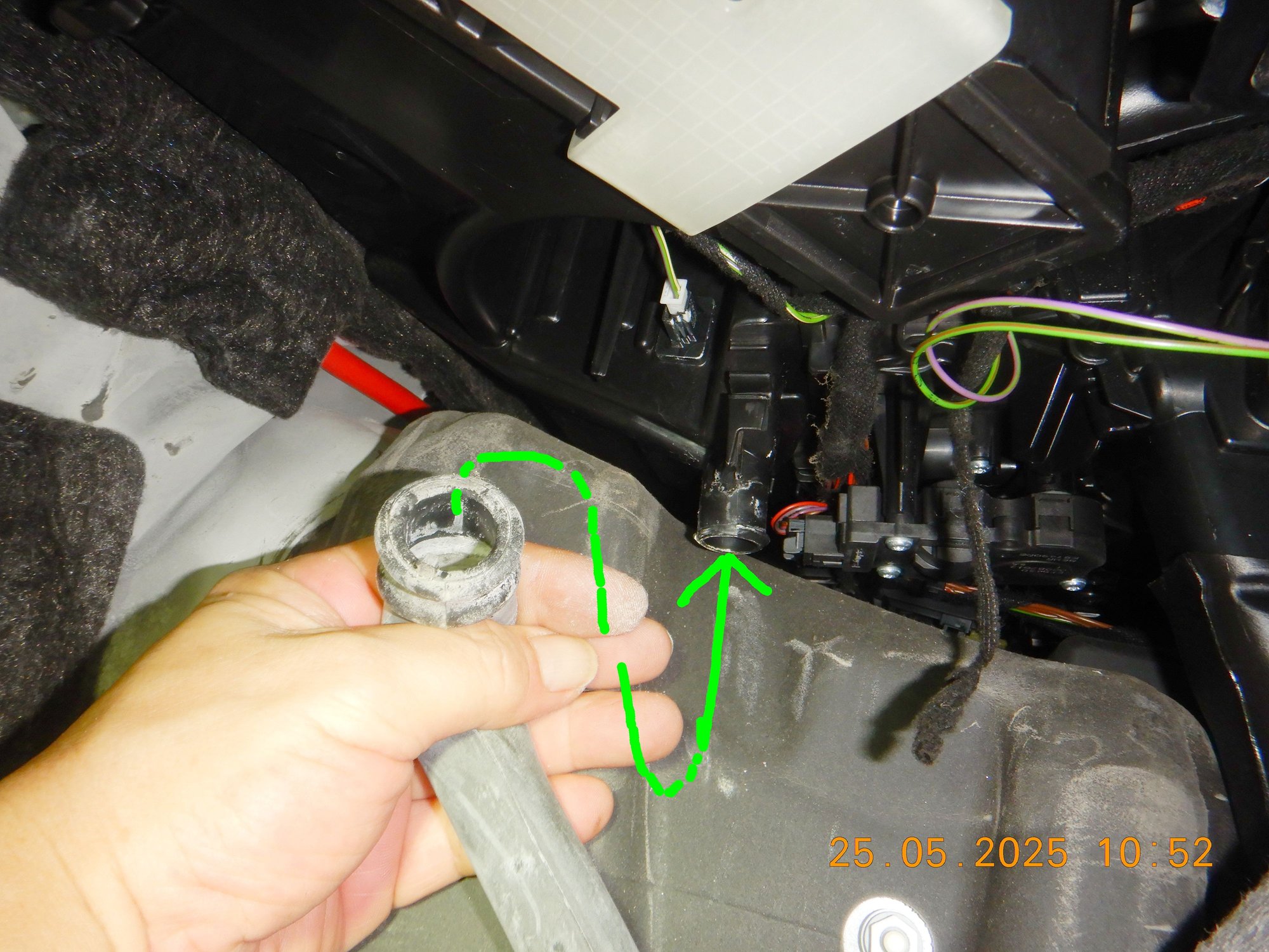

The following photos are taken from LEFT SIDE condensate pipe/hose outlet
Twin Camera mode
Twin camera mode
Twin camera mode
All boroscope images below are single camera mode..........
Blackie plastic thingy is EVAP TEMPERATURE sensor
Evap Temp Sensor visual
Borrowed from : https://mbworld.org/forums/e-class-w...ml#post3371070
-------------- back to my EVAP..........
Whitish stuff at bottom would be aluminum oxide.
That is how ALU oxidize....
Okey dokey, EVAP is still very clean.

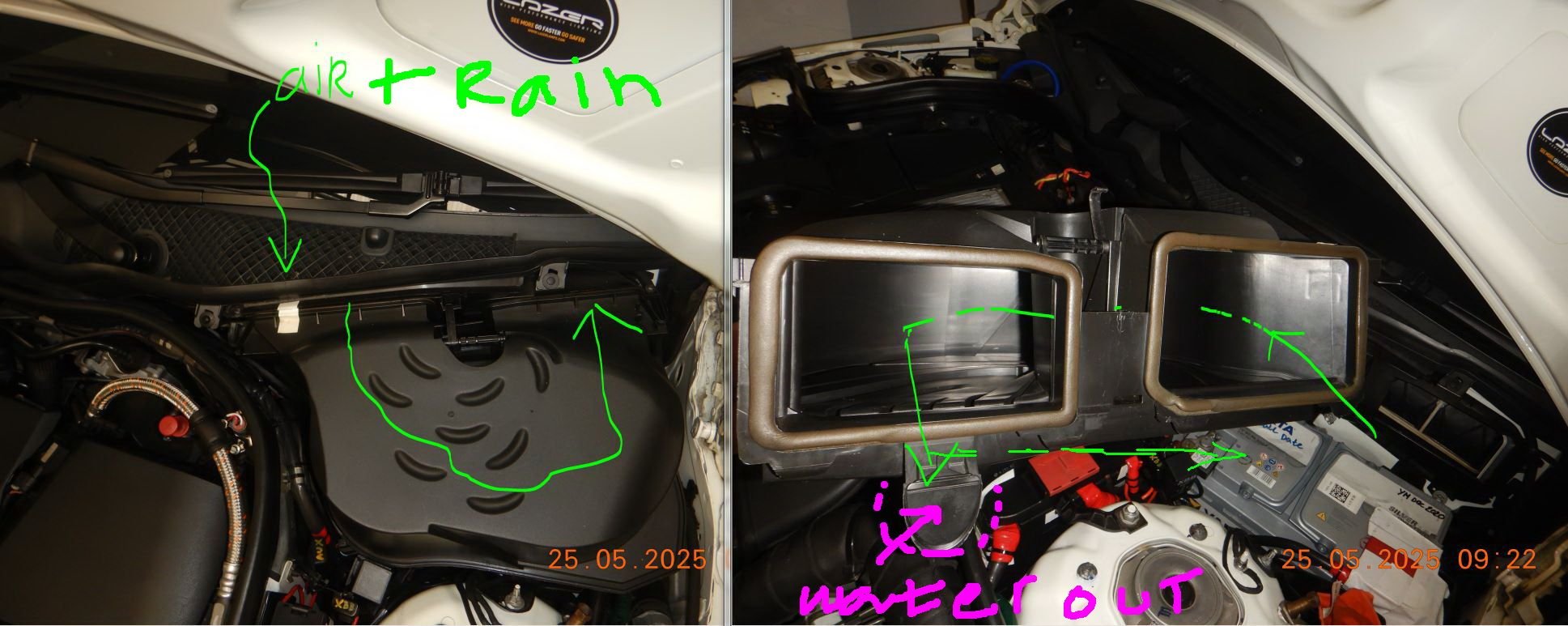

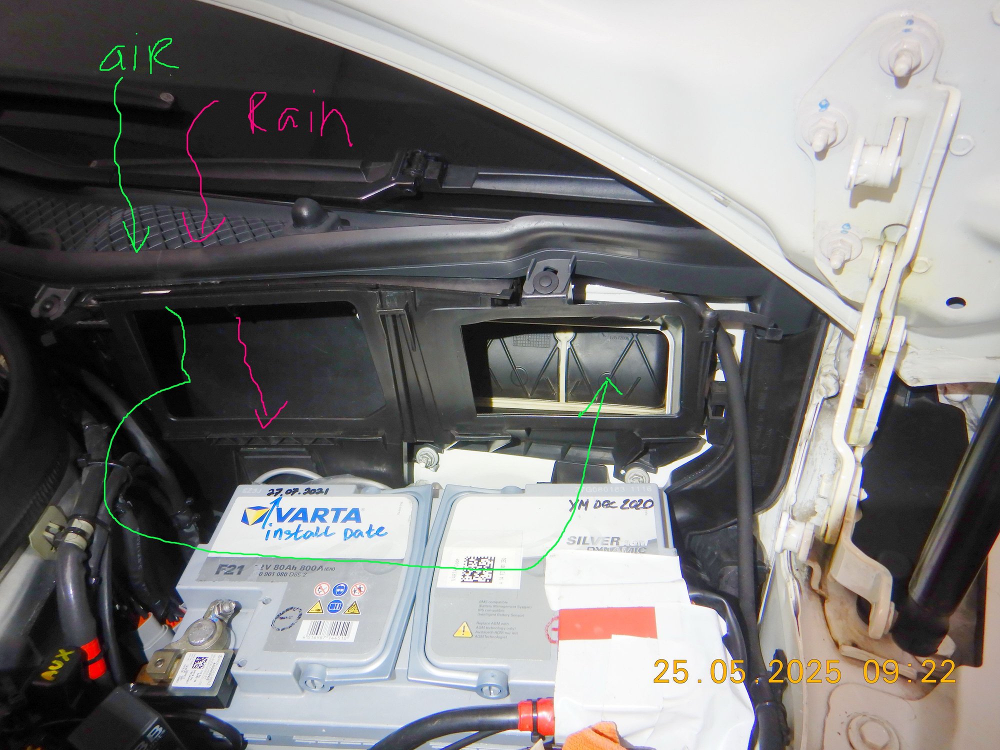

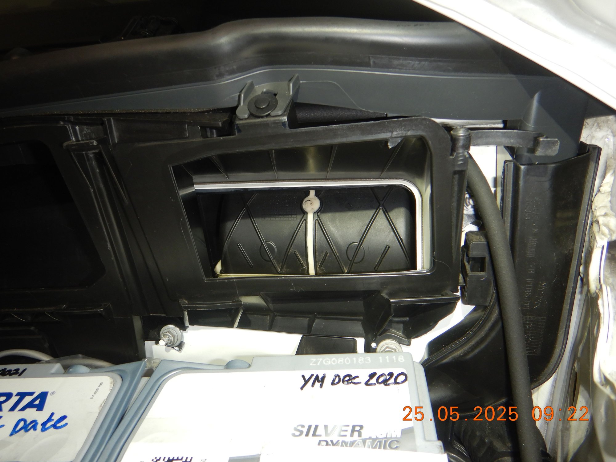

For those who does not know the actual air flow and how rain water is separated. My car is Right Hand Drive

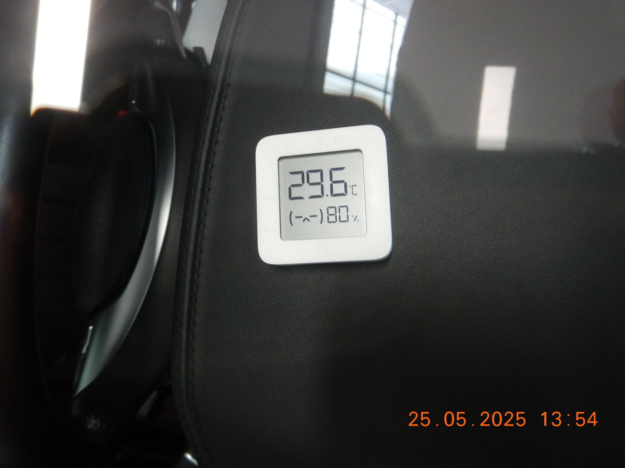

Open door too long to work and humidity inside the car is now equal outside air...dugghhh.
DEHUMIDIFY the car again...........

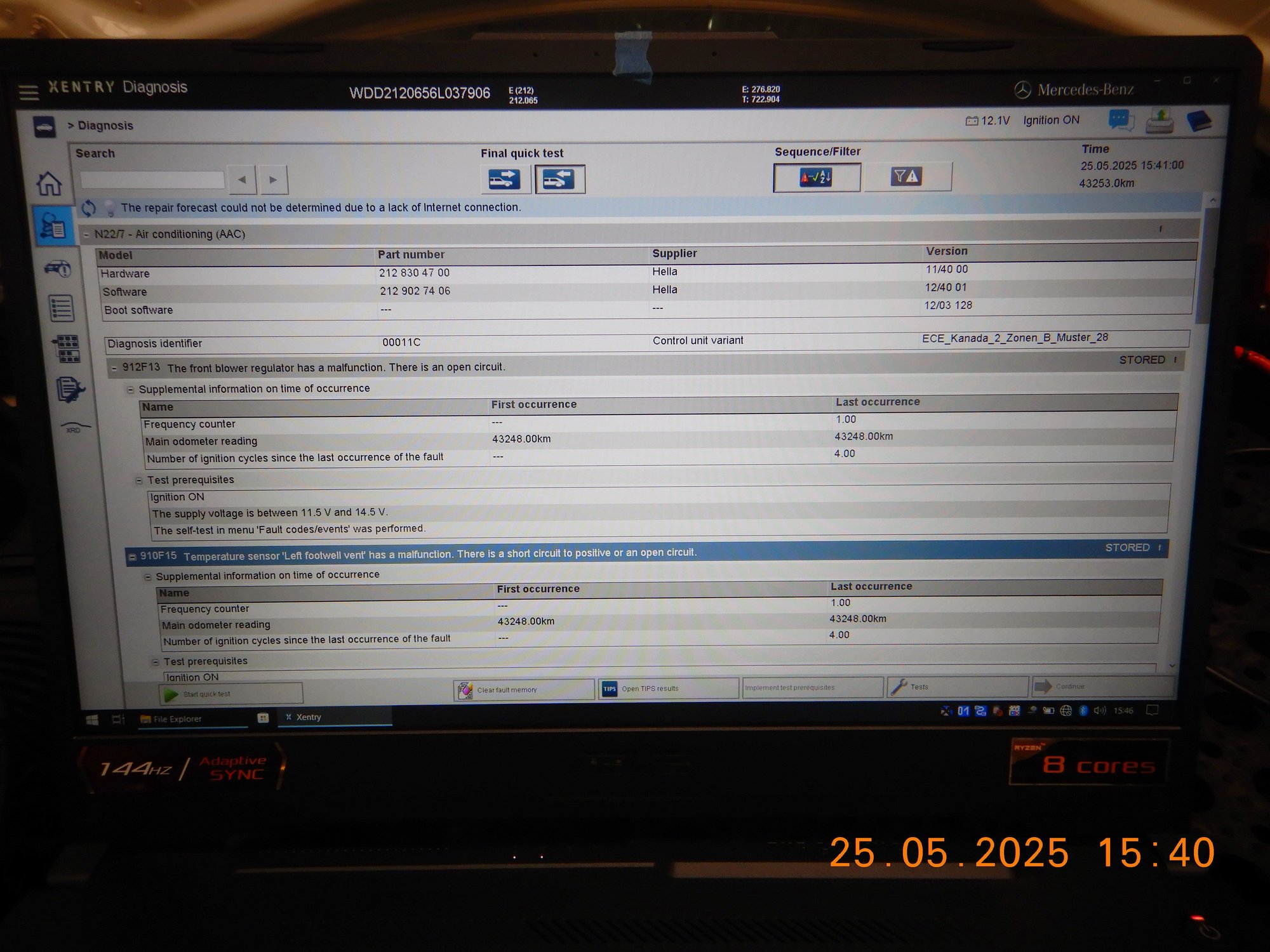

Remove all stored DTC because I removed footwell light, temp sensor and blower.
WAS
https://cimg4.ibsrv.net/gimg/www.mbw...6cd7d5f0d5.jpg
https://cimg6.ibsrv.net/gimg/www.mbw...e184cde76b.jpg
https://cimg7.ibsrv.net/gimg/www.mbw...2406da901a.jpg

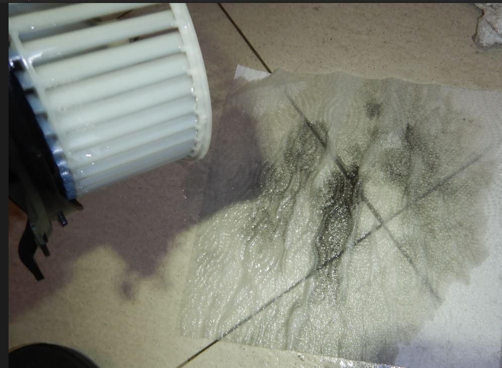

https://cimg4.ibsrv.net/gimg/www.mbw...c29b579cf6.jpg
https://cimg5.ibsrv.net/gimg/www.mbw...f3b997da69.jpg
https://cimg7.ibsrv.net/gimg/www.mbw...0d2f5819ee.jpg
https://cimg1.ibsrv.net/gimg/www.mbw...26ace3699d.jpg
I can't clean the inner-opposite bowl/cup for sure
https://cimg0.ibsrv.net/gimg/www.mbw...15575d433e.jpg
https://cimg1.ibsrv.net/gimg/www.mbw...1ae1eb5262.jpg
https://cimg3.ibsrv.net/gimg/www.mbw...25803a842b.jpg

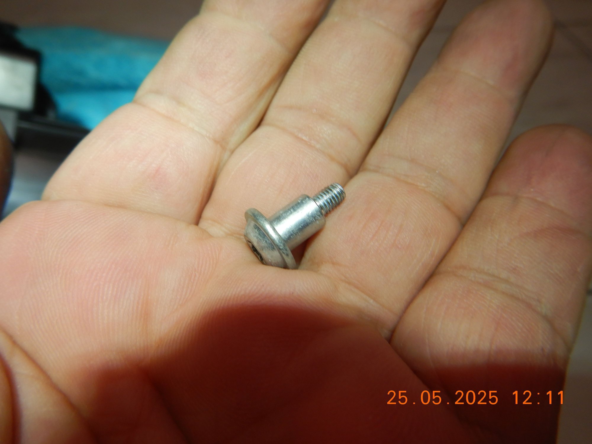

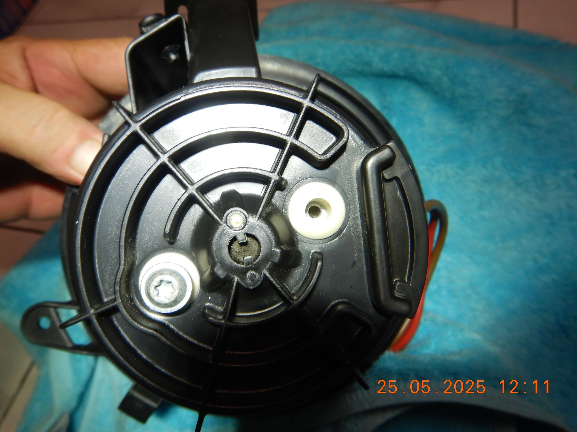

Tried to unscrew the motor, but it was not easy to slide out, so cancel plan.
https://cimg6.ibsrv.net/gimg/www.mbw...c8be542d46.jpg
https://cimg7.ibsrv.net/gimg/www.mbw...63cf0afe0b.jpg

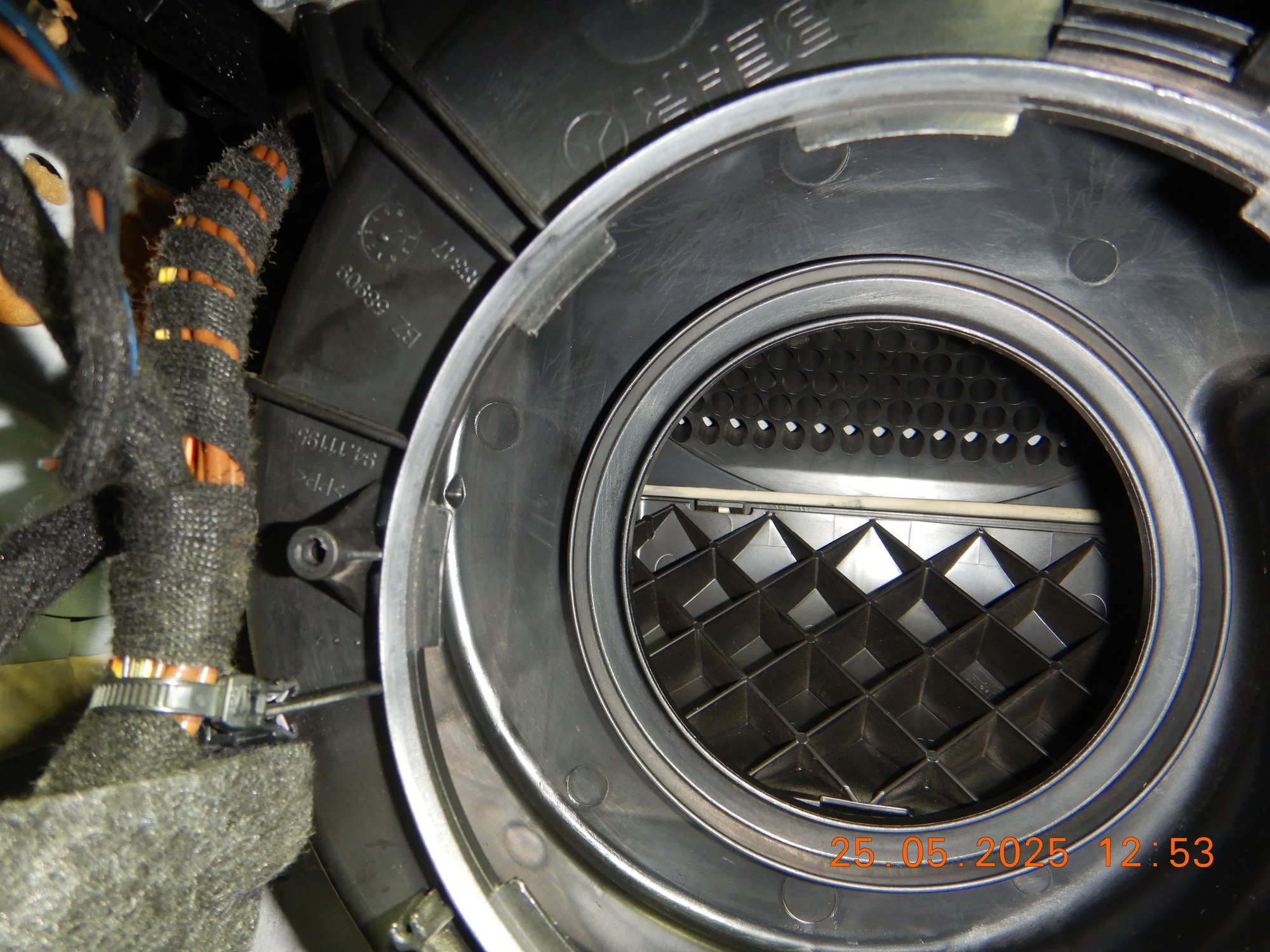

https://cimg9.ibsrv.net/gimg/www.mbw...9c6fecfa64.jpg

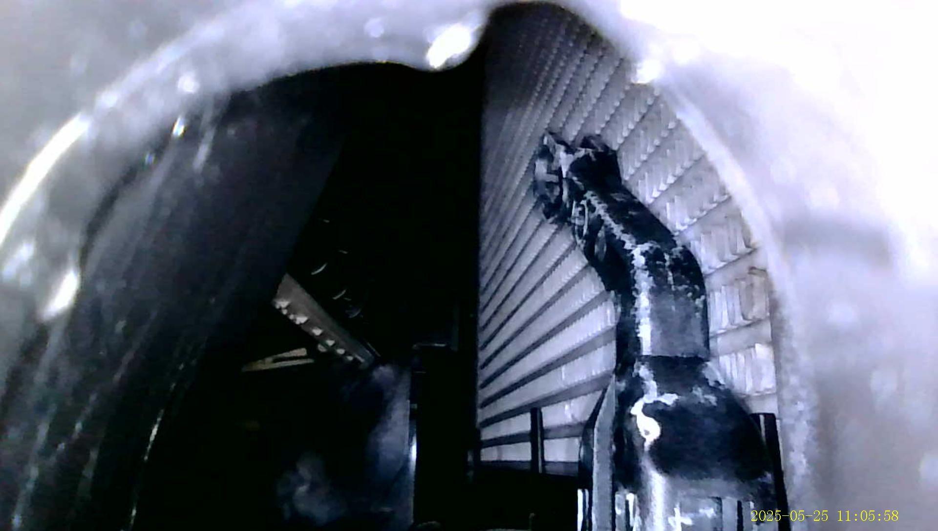

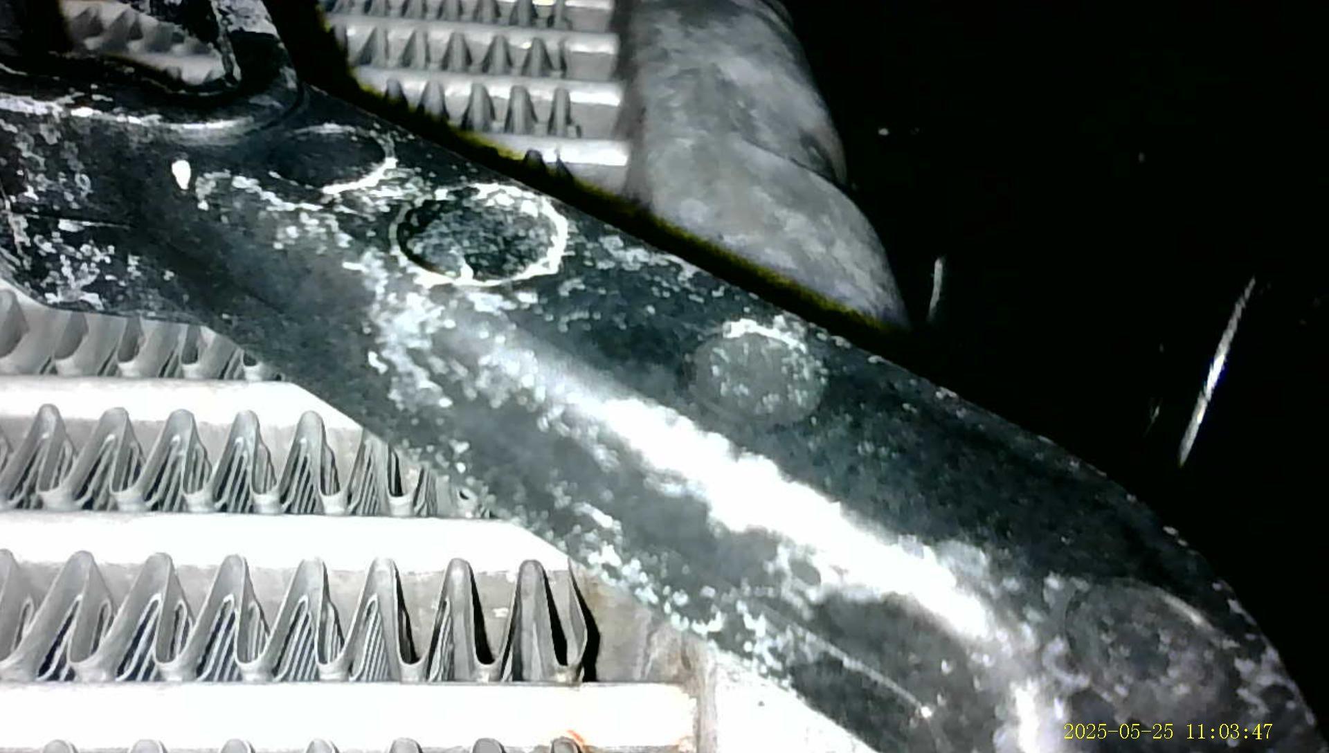

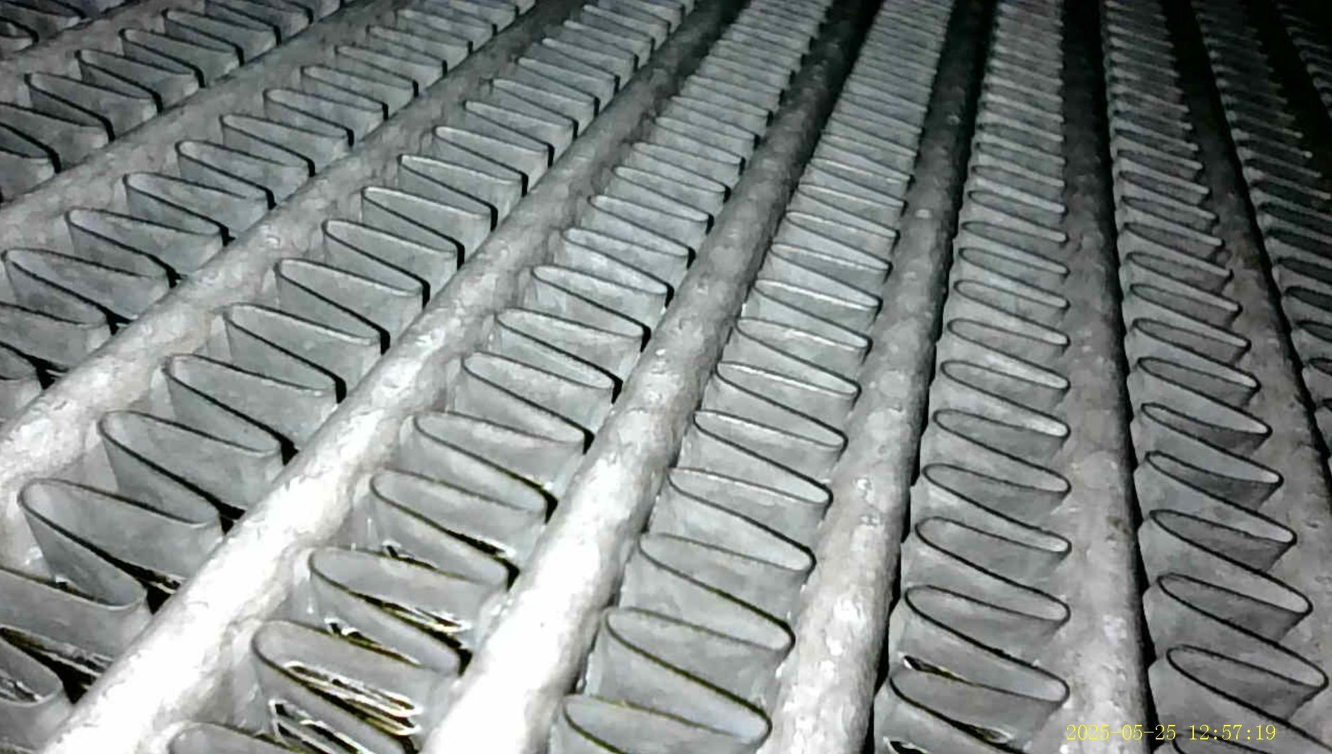

https://cimg7.ibsrv.net/gimg/www.mbw...3a85d307c8.jpg
Twin Camera mode
https://cimg8.ibsrv.net/gimg/www.mbw...035fb43a7e.jpg
Twin camera mode
https://cimg9.ibsrv.net/gimg/www.mbw...d2bb17992a.jpg
Twin camera mode
https://cimg1.ibsrv.net/gimg/www.mbw...e3b7984ee8.jpg
https://cimg1.ibsrv.net/gimg/www.mbw...16ea63ef3e.jpg
https://cimg2.ibsrv.net/gimg/www.mbw...730db8f17e.jpg
https://cimg3.ibsrv.net/gimg/www.mbw...9fdb537cb0.jpg

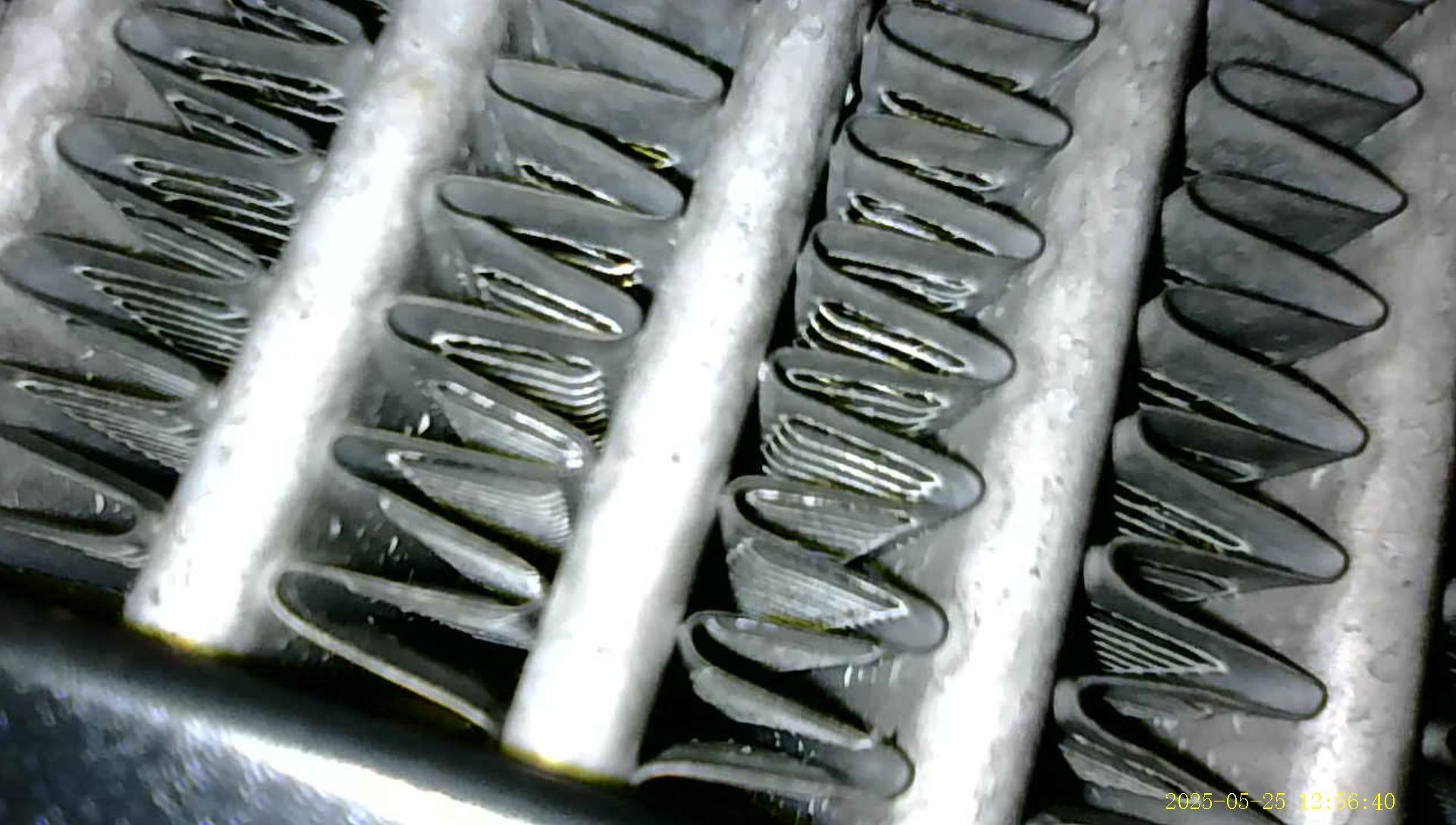

https://cimg2.ibsrv.net/gimg/www.mbw...7aaf46af8c.jpg

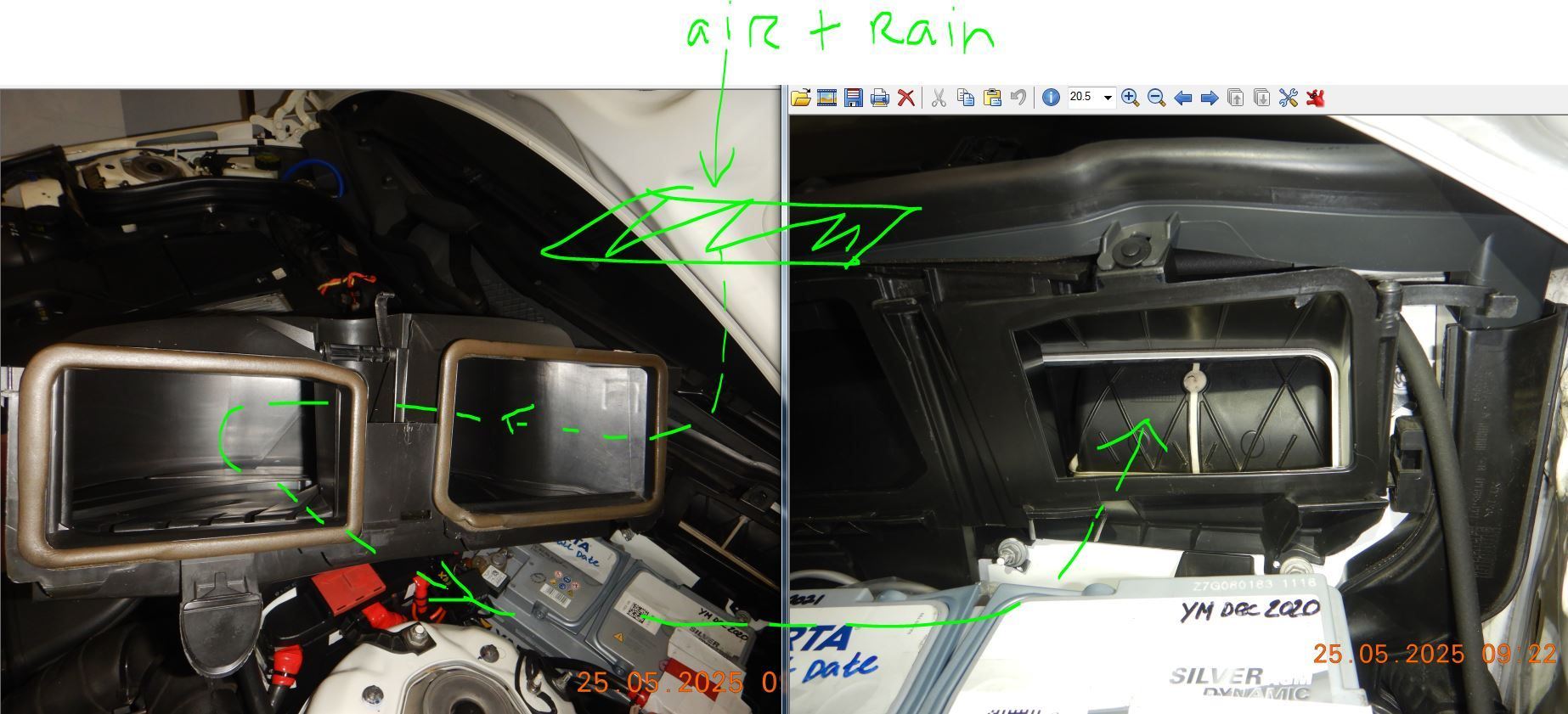

https://cimg3.ibsrv.net/gimg/www.mbw...d2395b21c0.jpg
https://cimg0.ibsrv.net/gimg/www.mbw...39f2cd388f.jpg
https://cimg2.ibsrv.net/gimg/www.mbw...4261307498.jpg

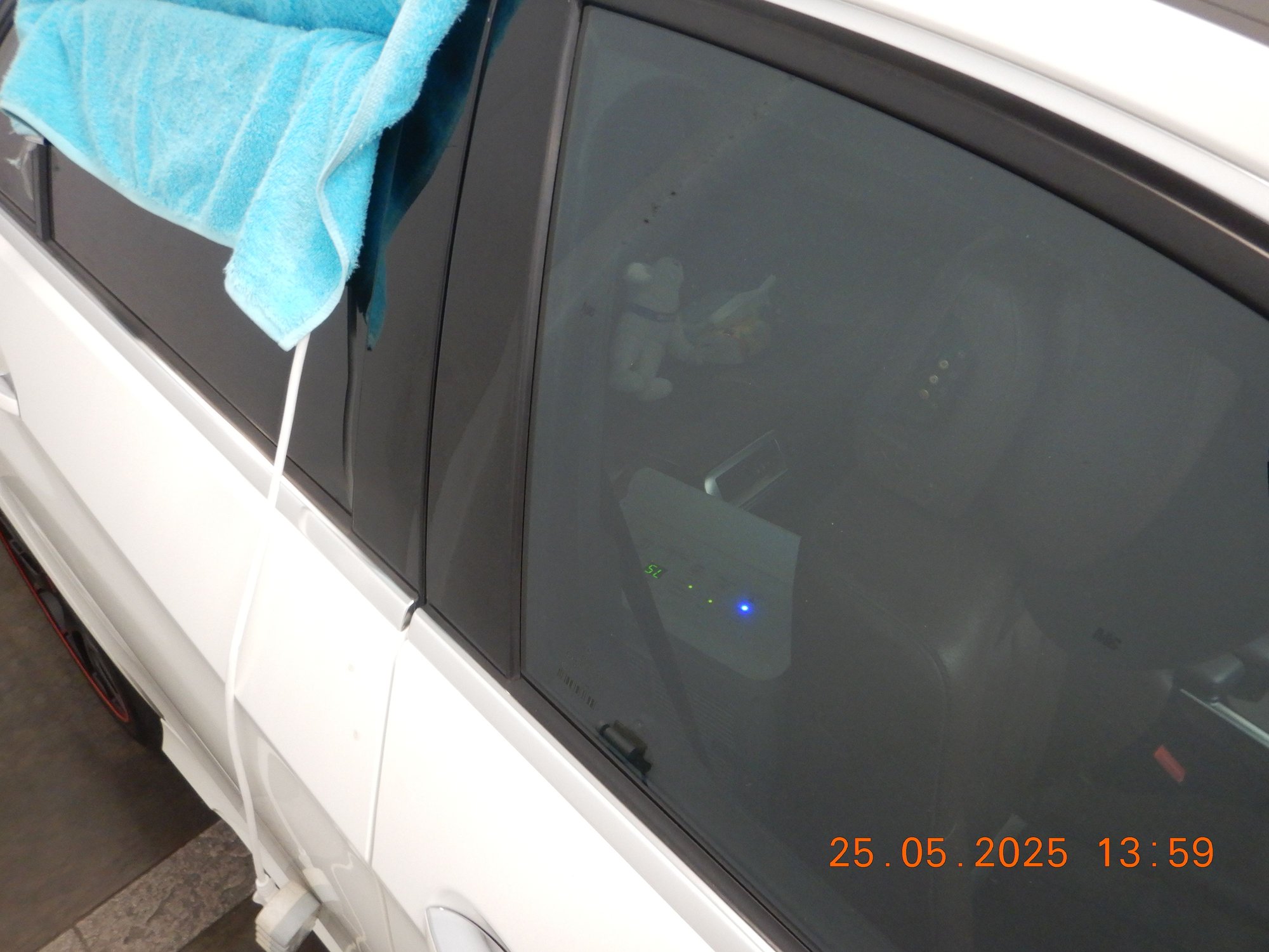

https://cimg4.ibsrv.net/gimg/www.mbw...89e21401c8.jpg
https://cimg7.ibsrv.net/gimg/www.mbw...60b6a33468.jpg
https://cimg1.ibsrv.net/gimg/www.mbw...7085f7b265.jpg
