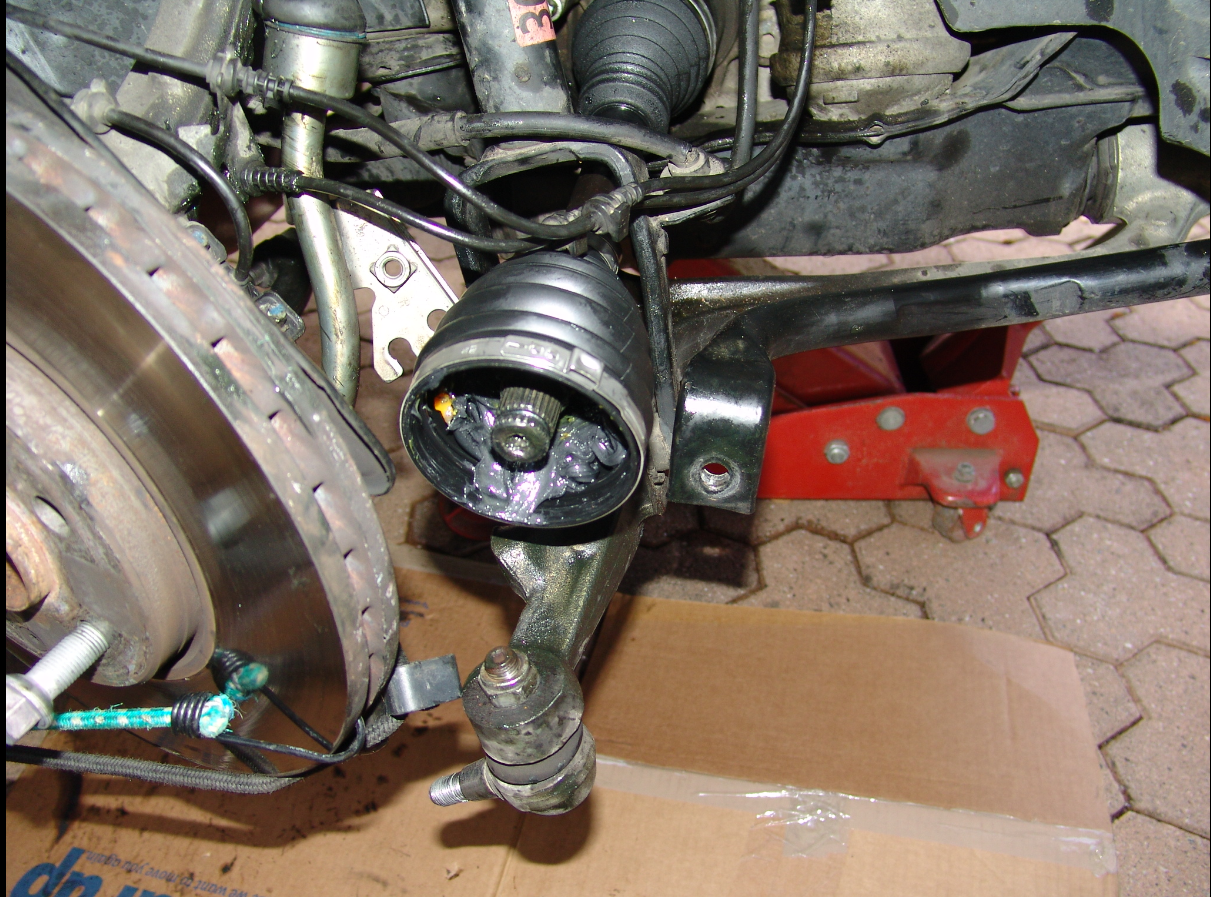

Its too late now but i'll add if the joint in the cv axle still seems fine, no clicking noises, and the boot was just torn and leaking grease it is possible to replace the outter boot with the axle still in the car. One of my outter boots has a tiny pin hole in it, I think from dropping the strut down on it when I was replacing them, and plan on doing the boot replacement while still in the car. Heres a photo of someone doing it on a W211:
