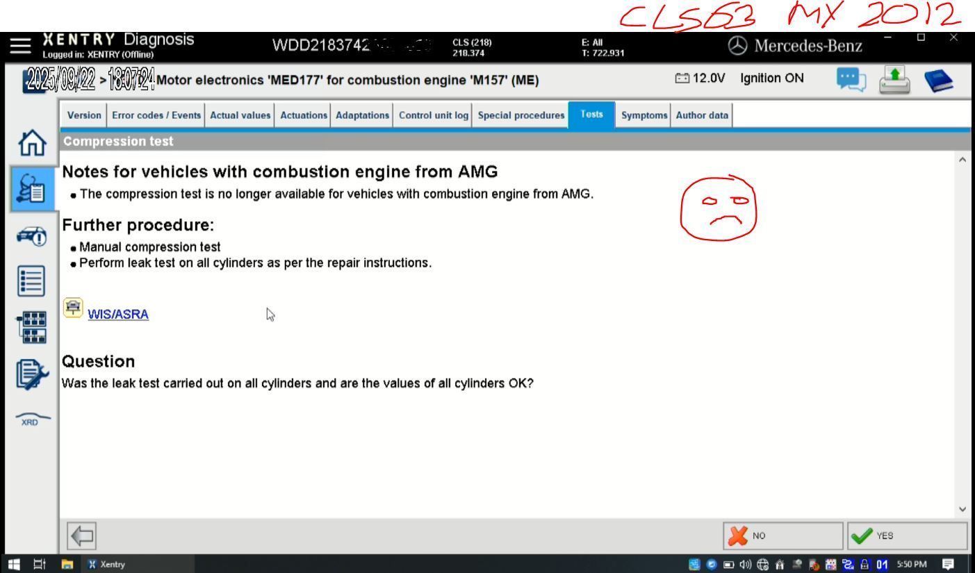

For M157, Xentry does not allow Compression Test feature . Xentry compression test is actually similar to Relative Compression test, but with piston speed data, instead of
battery current data for those doing Relative Compression test
So u need to unplug all 8 injector wires...duggghh and clear up DTC after the test. Damn.
